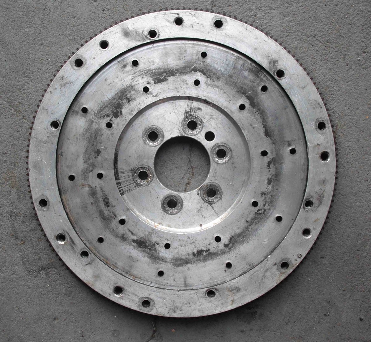

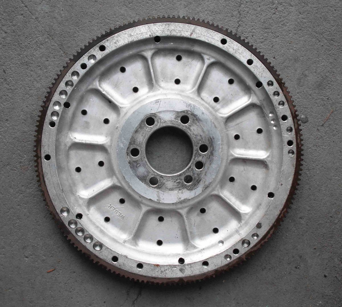

    I decided to give it a good cleaning and really appraise what I have here. I think this is forged, Bruce concurs...

    Could be a casting, will take some up close and personal examination to tell for sure George, so send it to me and I'll check it out real close!

  10. Looks forged to me....

    It does to me too, but I am not 100% certain. If it is cast, its one of the nicest, cleanest, densest looking castings I have seen.
  12. If that's cast, I would have to say it's die-cast and there's no 'circles' from the vents/fill points you would expect to see. The back looks very similar to the Schiefer forged aluminum flywheel I had on a FE....

    I was thinking exactly the same thing, you can see the marks on the mating flange where it's been "working" against the back of the crank.

    That is a forged flywheel. Spot face the bolt holes lightly and use the dowel pin.

    Spotfacing the bolt holes is good. I would definitely clean up that surface front and back. I'd be comfortable with a front washer to cover all six holes and increasing to 1/2-20 in the crank holes and good fitting clearance holes in the flywheel. The clamp force between the flanges is what's supposed to keep it in place.
    The balancing drilling on the back is odd to me. Too many holes, why would they be in a pattern to divide sort of in thirds?
    I agree with Jimmy six that a good front damper will go a long way to prevent vibrations that might tend to loosen things up.

    Those "circles" on die cast parts are not from the fill points or vents, those are from the ends of the ejector pins.

    I am pretty comfortable at this point that its forged, it looks identical to the flywheel in the second ad. I plan to put a new insert in it and run it.
