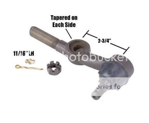

    Modern variety... if I was to heat and bend within 2 inches of a tie rod end, is there anything inside that is susceptible to excessive heat ?
    I have a double eye tie rod end that I have been told is only available in one variety, and it is the wrong variety, so I would like the bend in it the other way or at least a bit straighter.
    Never happy about putting heat anywhere near steering components.........

    With most tie rod ends, the ball end of the tie rod end rides on a nylon cup. That nylon won't like heat. The brown part in the pic below is the nylon cup.

    This is the problem... 28 AV8 RHD ( Australia) .
    4 inch drop I beam, 48 split bones, want to put the tie rod under the bones.
    This tie rod end has the taper from both sides.
    Want to put the nut on top, tie rod end at bottom for best clearance under bones.
    I can see this double tie rod end suits being on the right hand side LHD under OR being on the left hand side on top RHD.
    I actually need the kink in it the other way but have been told they only make this one.
    I may be able to get away with it if was straight (er) .
    With the kink going forward, it looks all wrong, and it IS wrong and putting more, maybe excessive angle on the drag link which goes backwards slightly to pitman arm, AND the kink being forward hits the bottom perch/bone casting on full left lock .
    If I had a mirror reverse of this, it would be perfect.

    Didn't they make those for the RHD version of what ever car it originally came from?
  12. X38
    Joined: Feb 27, 2005
    Posts: 17,498
    X38
    I don't understand. Plenty of people in AU have built AV8's without that tie rod end. Why are you even wanting to use it?
  13. 97
    Joined: May 18, 2005
    Posts: 1,983
    97
    I think this is the part number for the same thing for a postal jeep( right hand drive jeep CJ8)
    Should be a mirror image of the one you have
    J0918257
    http://www.crownautomotive.net/
  14. pooch2
    Joined: Jun 5, 2012
    Posts: 109
    pooch2
    from Australia
    Thanks, I guess the jeep has front steering so this one is the same as I have .
    Looks like I need J0920536 , opposite side and rear ford steering.
  15. fordor41
    Joined: Jul 2, 2008
    Posts: 1,020
    fordor41
    I installed my tie rod as you want to do 20 yrs ago(reverse taper) and have had no problems. You can buy a taper reamer from speedway that will taper from the top if that makes you feel more comfortable.
