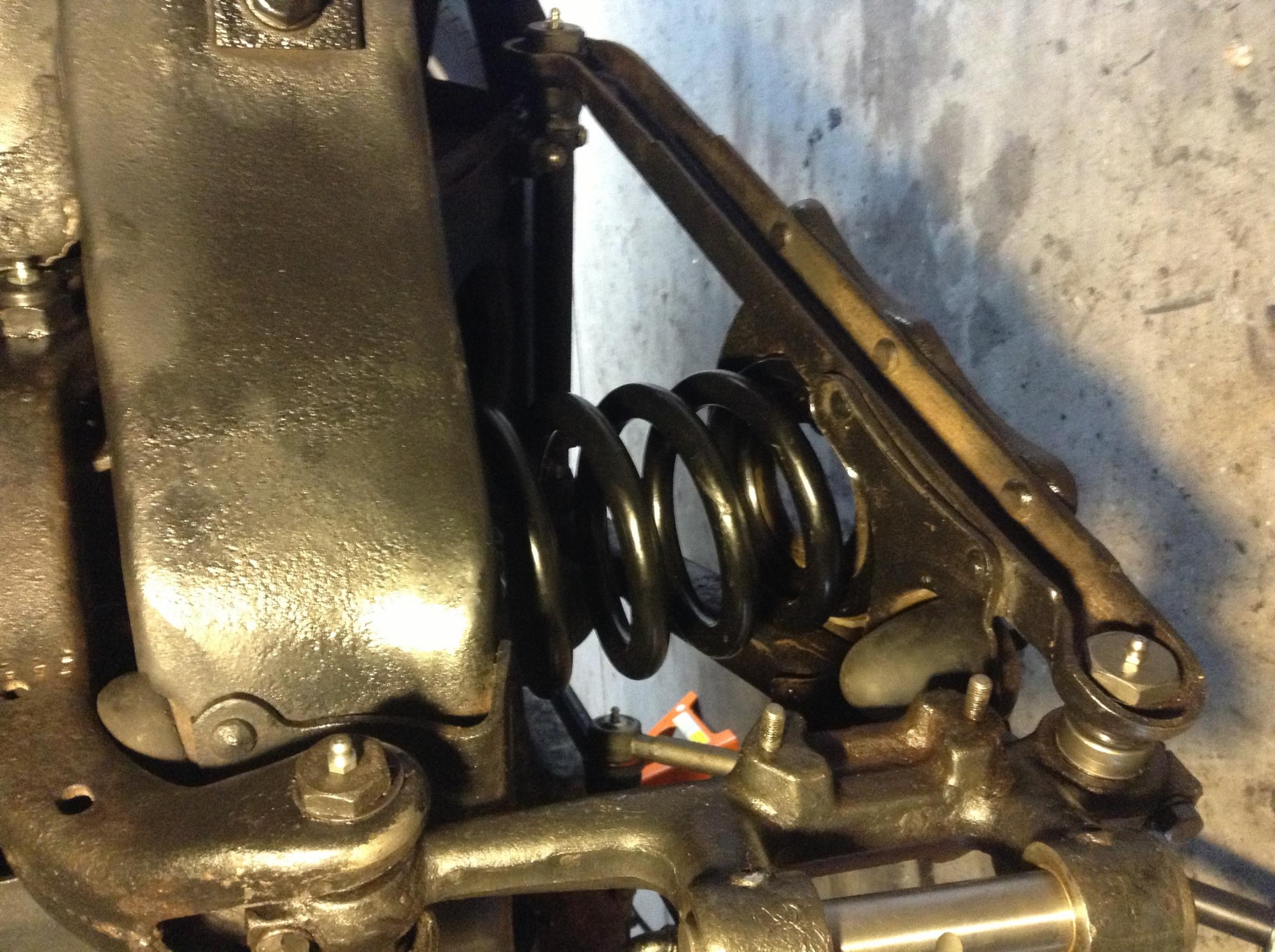

    Been working on the suspension/steering rebuild for my 1951 Mercury little by little: new front spring coils, shocks, centerlink, tierods both inner and outer, idler arm and King pin
    The suspension is A arm and so far pretty good. As for the king pin set, dont have or want to buy a reemer tool ect. Ive called a couple auto/machinist shops in my area (Whittier, CA) BUT so far no one is set up for that type of work anymore...
    Can anyone point me to a shop where I can take my spindles and a new king pin set and have installed? Any leads would help.

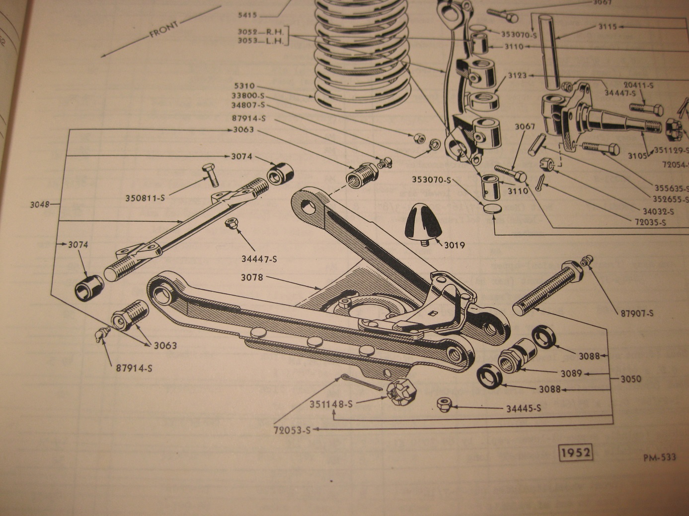

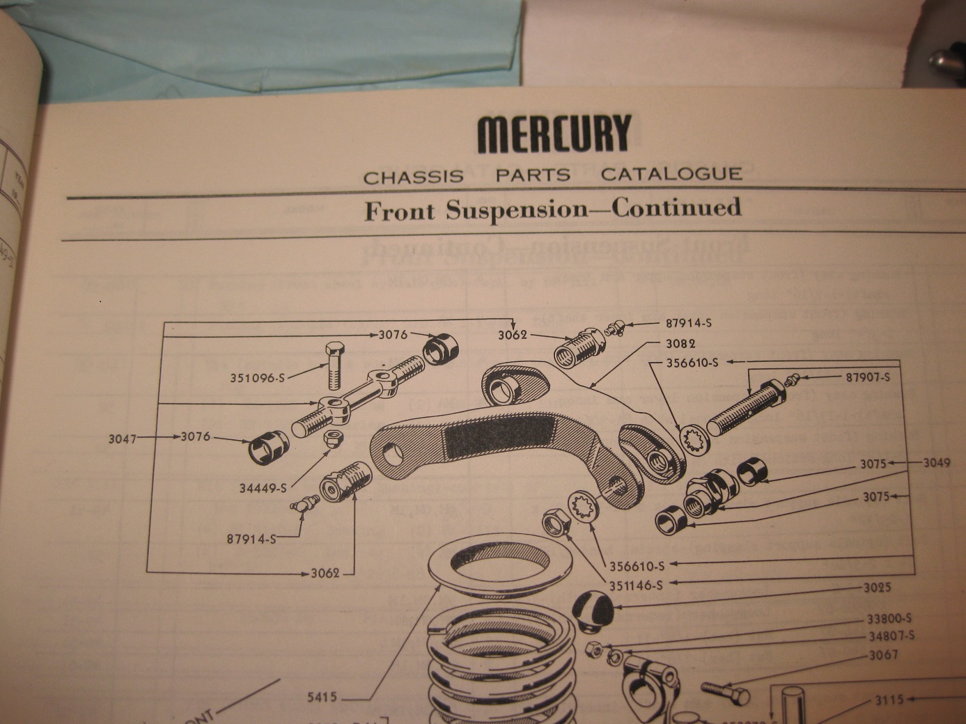

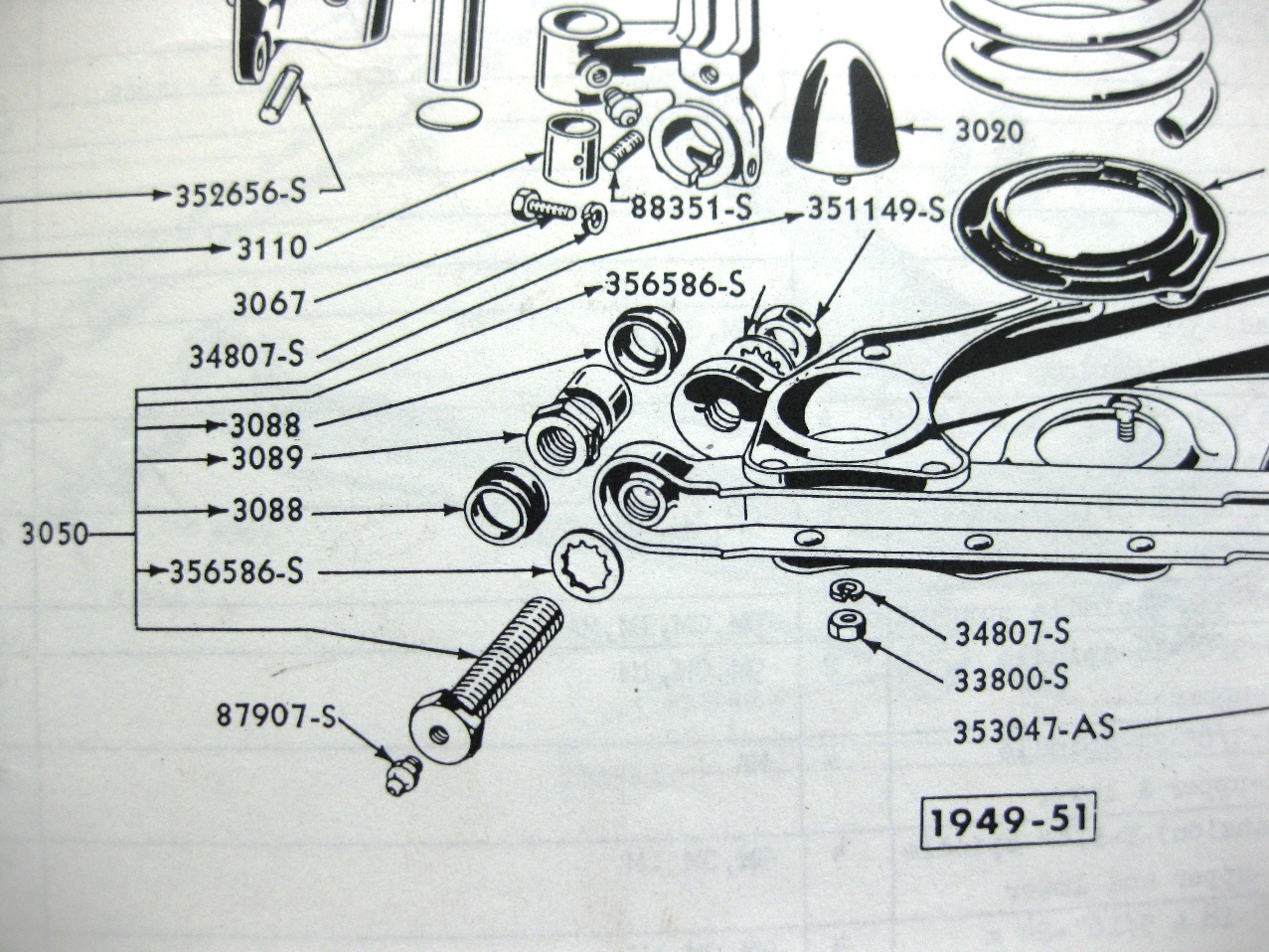

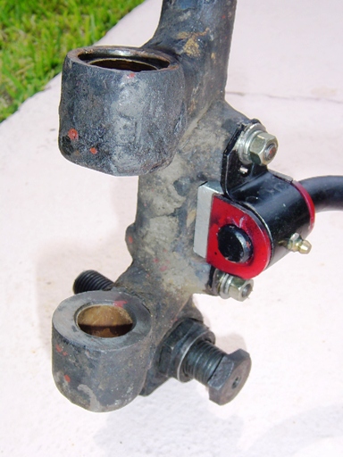

    Unfortunately 49-51 Mercs have both control arms and king pins. The part called the "upright" thru which the king pin goes is on the right. The spindle fits between the two bushings you see.
  7. kursplat
    Joined: Apr 22, 2013
    Posts: 295
    kursplat
    thanks for the detail drawing 19Fordy. i've never messed with one of these and have a couple questions if dangulo doesn't mind me drifting his thread...are the pin and holes tappered? are you replacing the bushings too, or does everything get reamed out to use an oversize pin? or, can you get new, stock sized bushings and pins, and just replace em'?

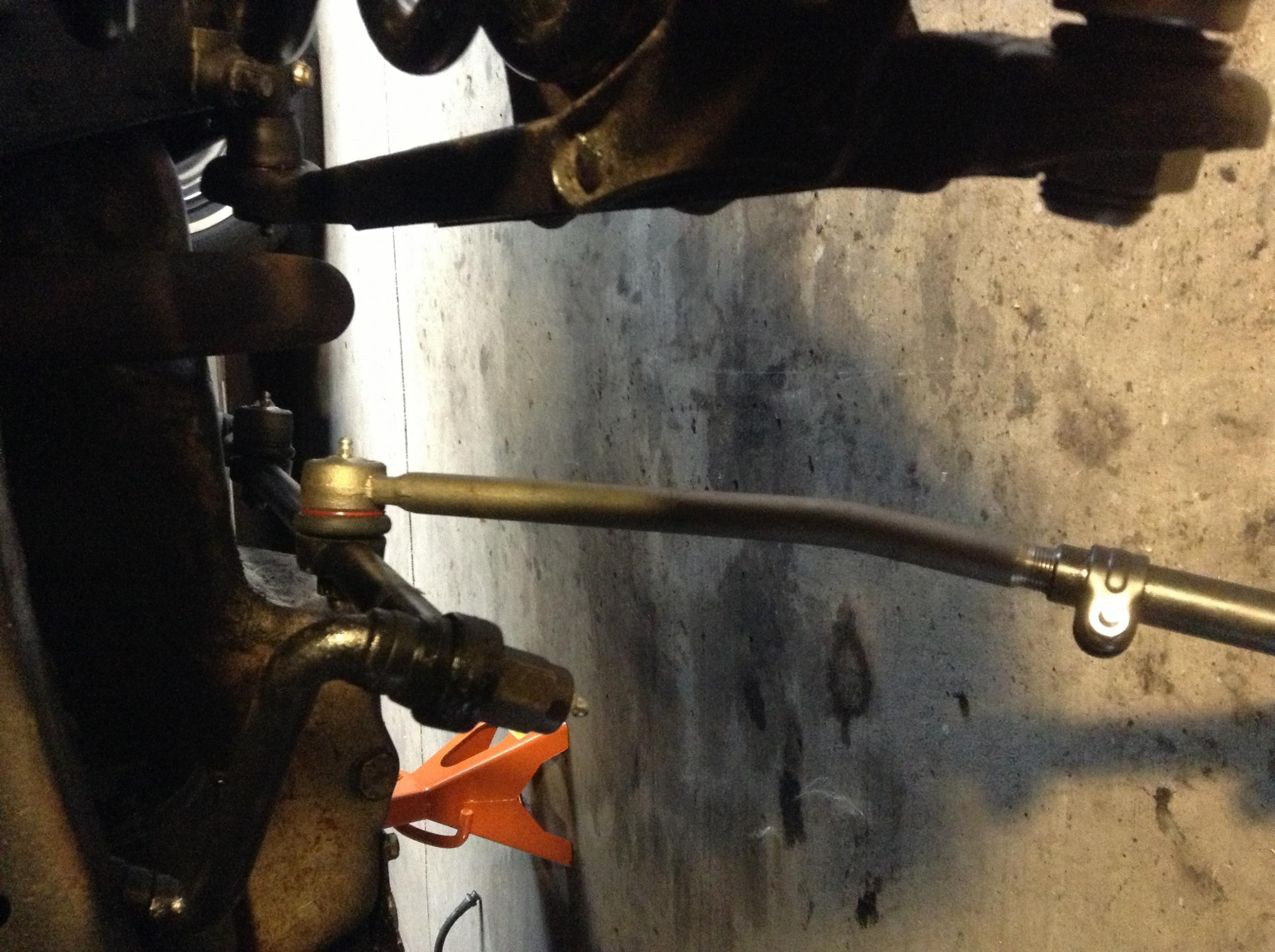

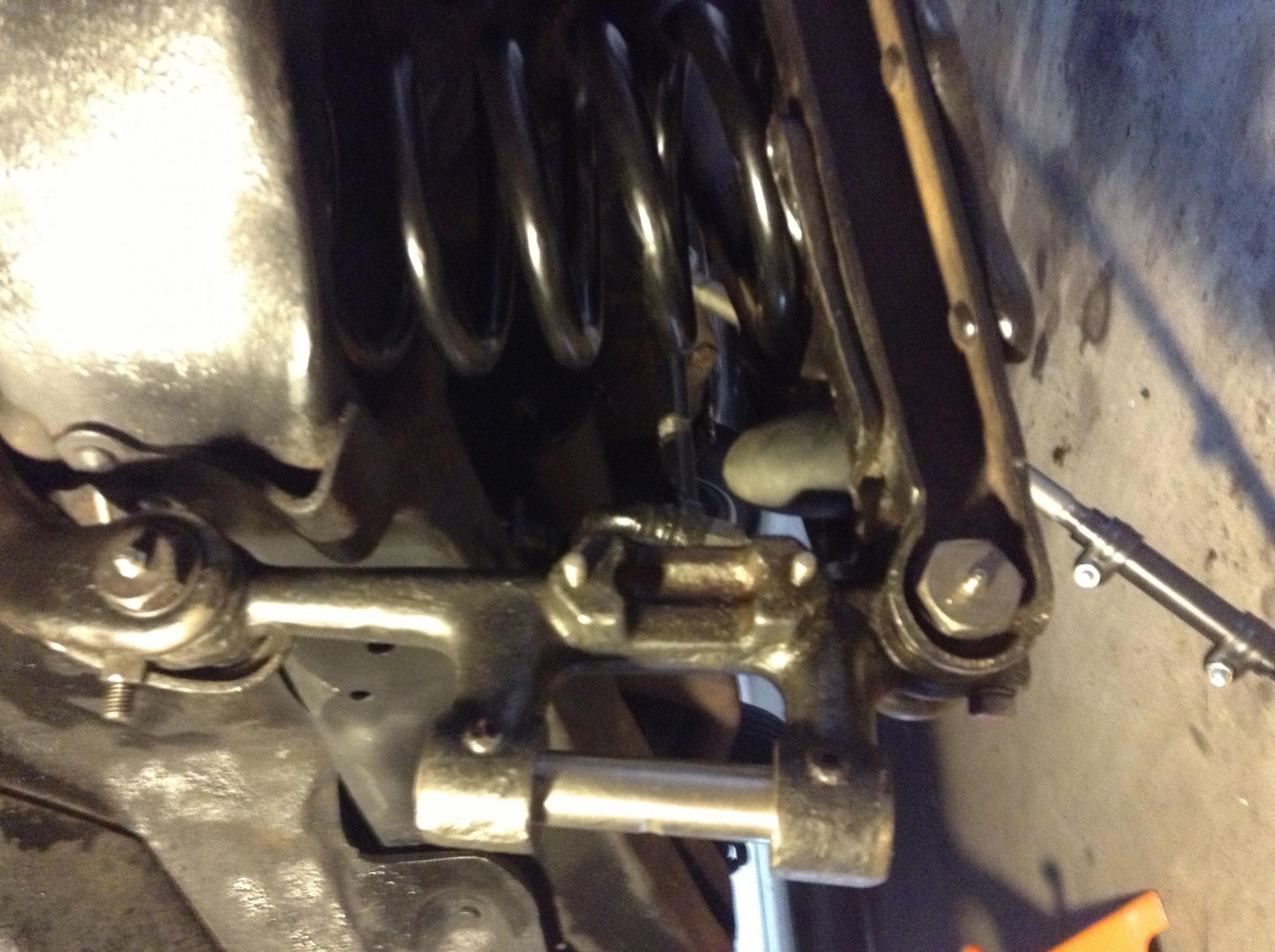

    Here are a couple of pics before I removed sping coils.
    The bushings are first installed in the uprights so that the grease fitting holes line up with the grease fitting. This compresses the bushing making the ID smaller. The bushings are then reamed to provide a "slip fit" with "zero play" for the king pins. I had mine done at a NAPA store. Hand reaming is not the best method to use to get the best fit. It is not possible to just install new bushings and have the kingpins just "drop in" and fit properly. The bushings have to be aligned when honed to fit the king pins. New king pins will be "stock size" and then the bushings are always reamed to fit the king pins. Otherwise you won't obtain a proper sliding fit with "zero" play..
    Since you have your front suspension apart, it might be a good idea to also install new upper and lower control arm bushings, pins and rubber seals. It's quite a bit of work but well worth the effort if your suspension is worn out with plenty of "play." It's something you want to do only once since you have the front end apart already. Take plenty of photos and write notes to detail exactly how everything fits together. Make sure you get copies of the books in the photos. They give detailed instructions on how to disassemble and reassemble the Merc suspension.

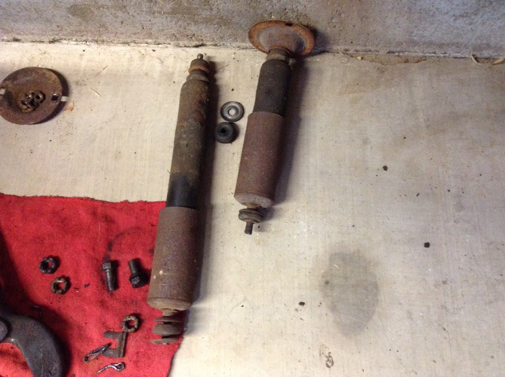

    Quick update with my front-end rebuild project. Finally had some time to focus on the Mercury today. Over the last several months its been continuous cleaning and scraping off a thick 3"'s build up of gunk and oil after 60+years on this ole girl.... Did what I could while I saved enough to buy all the suspension/steering parts need for the full rebuild. In the meaning time, sanded and painted sections of the front end frame to clean her up.
    I was able to install the upper/lower control arm shafts/bushings, lower control arm bumpers, and new springs. The kingpins were honed at a local machine shop. Here are some pics of where and what it looks like right now.

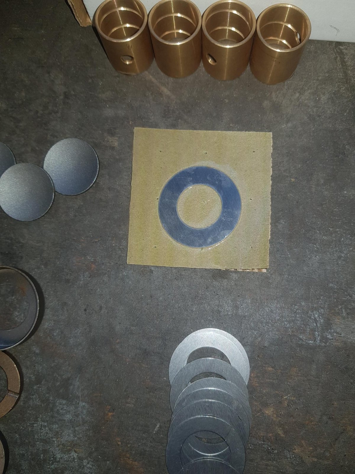

    I would like to install the king pin set, but I can't handle all the washers, can someone tell me where they are installed.

    1954 Ford suspension parts are not interchangeable with 1949-51 Merc. Merc parts are larger in size. Here's a good thread.50 mercury front suspension? | The H.A.M.B. (jalopyjournal.com)
    Your shim question is answered here. Hot Rods - 1950 Mercury Spindle Shims | The H.A.M.B. (jalopyjournal.com)Shim are used to take out slack between the spindle and the vertical upright. The kit has a selection of shims of varying thickness so that you can select the ones you need. You don't use all of them. Only install the shims you need to reduce vertical "looseness" of fit between spindle pin bushing and upright. You may find that you don't need any shims. Here is an excellent thread that explains and shows the shim install.
    King Pin Shims 1950 Merc - The Ford Barn (READ EVERY WORD CAREFULLY.)
    Here are some photos that will help in assembling 49-51 Merc suspension.
    You have to have the patience of a toothache, so take it slow and take photos.
    Be sure to buy the manuals shown below. They are a HUGE help.
    I have some of the rubber pieces if you need them and I'll do some searching.
