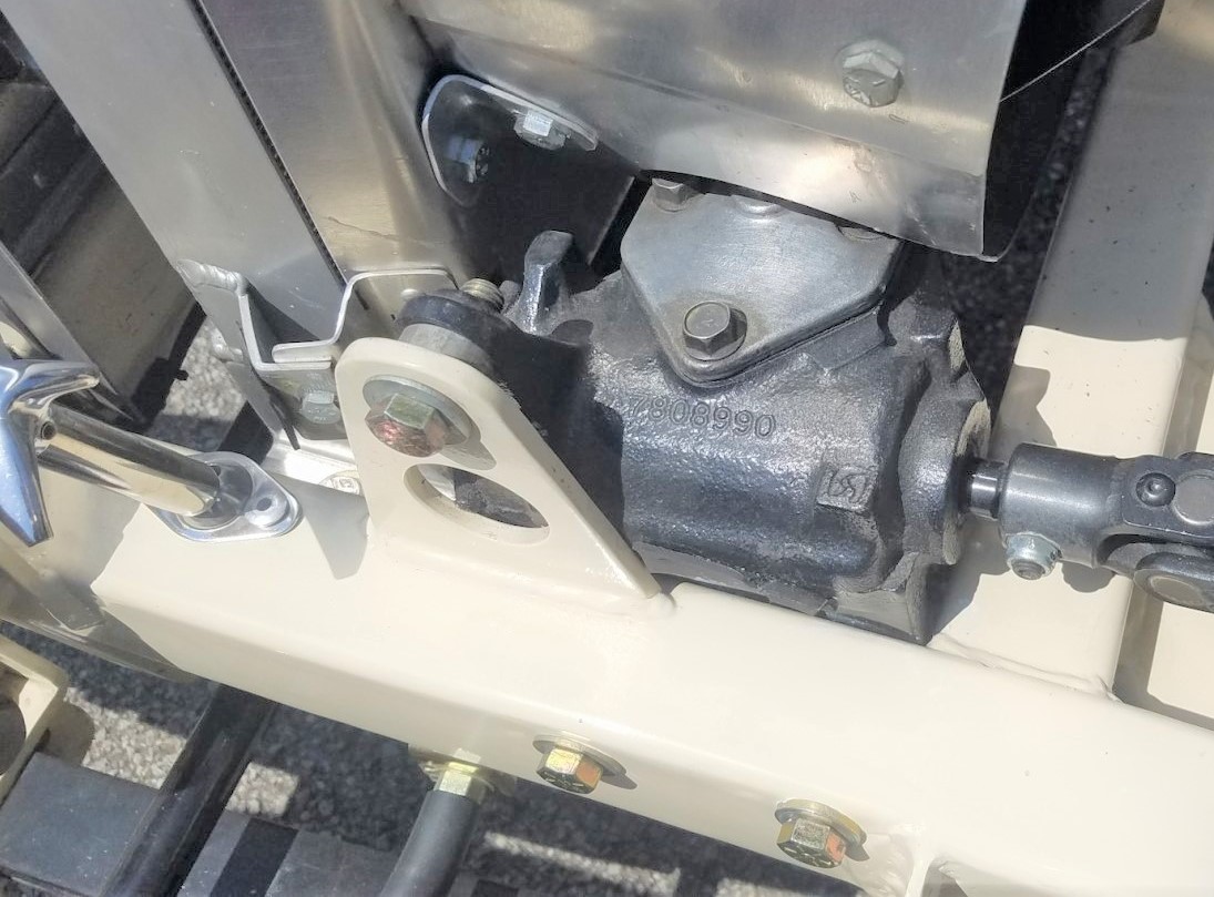

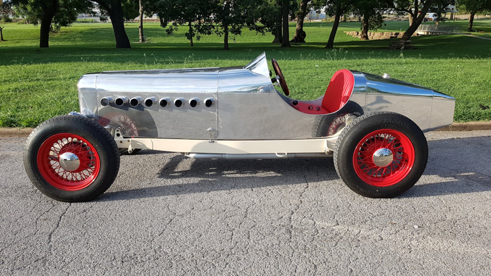

    I designed and fabricated a 1930's style race car and it needs a steering upgrade. It drives and handles great, but the steering response is too slow. It's got a Vega steering box that's tight and in great condition. Steering input needs to be about double what it is.
    The best way to upgrade it is by installing a Steering Quickener like a Howe Racing 5225. I've never used a quickener and don't know if it's a good idea for use on a street car. The car weighs around 1300lbs and the steering is very light, like its got power steering.
    Would it be a good idea to add a quickener? Is Howe a good brand for quickeners?

    With the Vega box having a ratio of 22 to 1, I used a 525 Borgeson box with a 16 to 1 ratio in my Model A. We use the Howe quickeners in the Bonneville cars, installed backwards to slow the steering down. IMG_9728.JPG IMG_9729.JPG
    gimpyshotrods and jimmy six like this.
  8. 31Apickup
    Joined: Nov 8, 2005
    Posts: 3,637
    31Apickup
    The 525 box will bolt to the same mount as the Vega box. The 525 is a bit bigger and different size shaft.

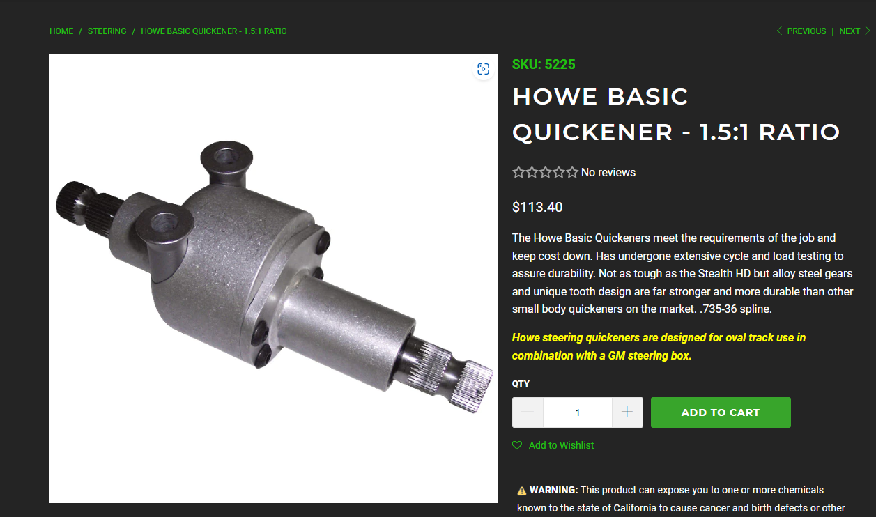

  14. Mr48chev
    Joined: Dec 28, 2007
    Posts: 36,020
    Mr48chev
    You are correct, the gears inside the Howe box do the job quite similar to a torque multiplier wrench. HOWE BASIC QUICKENER - 1.5:1 RATIO - Howe Racing Enterprises, Inc
    WalkerMD and Budget36 like this.
