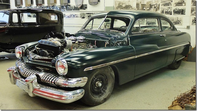

Projects Installed a nailhead in my 51 Merc coupe today

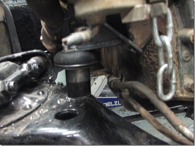

    Nice work on your brackets. Do you have a picture of what your motor mounts look like? where they custom?
  2. Very nice work on the merc and a good looking stable of deuces in your killer shop. Love those Buick motors...

    L !cid_40A6CE7B364546F296E0B47F9E67E4E8@StimacPC.jpg !cid_AB5BE32F00A34951A754C15A86EDA470@StimacPC.jpg !cid_FBE11EED4B7747C4B5AD016BCFEB8519@StimacPC.jpg !cid_5AB72CA93DFC4ED2A20CE40BBE1BA77A@StimacPC.jpg !cid_5AB72CA93DFC4ED2A20CE40BBE1BA77A@StimacPC.jpg ocated and cut a hole just behind the stock Merc holes, chassis engeneering mounts on the block, two thick wall tubes, one inside of the other to secure the stock bisquit, and have wide stability for the motor. All welded inside,bottom of both, and outside as you can see.

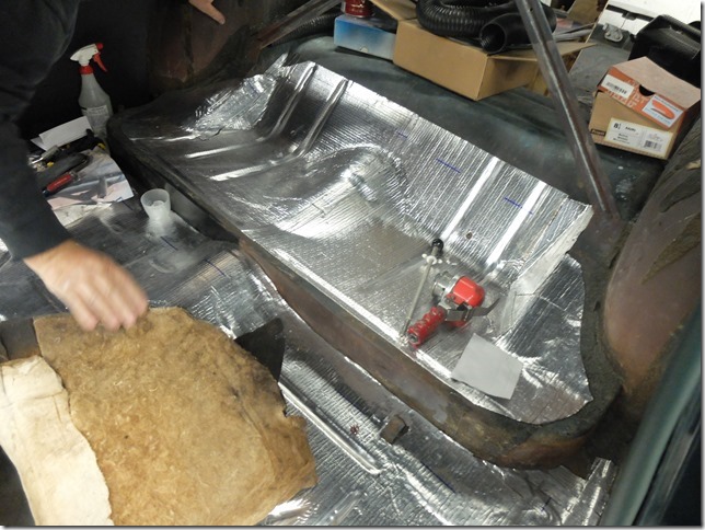

    Winding down, outside is finished, working on the interior now. 1st door panel !cid_755E0A752E9742F5B708469179E409E7@StimacPC.jpg !cid_6EFBC09D13274D01969C8D013420ED78@StimacPC.jpg

    More interior progress !cid_D468C29A231547BC9AB00FE86201D167@StimacPC.jpg !cid_D7081C9748AE42289876991F7B3B35B6@StimacPC.jpg
