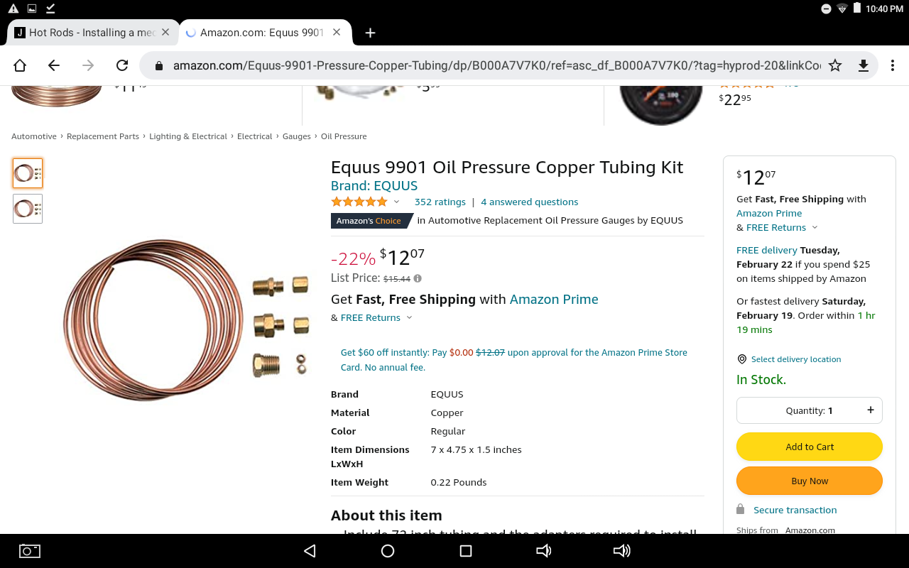

    @pprather , Yes, thanks, tons of choices there for tubing. I had not googled it as I know it exists, I was just trying to buy it local so I could see what I'm buying. Also, if you buy any of the kits, you get 6'. So, I'll have the same short piece left over that I already have...too short to ever use...too good to throw away, well if you are a hoarder like me. I would like to buy a roll, say 10 or 20 feet. The 50 foot roll, well, not sure I have that much time left on the planet! I just was at McMaster carr looking at fittings, thinking I could get tubing there also (didnt look), but I was stumped at the site. I need a straight, br***, low pressure, adapter, 1/4, female jic/30degree X 1/8" male pipe. Sounds easy enough, but when I get to the adapter section it only allows me to pick one size, then gives the price without allowing me to enter the other end size. I gave up, will call them tomorrow as I can probably buy tubing by the foot, and the fitting too. Or...by the time I pay shipping, maybe just get a hydraulic hose made? I like to make as big a project as possible out of it ya know, keeps me busy! Thanks guys

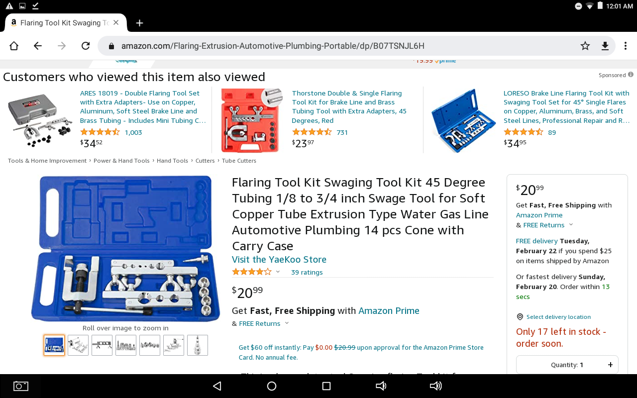

    Screenshot_2022-02-17-00-01-30.png .buy one of these , swage the end & silver solder the 2 left over pieces of tubing together , then you'll have enough for next time !

    I have owned tubing flare tools and benders for 50 years, really, i am not new at this. 1st, none of those tools go down to 1/8" tube. 2nd, as mentioned above "just go get compression fittings available anywhere", well, there are three different kinds of compression fittings. the first, that you find at hardware stores have a half round Ferrel like used in a propane gas line. the second is a wedge shaped ferrel, like used in most of the gauge installation kits, and a third type is used in big truck air lines. So, its not just run down to ace hardware and tell the guy you want an 1/8" ferrel, or the fitting that it fits. Another Option has just occurred to me, that is, my gauge is 1/4" male JIC , I have the nuts and flaring tools, and 1/4" copper tubing here in stock, could be done for free in 10 minutes...but...here I go over thinking again, but I believe the reason they use small ID line is because air compresses, fluid does not. So, if I "use what I got", as in 1/4" line , the gauge would not read accurately...well, at least until its half full of oil, which they eventually do fill up it seems any way. I've had several old big trucks, Diamond T's, Whites, even a 64 needel nose Peterbuilt, and they used a 3/16" tube with standard flare fittings on each end. so.. which way is up?, I' m goin to bed...ponder some more
