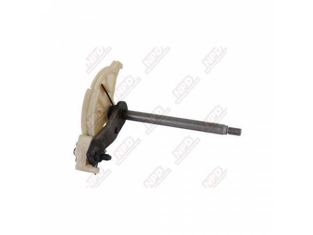

    I see the new firewall piece makes it more adjustable but is there a certain distance the clutch pedal quadrant pivot has to be from the firewall. I am guessing the cable has swedged ends on it. So if it was to close the cable would be to long and if it was further away it would be to short?
    loudbang and HOTRODPRIMER like this.

    I'll take a photo of the cable this afternoon, the quadrant pivots on the same long bolt that holds the clutch pedal and it has to be forward enough as to not touch the firewall.
    There seems to be a lot of adjustment with the firewall piece, the original one had to be adjusted under the car, this is much petty and a lot easier. HRP

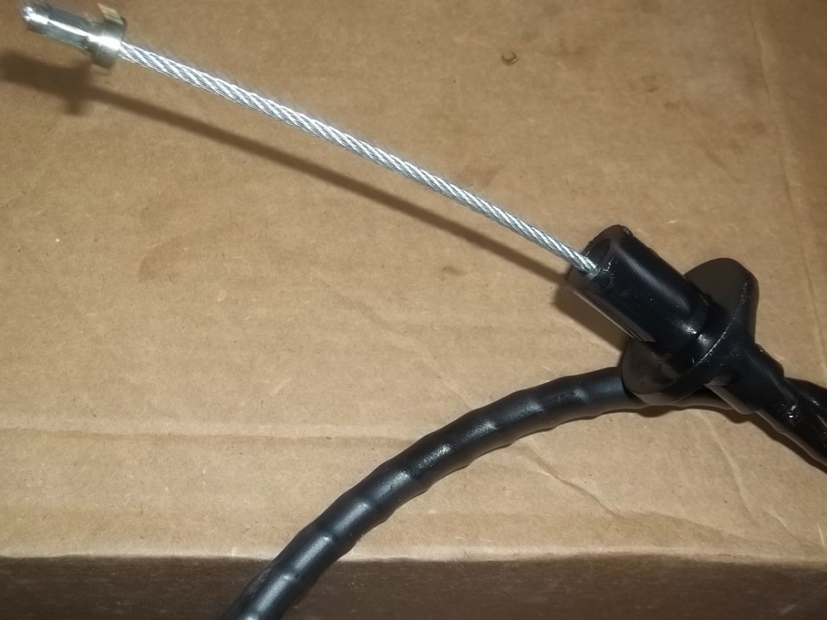

    This is the end of the cable that attaches to the hook on the quadrant inside the car and black plastic piece of the outer sleeve fit's inside the adjuster.

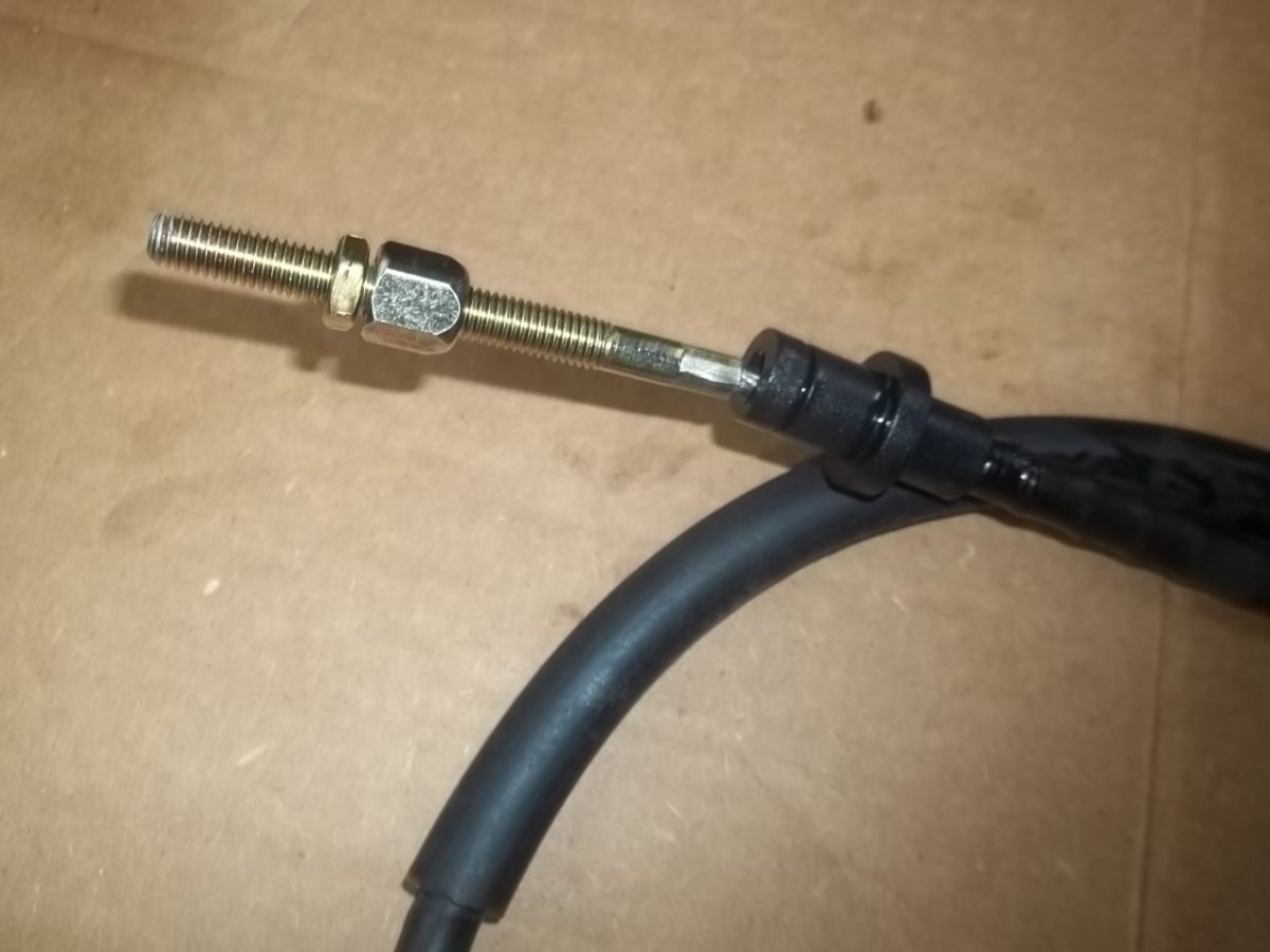

    This end of the cable attaches to the clutch fork, the rounded piece attached to the loop on the side of the transmission and is held in place with a ''C'' clip.
    Side view of how it attaches to the transmission. HRP

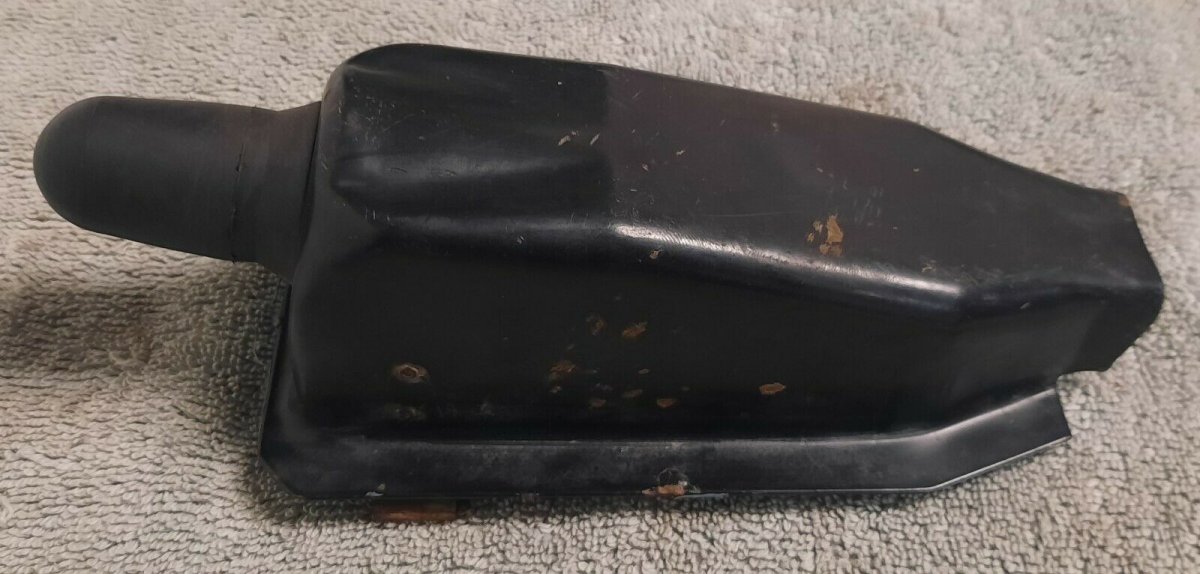

    Cover for the cable.

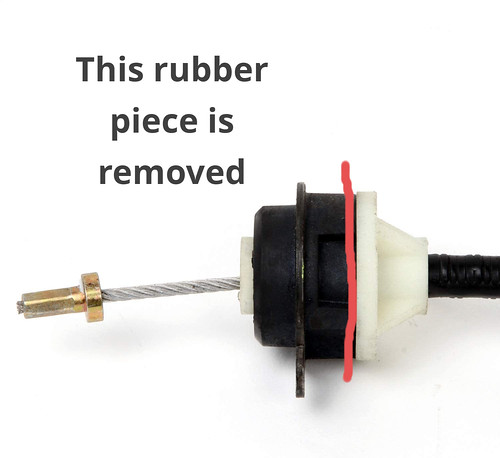

    Did you get the kit that came with a new cable? Reason I ask is the stock cable doesnt have that adjustable end at the clutch fork. It looks like between the adjustment at the firewall and the clutch fork you should be able compensate for a wide variation in mounting distances for the clutch pedal.

    Yes it did.
    The clutch cable is exactly like the original but with the stock rubber firewall mount removed,that way it can slide into the adjuster.

    Got it, One of your pictures above shows a cable with the adjustable end at the fork. When I looked up a stock cable online it showed it having a non adjustable end at the fork. Just trying to figure which parts I should order for my project.

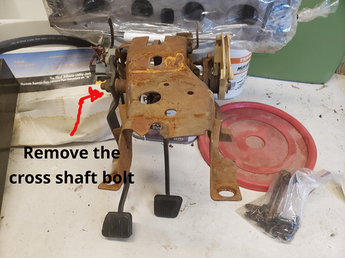

    After seeing the mustang pedal ***embly I realized I had removed the clutch pedal cross shaft from the mustang and used it with the '54 ***embly, after seeing what Rods '56 pedal ***embly I believe it's very similar to the '54 Ford so my method should work for most Fords of this era.
    This is what the 56 pedal ***embly looks like.
    the second photo shows what to remove.
    This bolt is the part you will need from the mustang (fox body) or you can fabricate something,I used what I had.
    This is what you will need.to convert your pedals to a cable.quadrant clutch. HRP.

    I have a question regarding the necessity of the quadrant part and its function. The way I understand it working in the original form where it was plastic and included the ratchet pawl, is that it gave it a self adjusting function for the cable in the stock form. Then the aftermarket companies came up with the 1 piece aluminum part to replace the "weak" plastic part and needed some way to adjust the cable and devised the adjustable firewall part.
    My question is, does the radiused shape and design of the quadrant give it some mechanical advantage? Or if a cable was attached to a pedal at the same distance from the pivot point would it do the same job?
    HOTRODPRIMER likes this.

    Probably a mechanical advantage.

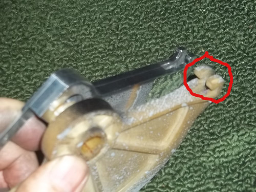

    The first question, from my point of view any part that gets as much repe***ive use as a plastic quadrant I fear will eventually fail, I suppose the pawl was designed to keep tension on the cable, with the original cable the only way to do any serious adjustment was to crawl under the car and take up any slack.
    The adjustable firewall piece makes it easier to do the job, this new aluminum quadrant & adjuster was designed as a upgrade suitable for performance.
    I was concerned that the two small ears on the quadrant could break when I was out on the road.
    A few years ago we drove the wagon over 2,800 miles on one road trip and had it the original plastic quadrant snapped I would have had to get a rollback and then find the parts to repair something that there are parts readily available - Call it preventive maintenance.
    The second part of your question, yes there is a mechanical advantage but beyond that the quadrant rolls forward and down when the clutch is depressed, the way it is designed if the cable was attached to the clutch pedal I honestly don't think there wouldn't be enough travel to engage the clutch unless you could shorten the cable and I would ***ume a strong left leg would be a plus.:D
    HRP

    I’ve had a plastic quadrant break and I’ve also stripped the teeth off of a plastic quadrant.
    When the quadrant breaks the clutch won’t disengage, so you can still drive the car and your not totally stranded.
    For anyone considering using this setup, it is intended for a t5 where the release bearing is constantly spinning on the pressure plate fingers.
    If you use this clutch cable setup on an old school transmission you’ll burn up your clutch and or pressure plate.

    That’s what happened to the one I broke, the teeth stripped off. It is a self adjuster, the pawn engages the teeth on the quadrant, and when the cable stretches, the pawn will get a new bite and take out the slack. Supposedly, after you adjust the cable at the transmission, the self adjusting quadrant keeps the clutch adjusted automatically. The piece I fixed mine with was an aluminum angle bolted to the quadrant, and used a bolt and two nuts to hit the pedal arm. I took the slack out of the cable with the bolt pushing on the arm, then locked it into place with the other nut. It was still working fine on the truck a year later when I got rid of it.
