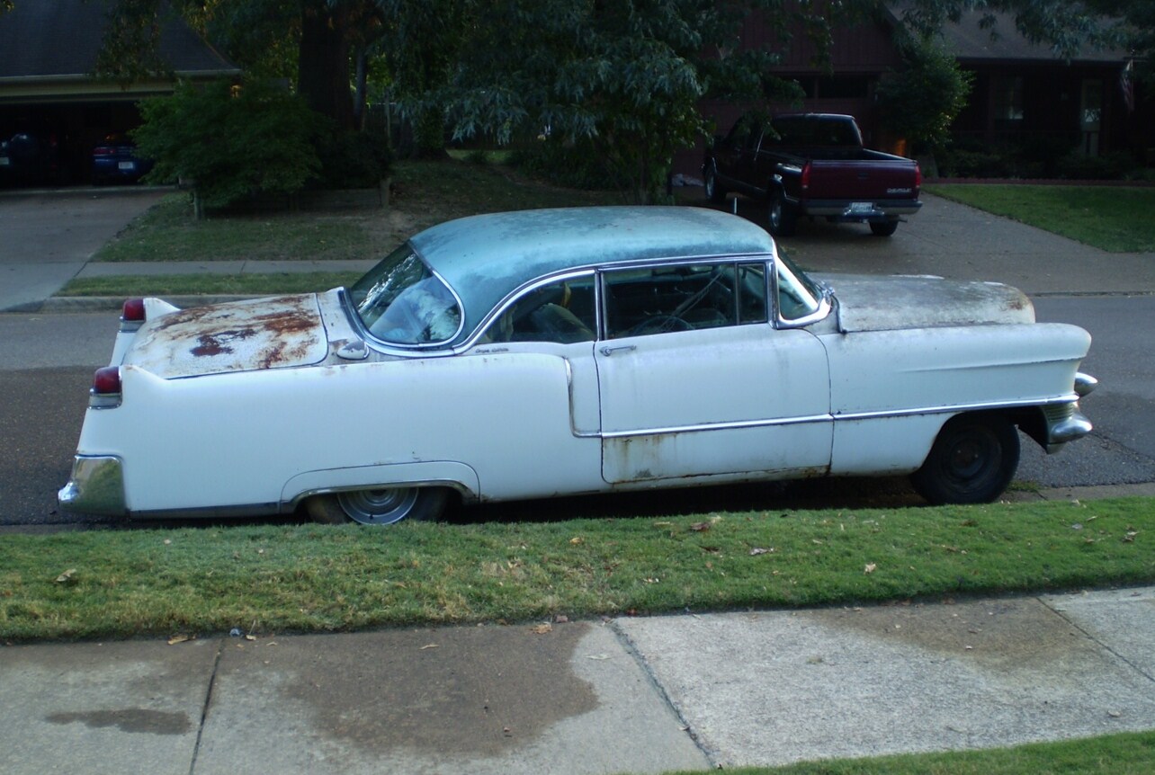

Installing a nova subframe on a '55 caddy coupe

    Well, in the first place you asked for opinions on clipping your mid 50's GM car, and I responded by telling you I've done three, I've also clipped dozens of "totalled" cars and trucks, including the Silverado I've driven for the past 9 years, and that there are pitfalls you can avoid by not using the particular clip you have just because you have it. I and others also pointed out it's no more expensive to rebuild what you have, and way less work. Add in that it doesn't sound as if you've done one before, and it looks like you've got a decent start on a car. Sorry if you took offense, but cutting the frame off at the firewall is pretty much whacking it in two.
    I didn't insult you personally, although you've chosen to do that about me, my car, where I and lots of other folks live. You asked for alternatives to the (poor choice for your car) Nova clip, and I and others did so. Obviously, you're ready to proceed simply because you have it. Go ahead, it'll work, it'll be hard, and it won't be as good as it could have been if you'd picked the right one, or rebuilt the original one. Period. Ultimately the cost will be roughly equal if you include your time and the end result. Again, the nova clip will put the steering box in the same place it lives now, so you're still going to have that issue to deal with as opposed to a front steer clip. A front steer clip fits in a '41 Chev behind the fender and grill, and clears the rad. support, and your Caddy has WAY more car out in front than my little Chebbie did.
    Cars laying on the rocker panels look broken to me. Sorry, but they do. The primary goal you've stated for this is to do that, so "lay'n frame" is your goal. Bags break, lines leak, fittings crack or loosen, and your Caddy lay'n frame on the highway with no bump stops to support the suspension and keep the hard parts off the ground is poor engineering, simply put. Ignoring safety and driveability are poor reasons to cut up a car, changes made to improve handling and braking aren't, so if you get opinions based on wanting to make changes that ignore those factors for "style points" at a car show and impress kids who don't know any better, then you are welcome to do so and ignore us old guys who point out otherwise when you ask us to.
    I've fucked up a couple of cars that I wish now someone advised me not to, but like you, I knew better.:rolleyes: It's never fun to be told that an idea is a bad one, and it's stupid to argue with someone or get into a flame war. That's not what this about. Just think hard and ask yourself if you're headed down the right path before you take the sawzall to that Caddy.

    I tell some of my best friends where to stick there heads...and make fun of where they live......so anyway.....Check out "40studedudes" 55 caddy build thread. The box sticks thru the front support, I was ready to do just that,(talked with him several times... he lives in the tundra too) Several people suggested I use a rear steer set-up up, I finally bought one (completly rebuilt-$400-box&new discs included) The
    front steer stuff is plentiful and cheap! I wanted to use one....... and as I said I also considered taking apart the original caddy stuff, coating and rebuilding it(bushings etc.) out to the discs. min. $1500 with a pieced together disc kit, add another $600 for dropped uprights and steering arms(theyre to short to heat and bend). That's all before I get to the broken airbag stuff. I know you've got to pay to play, but damn. I'll take any advice that's given, especially from the experienced. Tell me if you see what I see on studes caddy.

    I have looked as Studedudes build, and yes, the box and frame horn protrudes thru the core support, as it does on my '51 and the '48. However, it works, it's easy to trim the core support, doesn't interfere with mounting the bumpers, exterior sheet metal and it gets the box out of the way of your exhaust manifolds. I have the stock radiator in the '48, a Honda Odesyee (sp?) in the '51 turned on end, but the stock core support with a notch in the lower left corner. The stock radiator would still fit.
    Again, I'm not saying it can't be done, but really, that Nova clip isn't the one I'd pick if I were doing another Caddy. Sorry to have ruffled your feathers, and again, it is your car, but there are better ways around this than the Nova clip. I'd measure up a Caprice/Roadmaster/Fleetwood. If they're too wide to tuck the tires in with it slammed, it's easy to narrow one. I just narrowed the Chev van crossmember going under my Diamond T 3". You'll have bigger brakes and the same bolt pattern as your rear axle.
    A buddy of mine told me many years ago when I put a Ford 200 six in a full fendered '27 T that it was a mistake to use an engine just because you have it. He was right, the car would have been way better, and way more saleable with a popular (read SBC or small block Ford) than the six.

    54cruzer, how did your 55 caddy turn out? I bought a 55 caddy that already had the nova subframe installed except for the steering. The front wheels are not out wide enough in my opinion. No drivetrain in the car so if I'm going to make a change, now is the time. What did you end up doing? Just trying to get more advise. Thanks, Jack
