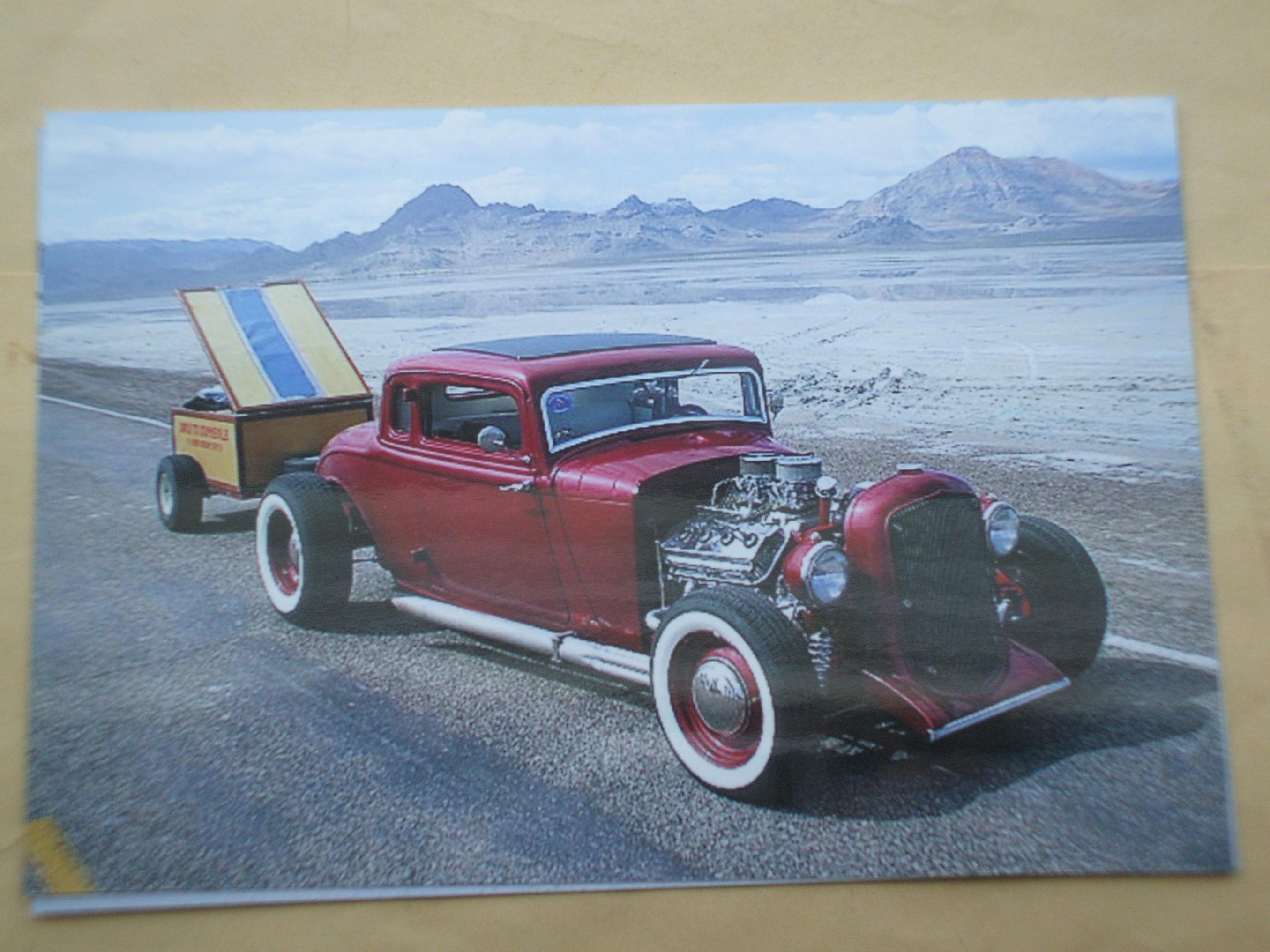

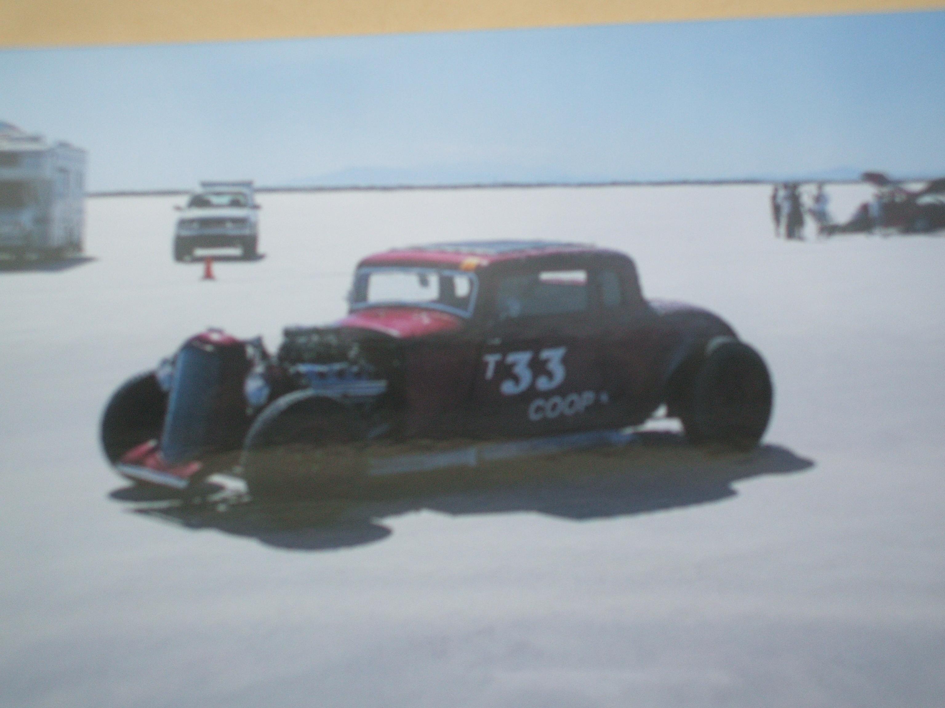

  30. RDR
    Joined: May 30, 2009
    Posts: 1,601
    RDR
    just for something interesting...I met Jim Ireland at USFRA meet on Bonneville Salt Flats in 2009...he had driven out from the East coast with the 'Rolling Bones' in his 33 Mopar...anyway he had replaced the Torqueflite trans behind the Hemi with a TH400 and must have the only push****on turbo hydramatic in existence...Quite an engineering feat I thought..He made the 130 club with the coupe too! Neat car..
