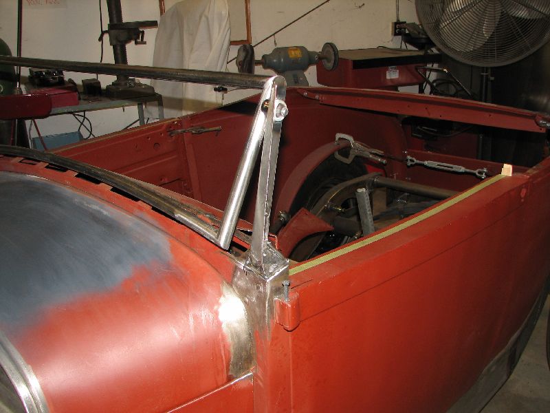

    After cutting off top and post here is a list of what I used.
    29 roadster windshield cut 4". Some filling is needed. Roadster windshields are not square.
    1" angle for mounting bracket.
    3/8" ID tubing for stud spacer.
    1/4" rod for base.
    1" freeze plug for windshield stud spacer.
    I made a cardboard pattern to determine shape and angle.

    thats really nice! a great,simple shape that looks right.
    Dude im jealous of all your shop gear!

    That looks like it came out really nice... congrats!

    Good Job. Can't wait to see the finished project.

    Looks great! Like that dash as well.
