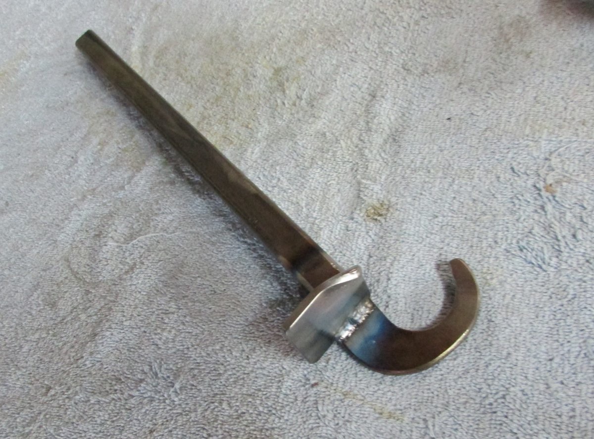

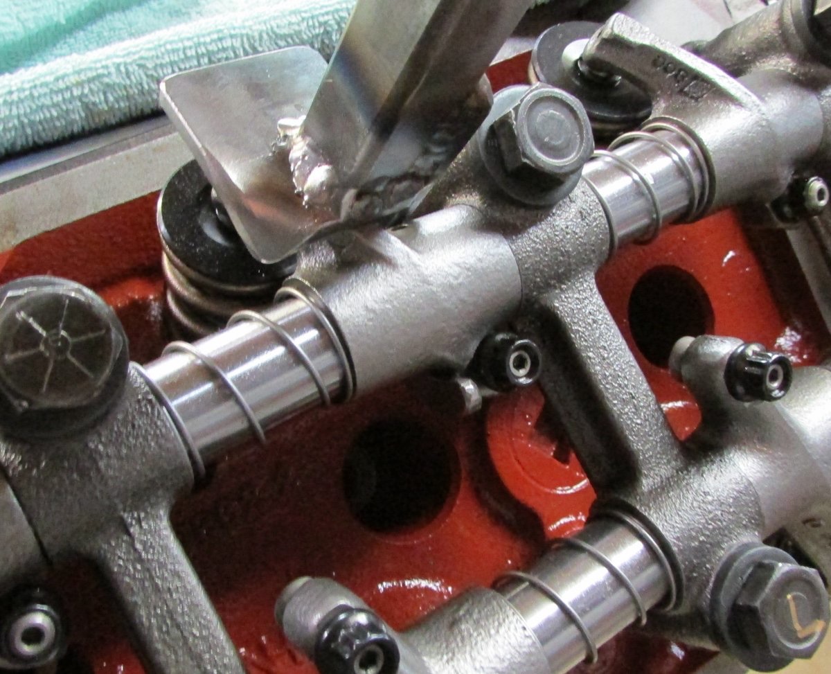

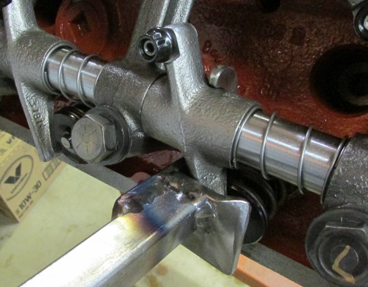

    D1C4829D-44F6-4D42-AA19-F528DC7D79A1.jpeg 5FCD155B-1225-42BC-8634-5F4E8F9F1F8F.jpeg E080AA07-A517-438A-8070-75613AC42EF4.jpeg
    Here’s a few pics that are from a thread that’s currently on here.

    IIRC, the pushrod holes in the head are small. I think you need to be able to also move the rocker sideways just enough to install the pushrod so the tool needs to only push one the retainer/valve tip. Nice tool though.
