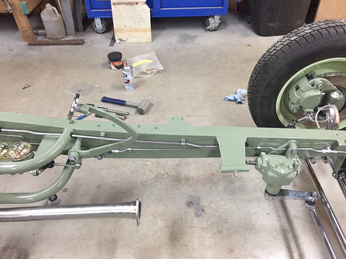

    3/8" fuel line, one continuous piece from tank to firewall. Just put this in last week on the shoptruck. It will run a short piece of nylon braided line to the in tank pump...
    down the frame rail (a bit tricky getting through the crossmember but I fabricated provisions for the line earlier in the build. I left room for a return line but I'm not using one this time.
    and to the firewall mounted filter.
    I am not a big fan of flex hose ran all over the underside of my cars and more joints mean more chance for leaks.
    Make sure you route away from heat sources to prevent heating the fuel in the line and away from moving parts obviously. Use a lot of clamps, these are just those rubber insolated clamps that are 3/8" so they fit snug.

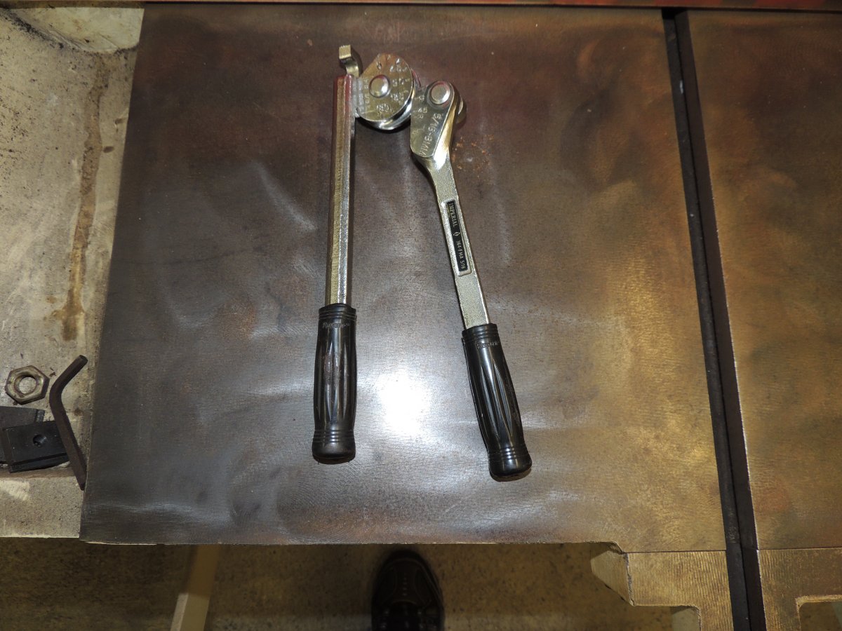

  27. ekimneirbo
    Joined: Apr 29, 2017
    Posts: 4,218
    ekimneirbo
    Great picture. The OP should be aware that the picture shows how to make a 37 degree fitting. Notice that the flare on the end of the tube is a "single flare". He will need a flaring tool that specifically makes 37 degree flares. Inline tube sells a nice one. Instead of simply pushing the tubing out all at once and maybe cracking the flare, it works as an eccentric in forming the flare. Might be able to find them a little cheaper somewhere on line, but try to get one that works similarly. Mine was about $100, but its really well made and works well.
    Again, I went on line and bought packages of JIC sleeves and nuts. Its cheaper to buy them maybe 25 at a time and put the extras in a drawer. Don't try to use 45 degree flares with 37 degree fittings.
    If the budget allows, I would buy or borrow a tubing straightener. Lets you uncoil the tubing and make it look nice and straight. Pics below show 37 degree flaring tool and a SET of flaring tools that do lots of different tubing types.
    The single tool is good for all 37 degree flaring whether you do it in a vice or already installed on the car. The SET only allows you to do the flares before you install the tubing. Both have their advantages. If anyone decides to buy a SET, note that some sets are less expensive because they contain fewer dies. If you are NEVER going to run fuel injection on your vehicles, you don't need the flares to form the GM push on type fittings. The set will make nice 45 degree, 37 degree, bubble flares.....lots of choices for brake lines as well as fuel lines.
    These type tubing benders give a tight professional looking bend. You can get them off Ebay used for about $30.

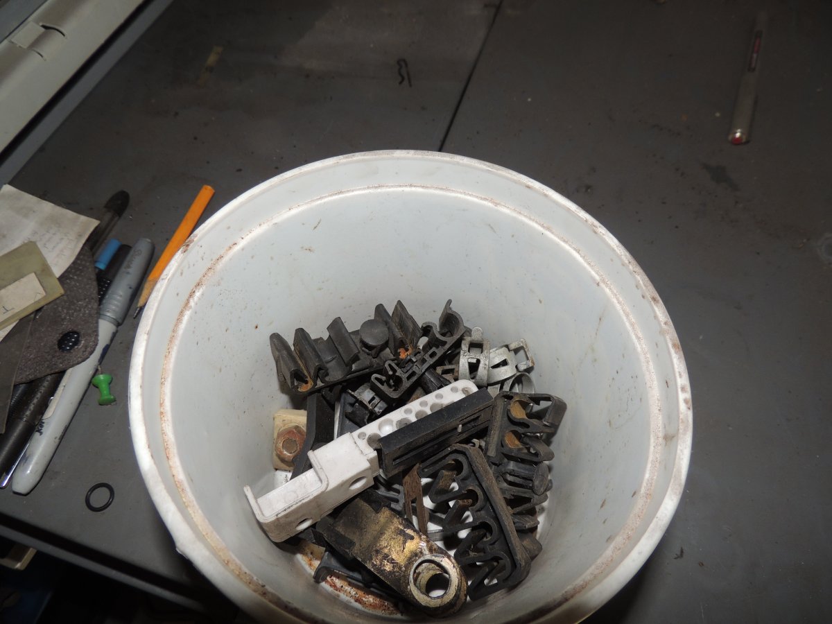

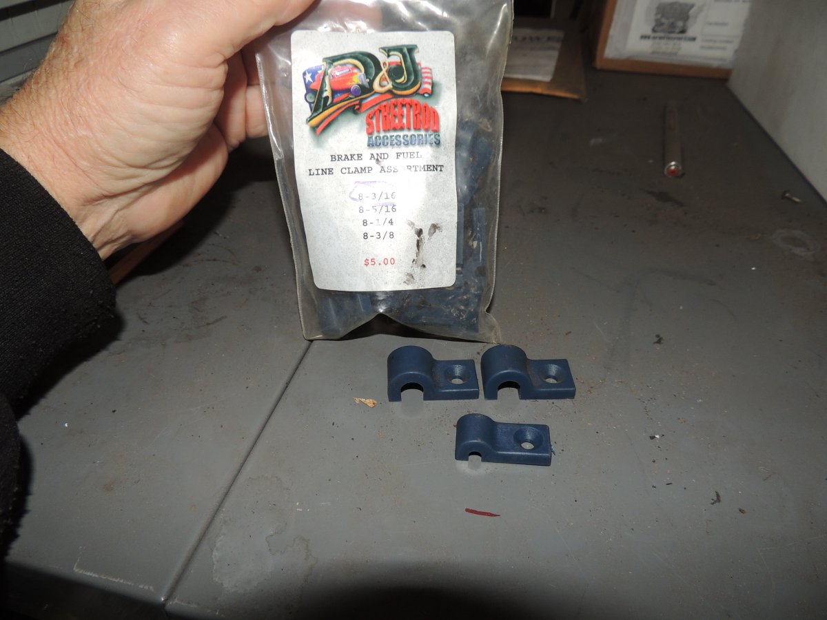

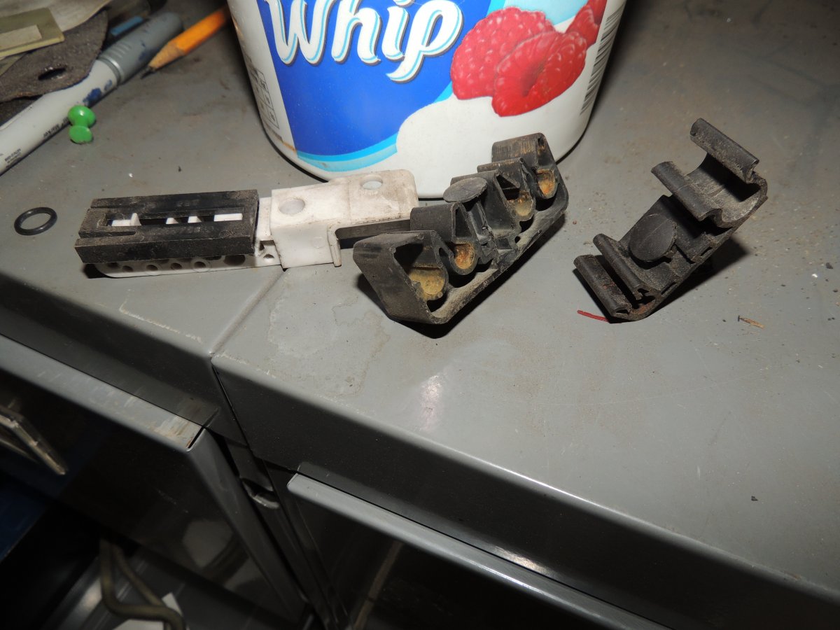

  29. ekimneirbo
    Posts: 4,218
    ekimneirbo
    While I have used them over the years, I too never really liked them. They work great, probably just an irrational deciciency in my DNA. I like to "repurpose" (can I use that politically correct term on the HAMB)......actually I hate that "F****x" word. I simply "reuse" existing tubing clamps that I scrounge off cars at the junk yard. They have ones that deal with multiple lines when needed. Additionally I found some at the "Nationals" that are plastic and work really well. So there are a few other options out there.
