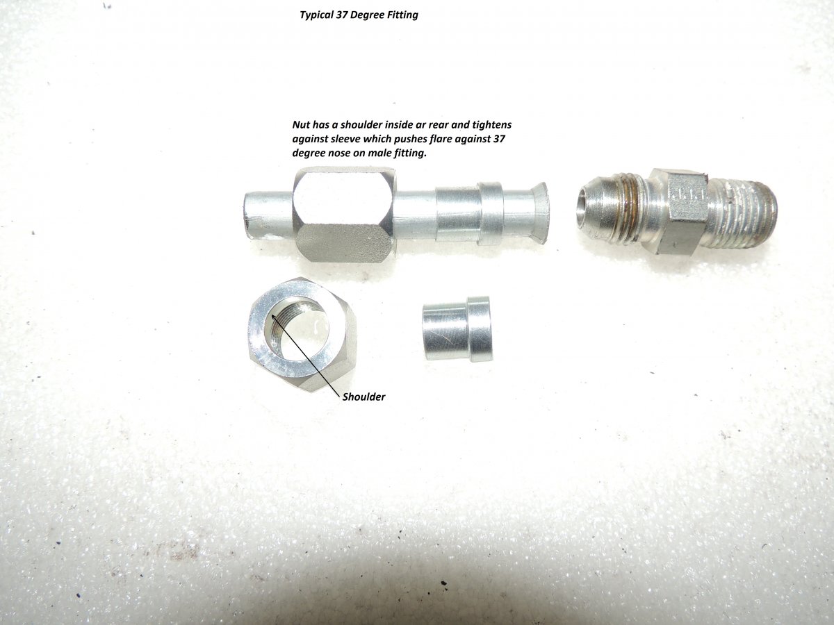

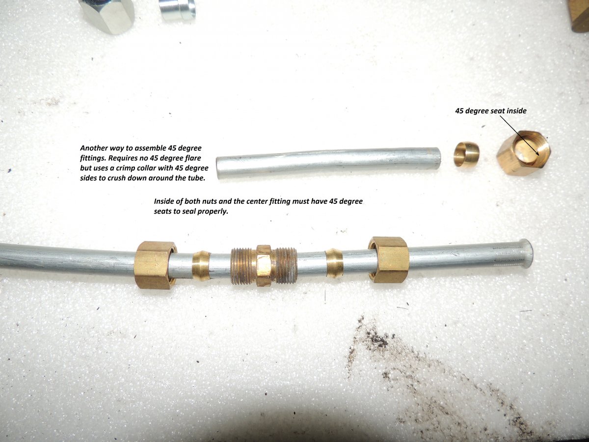

    Here are some pics for anyone unfamiliar with the differences between 37 degree and 45 degree flares. 45 is used in a lot of plumbing fittings but can be made to work for fuel lines. Often you are stuck with the br*** look on fittings. Using a 45 degree flare on the end of a tube will necessitate using a fitting that has some type of 45 degree flare inside. That often reduces the size of the hole the fuel or fluid flows thru. I believe using the non-flared 45 with compression sleeves around the tube will allow less if any reduction in flow . Using the 37 degree fittings is comparible to what the military uses and doesn't impede flow. Thats what they use in aviation and it works well. It really depends on how much flow someone needs. I always go with 3/8 and don't worry about having to redo it later. The cost between doing 3/8 and 5/16 is pretty insignificant. Also, if using 37 degree stuff, 3/8 is easier to find stuff for. I know I had a hard time finding sleeves for 5/16.....so when I found some I bought a bunch. I use them for a return line in an OT fuel injection system. Nuff said !

    AN fittings (as well as their industrial twin brothers JIC) are 37 degrees. I would expect that the Hilborn would use 37 degree fittings. Getting a handle on threads and fittings can be difficult because in addition to the basic comparison pictures I posted above, there are some variations in the shape of the flares used on tubing.
    First, just understand that the two most common ones people use on fuel systems are 37 degree and 45 degree.

    The 45 degree flare is a Double flare that is done in two steps . First the initial flare is made on the tube. Then a second operation is performed that folds the flare back on itself.......doubling it. That seats in a fitting that has a 45 degree flare inside for the tube to seat against.
    There is another flare that is called a Bubble flare. Basically its done like the double flare but the tube isn't pushed all the way back so it doubles. I have only seen these used on smaller tubes, so I don't know if larger (1/2") sizes are available. Let me know if there are larger (1/2") ones. I'll include a picture below so people can see what they look like. Also a chart that some might want to print out and stick on a cabinet door.
    Then there is the 37degree single flare used with a sleeve to push it against a 37 degree seat. These are AN or JIC.
    AN is a military Spec while JIC is the same design but in an industrial spec.....usually made of steel.
