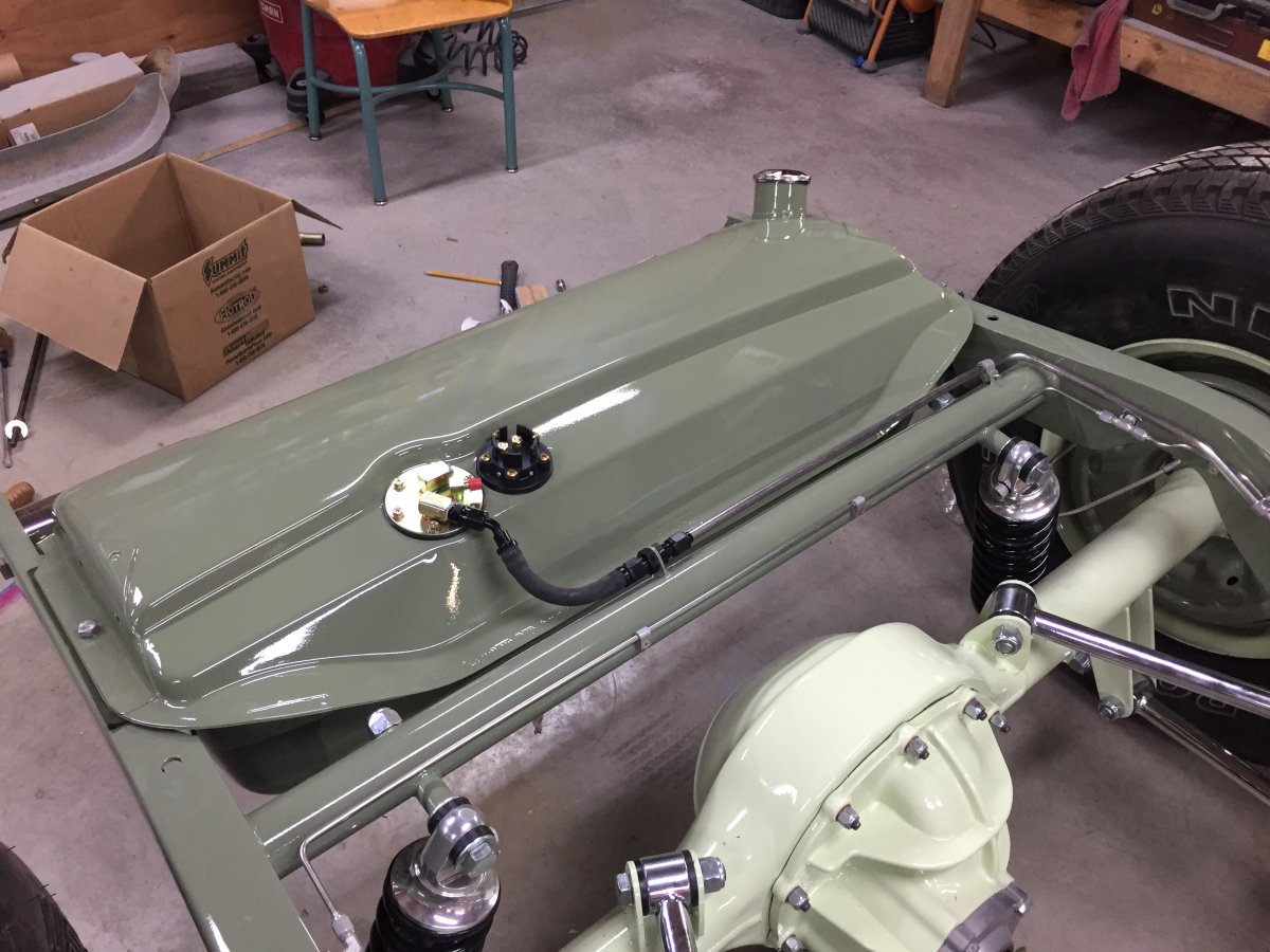

    What in tank pump is that, does it need a return and are you running carbs?

    Did you run a flexi from the ch***is t the body transition on the firewall to allow for body movement? Also, are you running a in tank pump (the return line mention got me wondering) if so, which one? I'm currently looking at all this on my 40, alot of ways to jump..

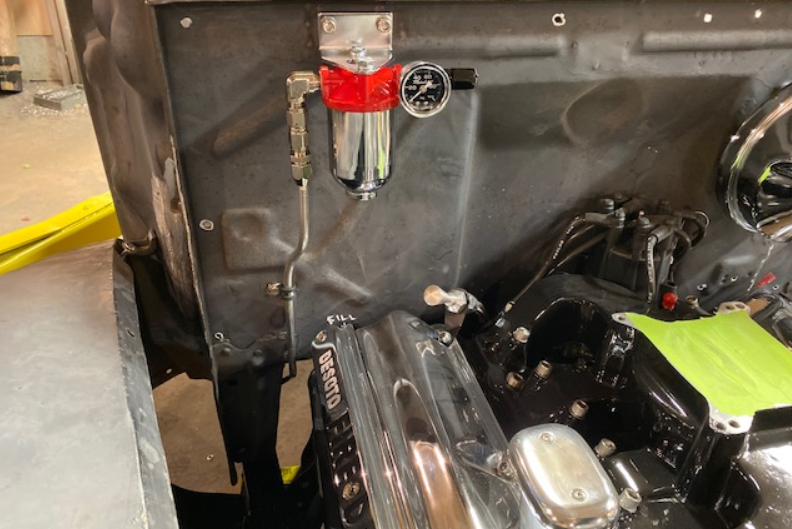

    I did not run a flex line to the firewall. I would hope the cab isn't moving around once bolted to the frame. :cool: I did run a flex from the frame to the tank to make removal and service easier, and from the fuel filter on the firewall to the Holley. I have a TanksInc tank but I used a Holley Sniper internally regulated in-tank pump that did not require an external regulator or a return line (aint technology neat?).
    Yes, there are a lot of ways to skin a cat (disgusting adage). Particularly when you are starting from scratch as opposed to retro fitting a vehicle. And they all will probably work just fine as long as you utilize the correct components that are engineered to work together and not piecing something together and trying to get lucky.

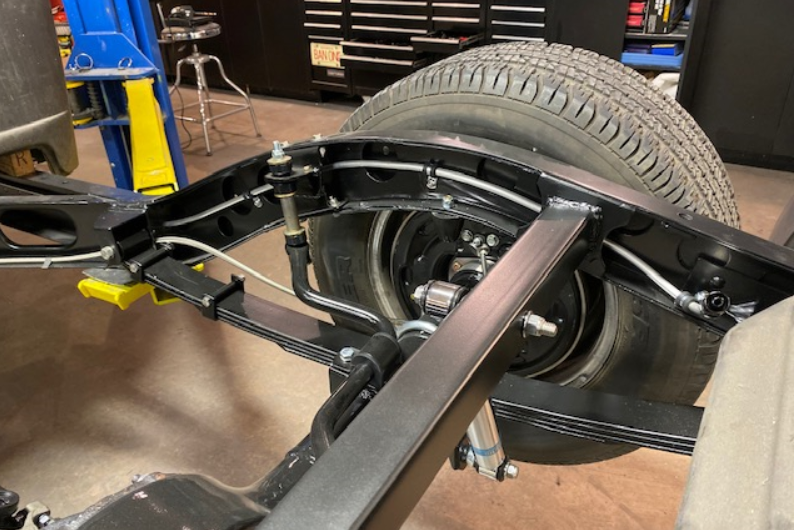

    I'm upgrading to a Holley Sniper* so I had to go to an in-tank pump (Tanks Inc.) which I was told should run 3/8" supply line, 5/16" return and 1/4" for vent.
    Question : I'm planning on using double flared steel brake lines with inverted flare br*** fittings. Will those be adequate for high pressure fuel lines?
    As previously mentioned in this thread, I'll be going from tank to engine including an in-line Holley filter with the steel lines (return too...) held onto the boxed frame with Kugel clamps.
    I just want to make sure that the brake fittings will work for fuel lines.
