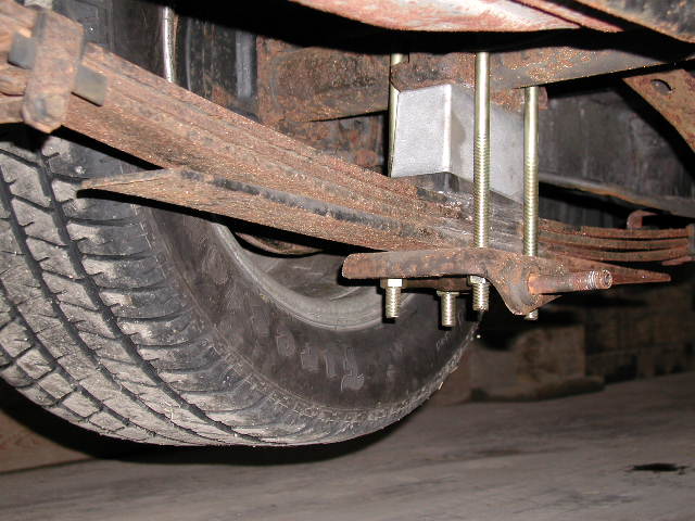

    Lesson 1:

    Damn, Pokey for a guy that " Built 12 cars and modified 5" this should be pretty simple :D ! Your block goes between the axle tube and leaf spring, then clamp em together with some longer ubolts. Finish up with new shocks if needed.
    edit: kerrynzl beat me too it.^^ That pic pretty much sums it up.

  26. Kerrynzl
    Joined: Jun 20, 2010
    Posts: 3,638
    Kerrynzl
    WHAAAAT!!!!
    The shocks are mounted to the bottom spring plate! When the spring gets lowered so does the body [by the same amount ]so the shocks remain the same length
    The springs and shackles, spring plate etc are totally unchanged
    The number of leaves is irrelevent.
    All you're doing is moving the axle UP under the car a bit more [ which effectively lowers the car ]
    If your shackles flip, thats piss-poor-mechanical-ability ,not the lowering blocks fault

  28. Kerrynzl
    Posts: 3,638
    Kerrynzl
    Don't be confused, you've never had a problem.
    Read my last comment, and look at the photo I posted on this thread.
    On some rear-ends [ usually Pom **** , or coil rear-ends converted to leaf springs] the lower shock mount is on the diff housing not the spring plate
    This will require a shorter shock when lowering [ or a shock mount spring plate ]
    Google Image "lowering blocks"
