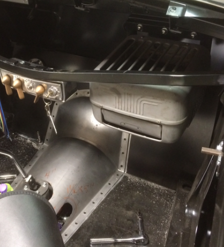

    So, I am still playing with my heater that I started for tech week last year. I made the install system and welded it to the firewall but needed a place to put the controls and I'm running out of real estate. So I disassembled the original controls that came with the heater. Had to cut off the top bracket that you see under my fat thumb.
    Then I cut the lid of the heater housing (which is vacant behind because of the small size of the heater) and frenched in the controls so they are almost parallel and flush. I tired to line up the art deco ribs in the cover and the panel but missed slightly. Then ran the panel across the buffer real quick to get the effect. Here it is in primer.
    and with the control panel installed.
    I have saved the knobs and vent door handles and will restore and use them. This will make the heater a true plug and play unit. It is held by three bolts to the firewall bracket (see below) that was welded in place so no bolts protrude through my firewall and no hoses either. The entire unit has only 2 wires, red and black which will run through a relay. Plus the defroster duct hoses so it comes out easy and fast if need be.
    Here it was installed until I took it out and cut it apart last night (slow night at the garage).
    Ill paint it up and install the stainless belly band, should look cool (hot?). By the way, I took the heater to the golf course on a balmy 40 degree day and tapped the 12 volt golf cart for power to see it could provide warmth. The cart had curtains and it definitely put out heat. Not going to say I was warm and toasty but it was a hell of lot better than the other frozen assholes that were trying to sit in my cart between shots. I have a propane cart heater too, this actually worked a lot better probably because of the heat distribution by the fan as opposed the radiant heat. And yes, that is a ZZ top key chain. Hung in every rod I ever built at one point or another.
    Fun times waiting for parts to show up. Hope that wasn't too boring or waste of time. I sure had fun doing it.

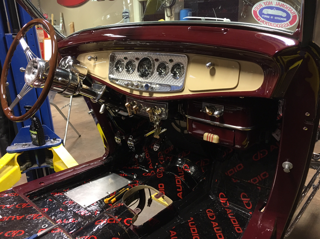

    update 2018, done and installed

    Truly elegant, B.B.! At first glance, I was reminded of the '32 Packard dash in my old '29 Highboy, with dual "jockey boxes". Then I relented, and went back to read in detail the '100-yd.-dash-board'.
    Some out-of-sight trickery here, the reshaping of the lid and its mate did wonders.
    Good thing this is a 'drophead' (roadster) as it might be overlooked in a coupe or sedan!
