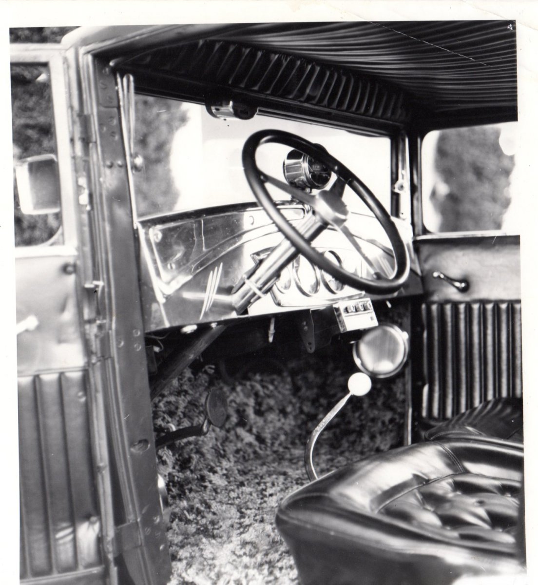

    Just came across an old shot of when I had Mustang seats in it, **** carpet [jeez],
    mini 8 track, different gauge center, Hot rod with Mustang seats.jpg tuck-n-roll headliner...
  7. **** carpet needs to make a come back.
    NoSurf, Mick Coyne and Just Gary like this.

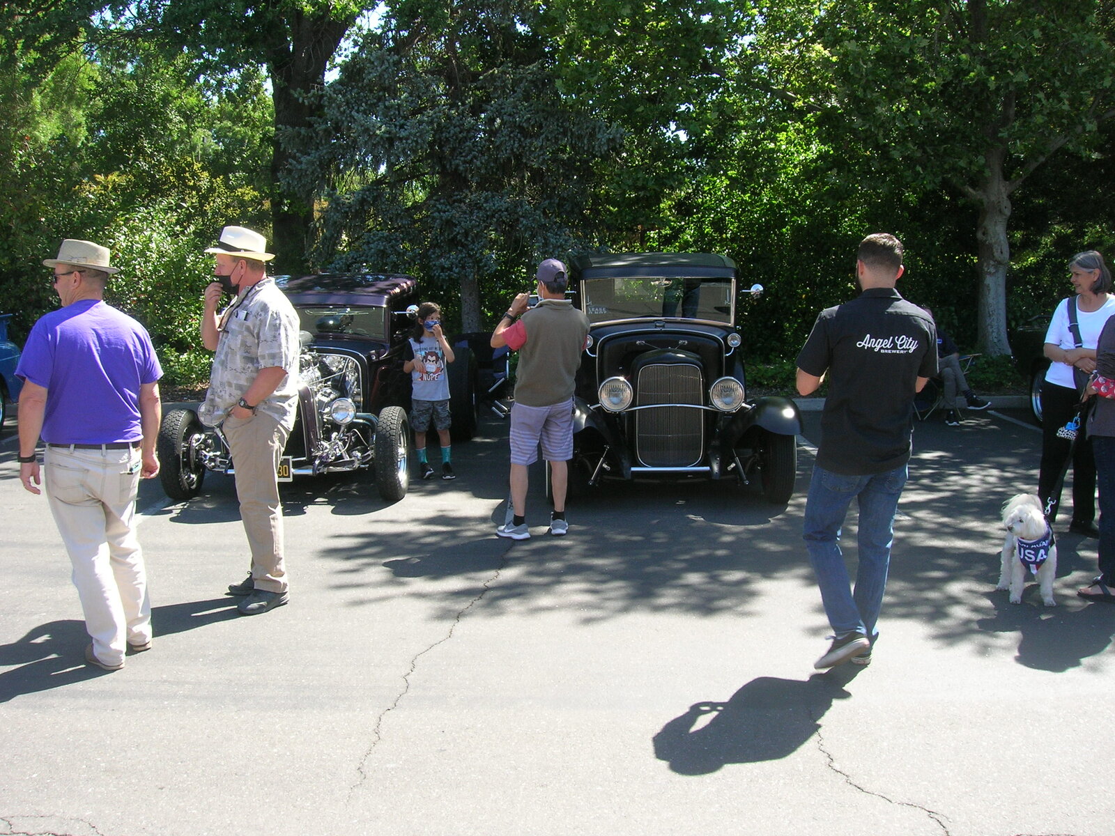

    We attended an All Fords Car Show three blocks away from the house today.
    Didn't register, parked in back, didn't want to get booed for having a Chevy engine.
    Still, got a lot of looks and answered a lot of questions, they seemed to like it. Ford Show Shadelands June 2021 040.JPG

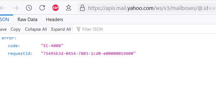

    That's strange, when I click on the red highlighted portion it comes up [????].
    No computer guy here, maybe I'll try it again later, thanks for the heads up,
    Mick

    Sorry Mick but that doesn't work either.

    That's so strange Denny,I can view it when I click on the red lettering here on the HAMB [?].
    Oh well, no biggie.
    Thanks for the heads up,
    Mick

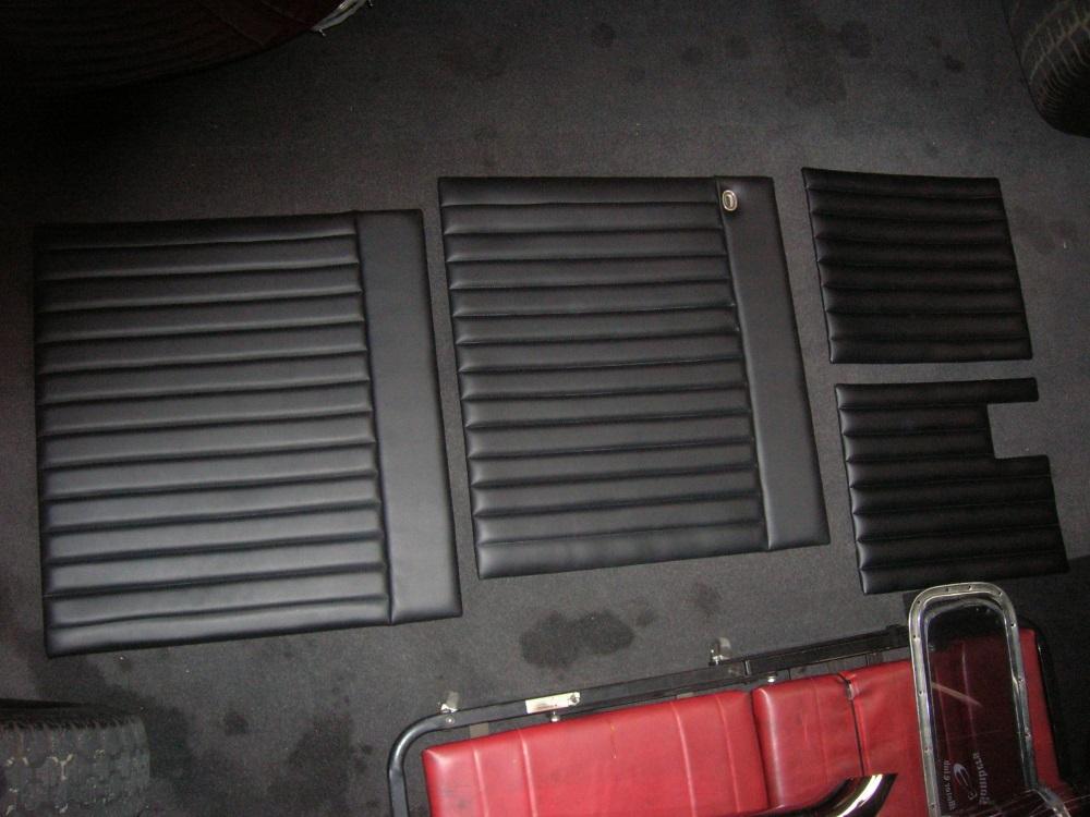

    I made some templates for the upholstery then had a local upholstery shop sew 'em up.
    Then the same with the carpet, attached.

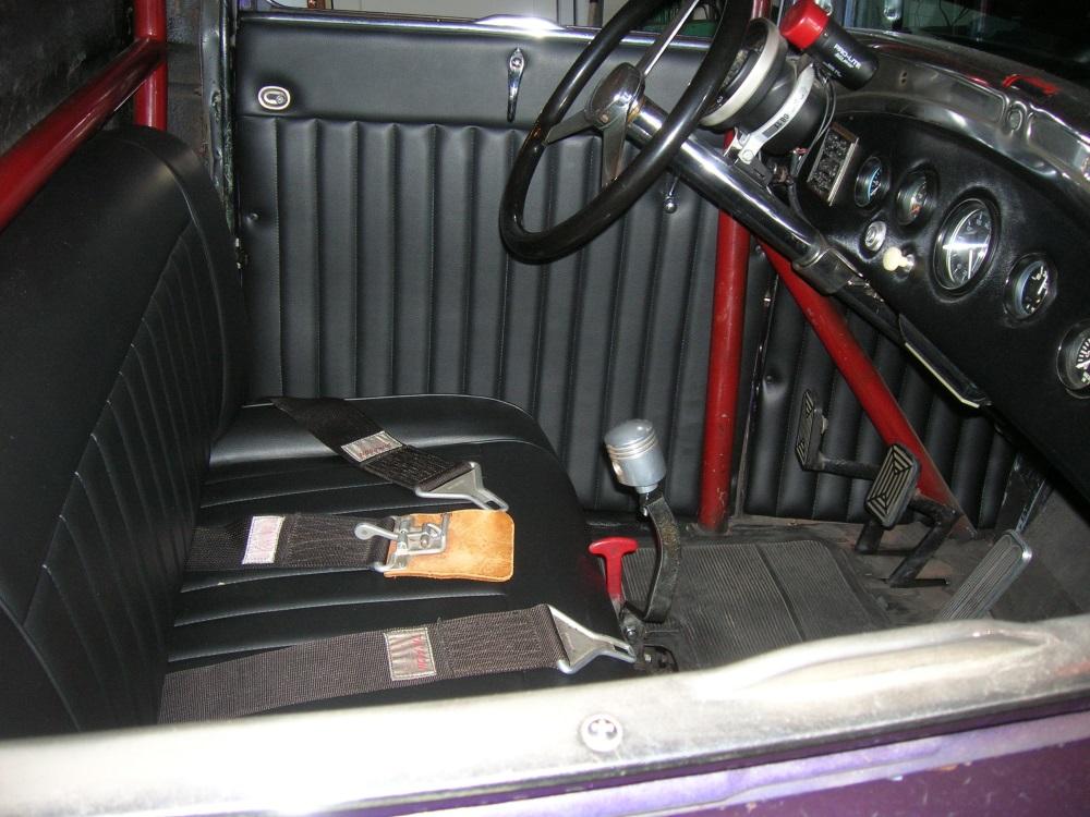

    Signed out by mistake, here's the upholstery.
    Then the carpet...

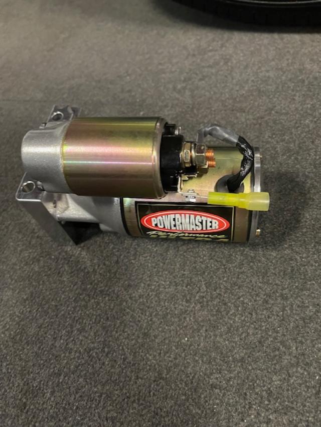

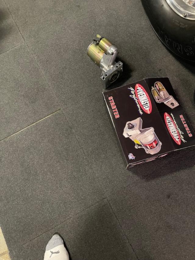

    Installed a new mini starter, what a difference.
    Now I'm sticking them in all of our cars.

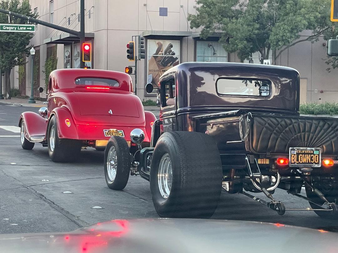

    The wife and I cruisin' back from our Friday Night Gathering [her 34],
    Mick

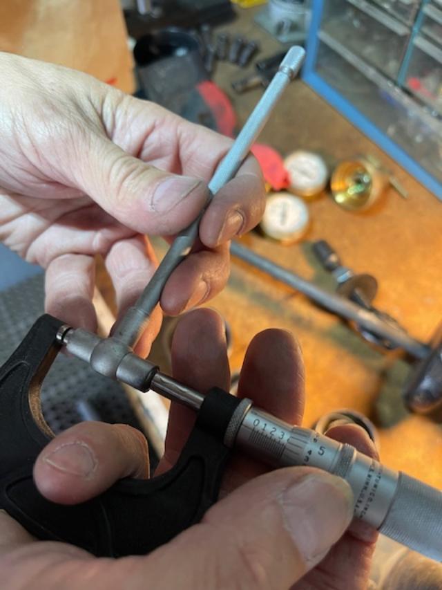

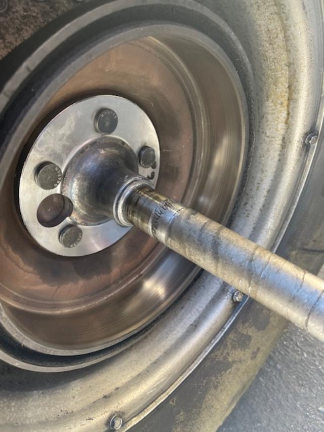

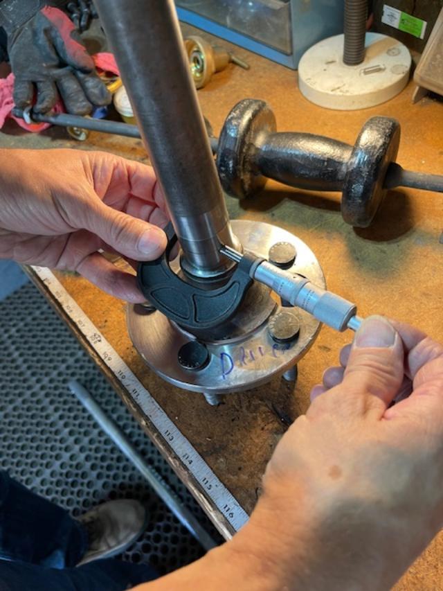

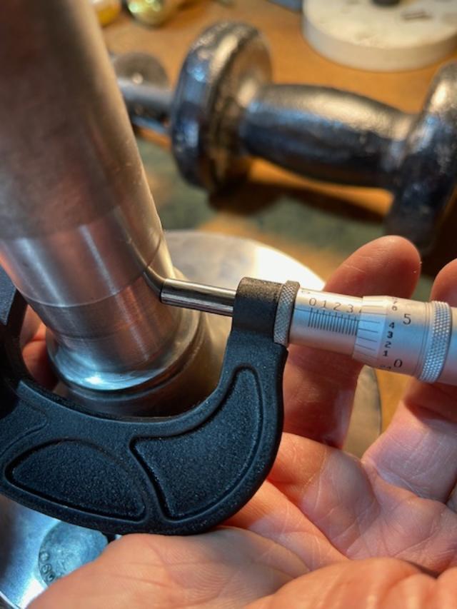

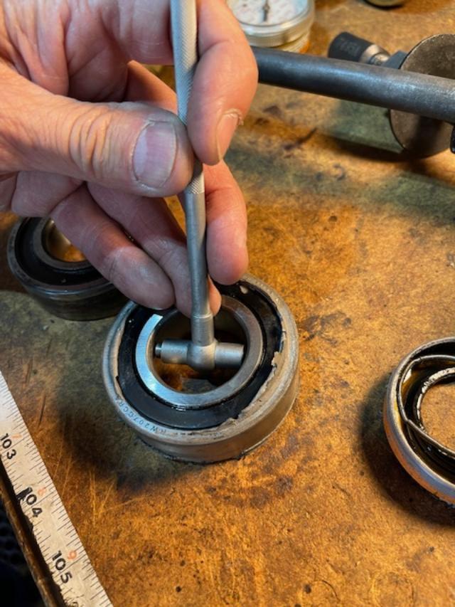

    Here's a scary story, scared the h-ll of out me.
    I was getting gear oil on the rear brakes so it was time to replace the wheel bearings [showing wear]
    so I figured might as well buy some new axles as well.
    $950 for axles, bearings, collars...
    Installed them, piece of cake.

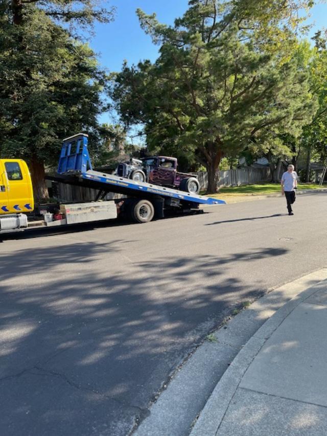

    The wife and I were heading to our Friday Night Gathering [took both cars] and all of a sudden it felt like
    I was in an earthquake. The back of the car was swaying back and forth, what the...
    My new driver's side axle slid out of the housing which in my case that also meant no brakes.
    We were 40 feet away from the freeway entrance...the roll cage would have been put to the test.
    The wife got on the horn, she scooted into a parking lot [I have to say, she saved the day], I followed
    and was able to come to a stop without crashing into anybody nor anything.
    That sure got my attention!
    Got the car home and into the garage, whew!
    Please don't ask who the manufacturer is because I got a call from the owner, got my $ back and told him
    I wouldn't take it any further although on other HAMB there's a section about axles coming out of other cars.
    I have to keep my word/old dude.
    The bottom line is the new axles are fine, it was the bearing collars that were NOT made in USA.
    My friend has a machine shop so he made new collars that fit very, very tight and it's been fine since.
    Anyway, man, be safe out there fellas,
    Mick
