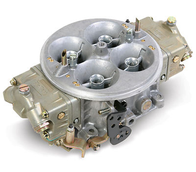

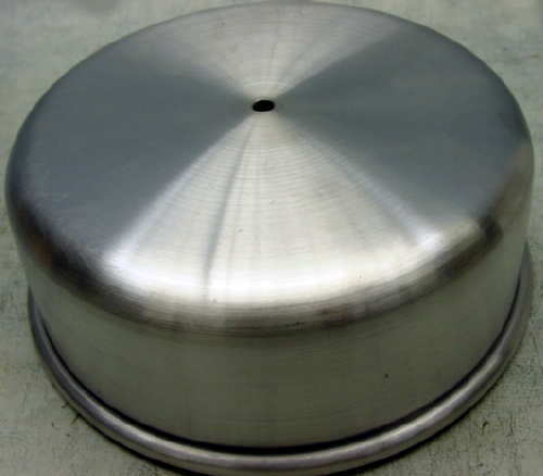

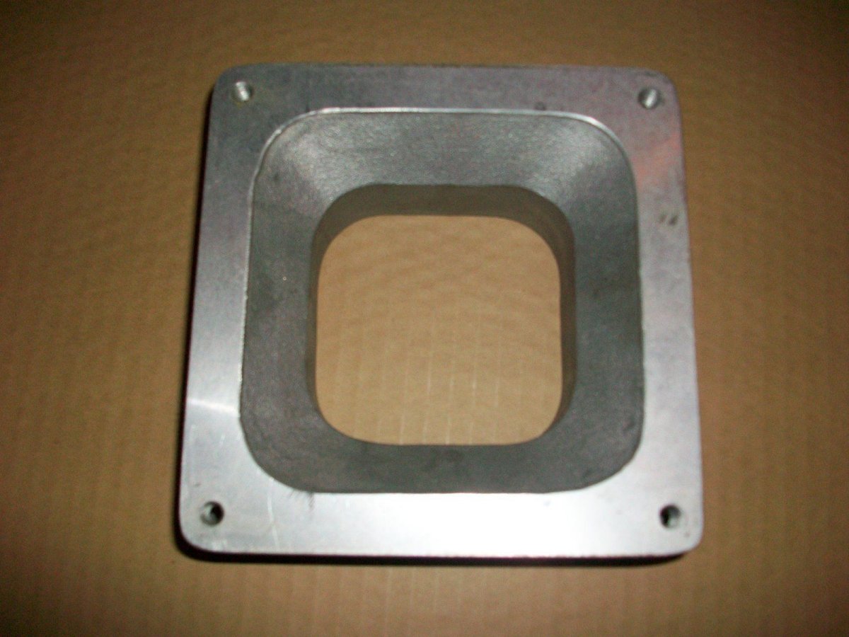

    With this:
    And maybe this:
    But you will need this:

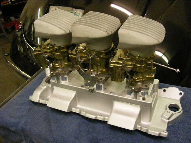

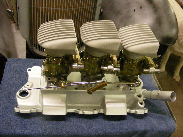

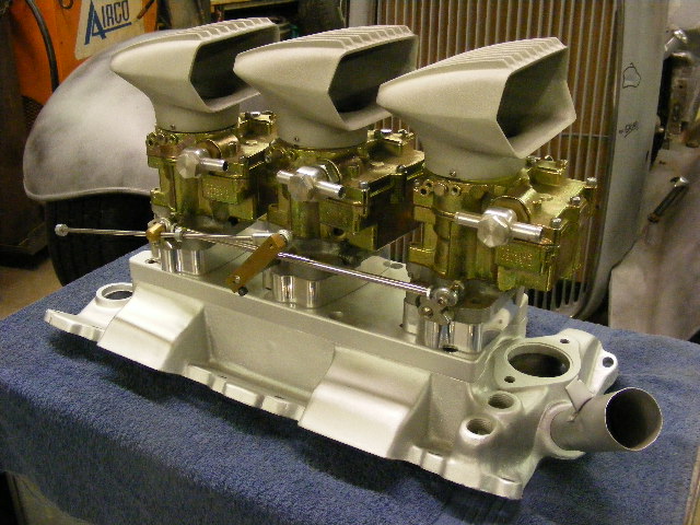

    Bored with the over used Offy's & Eddy's Tripowers? Just finished this rare Creitz dual 4, converted it a Tripower with the small base Rochesters.......................
    slack and Nailhead Jason like this.
