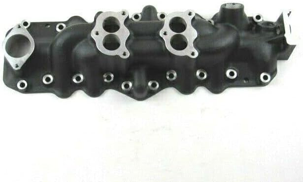

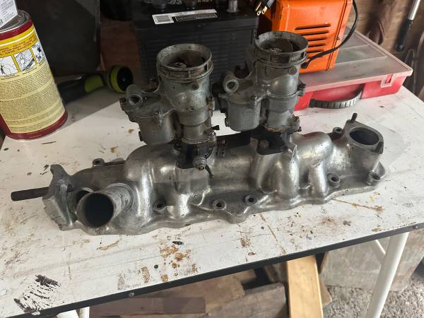

    I did see on craigslist this intake and carburetor set up. I was not able to buy it as someone else bought it who was closer.
    But, would this intake work with the factory generator location? And if so, does anyone know what a part number for this would be.

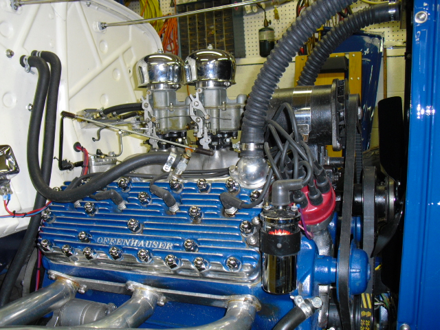

    wheeldog57
    The second intake pictured in @tubman post will work with an original generator however it doesn't have the road draft tube and oil fill set up. A few things to consider Ben but you can overcome these with some old timey 20240505_191005.jpg hot rod ingenuity.

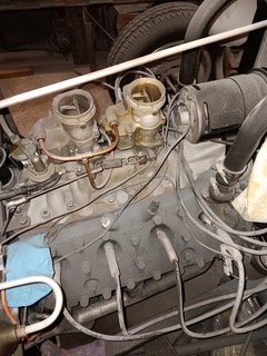

    I don't know where mine fits on the list. the generator is in the stock location and the carburetors are mounted backwards. 20241014_213927.jpeg

    rustyrim,
    From the picture, the generator looks off centerered from the carbs. Am i correct?
    what kind is it?

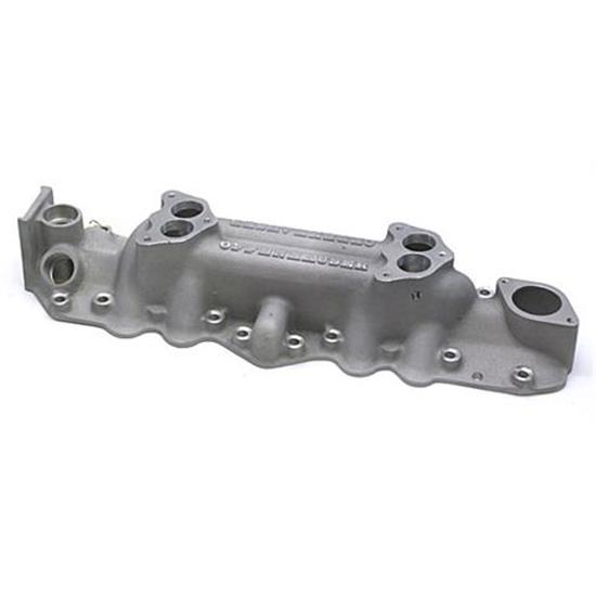

    sidevalve8ba
    Here is a photo of the old Edelbrock intake I mentioned earlier with carbs and a generator installed.

    the generator is stock and centered on the intake, the picture I took makes it look that way. it is a Hexagon tool intake.
