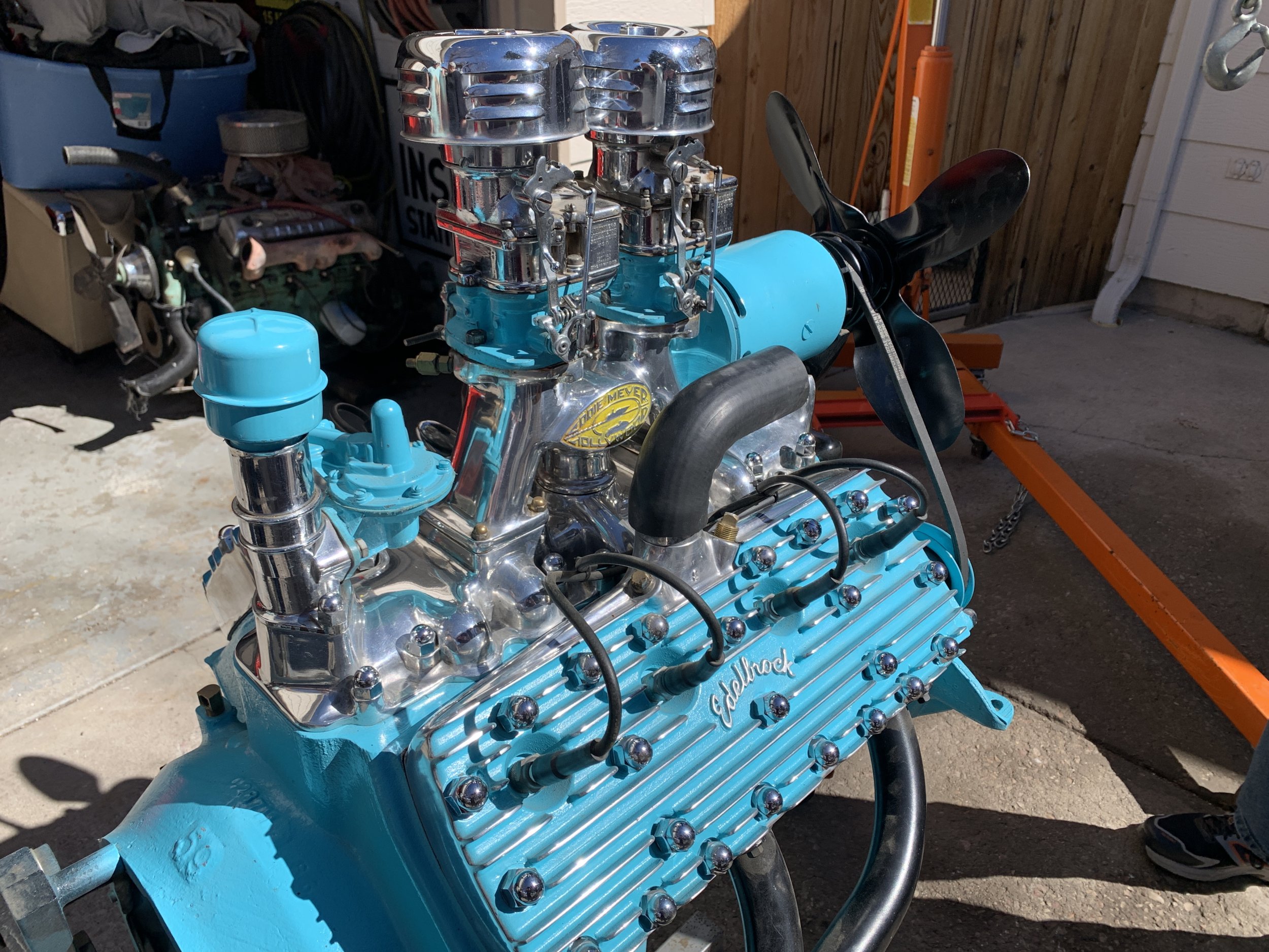

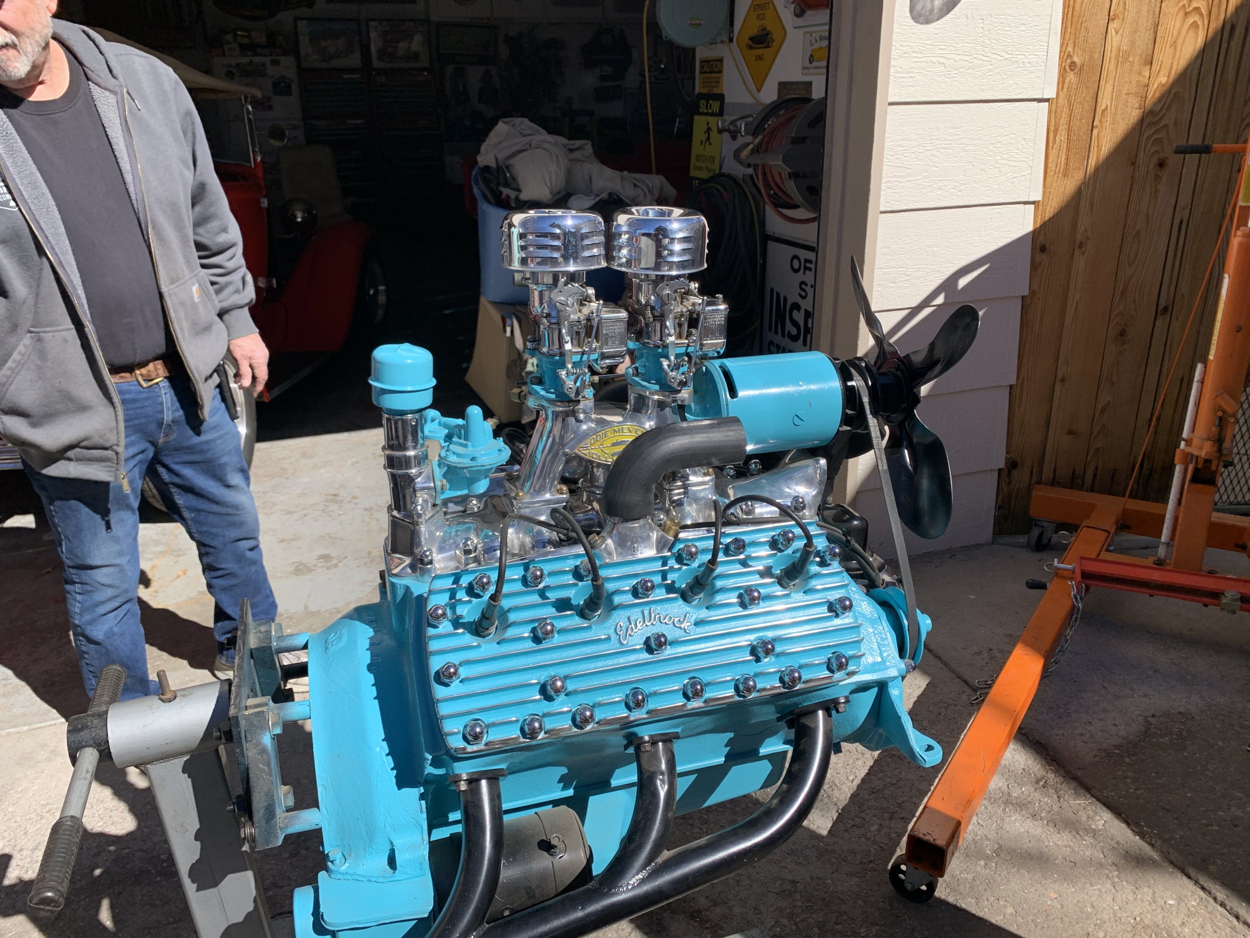

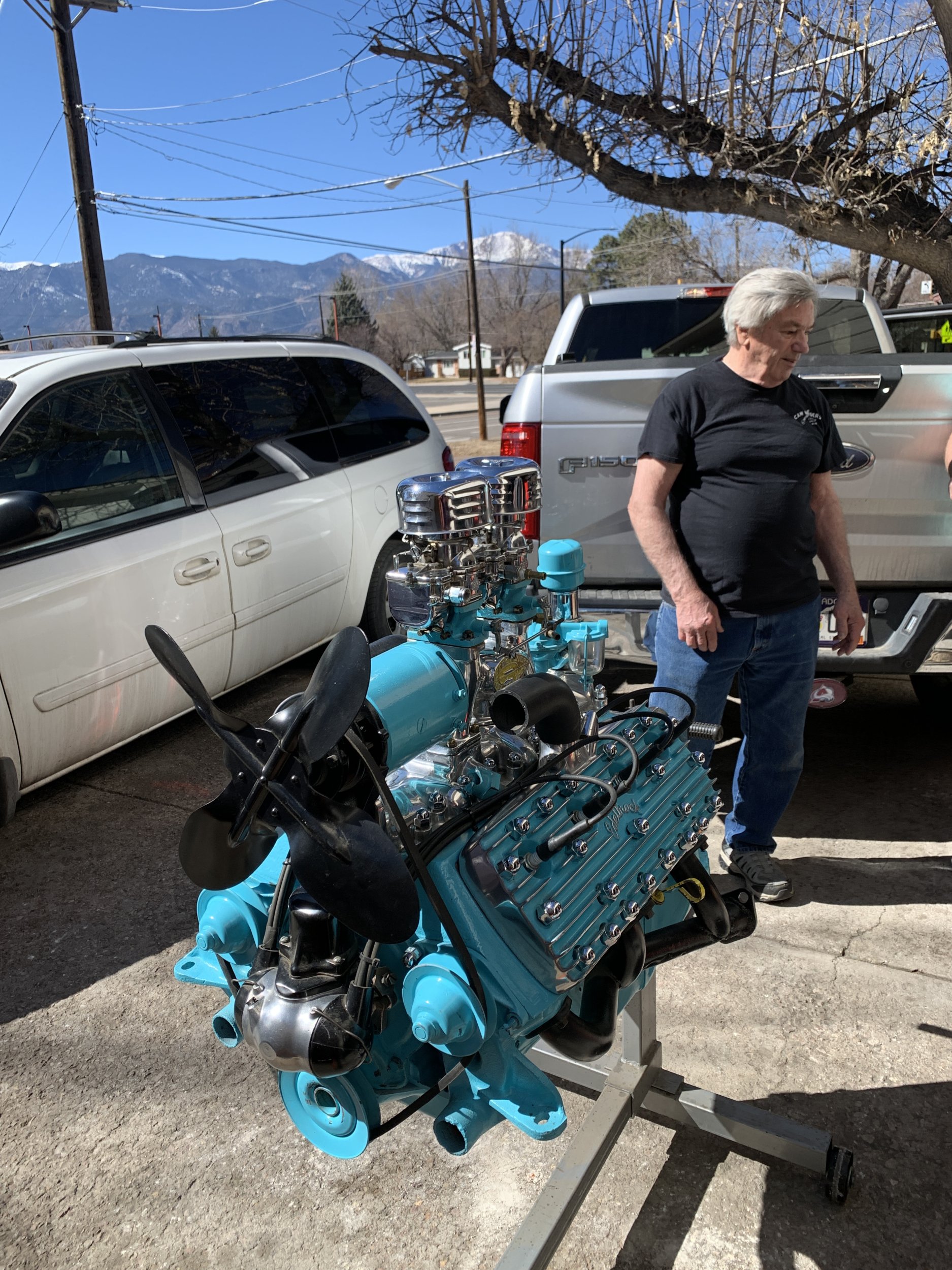

    That is exactly how the Eddie Meyer intake in question works. There is a hollow casting under the carb risers. It has a water log manifold that attaches to this or you can block them off. Traditionally, guys would plumb into one head and one of the water pumps to circulate the water. As you can imagine, this would be kind of unsightly in a car with an open engine compartment. In all my old timey books, I've never seen one of these intake hooked up to a hot water supply, but I'm ***uming guys did. I just never seen one done. You see them on cars in the pre-war books chronicling racing at El Mirage, Muroc, and other CA dry lakes events.
    My plan is to tap into the left and right heads to allow hot water to enter into this cavity. I'm thinking polished copper tubing to make it look appealing. I have a Slingshot on it now, but plan to eventually swap intakes to the EM.

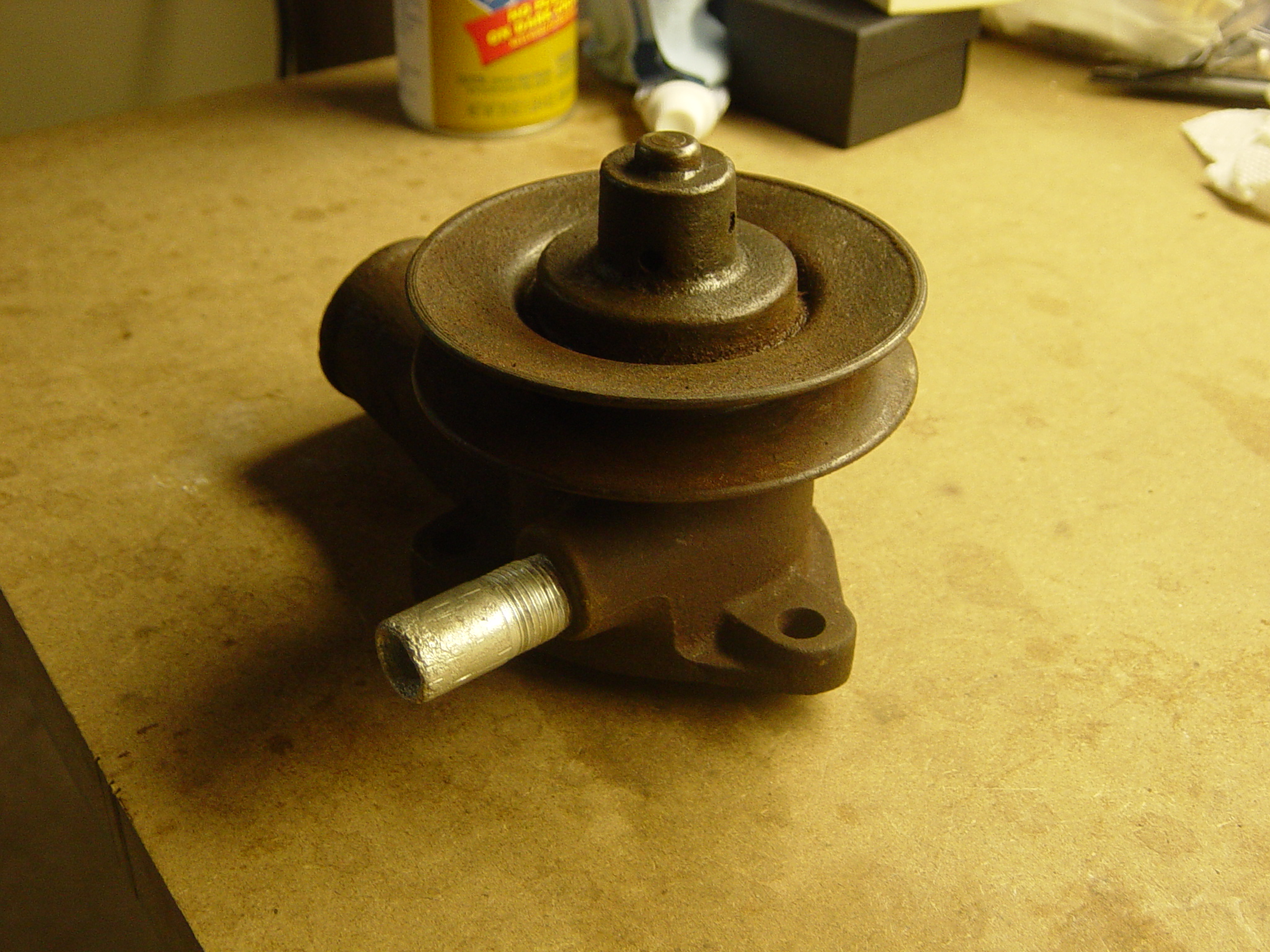

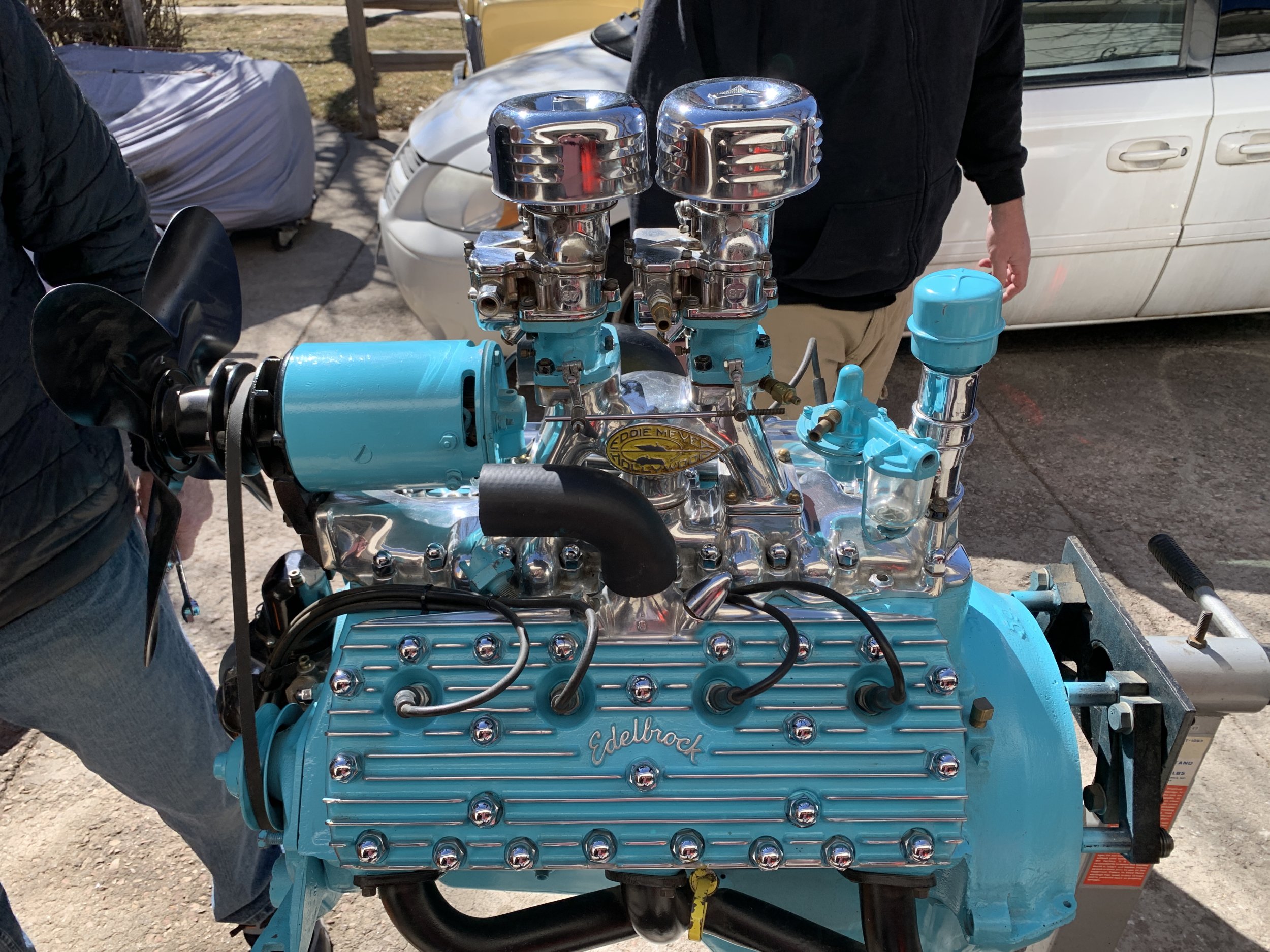

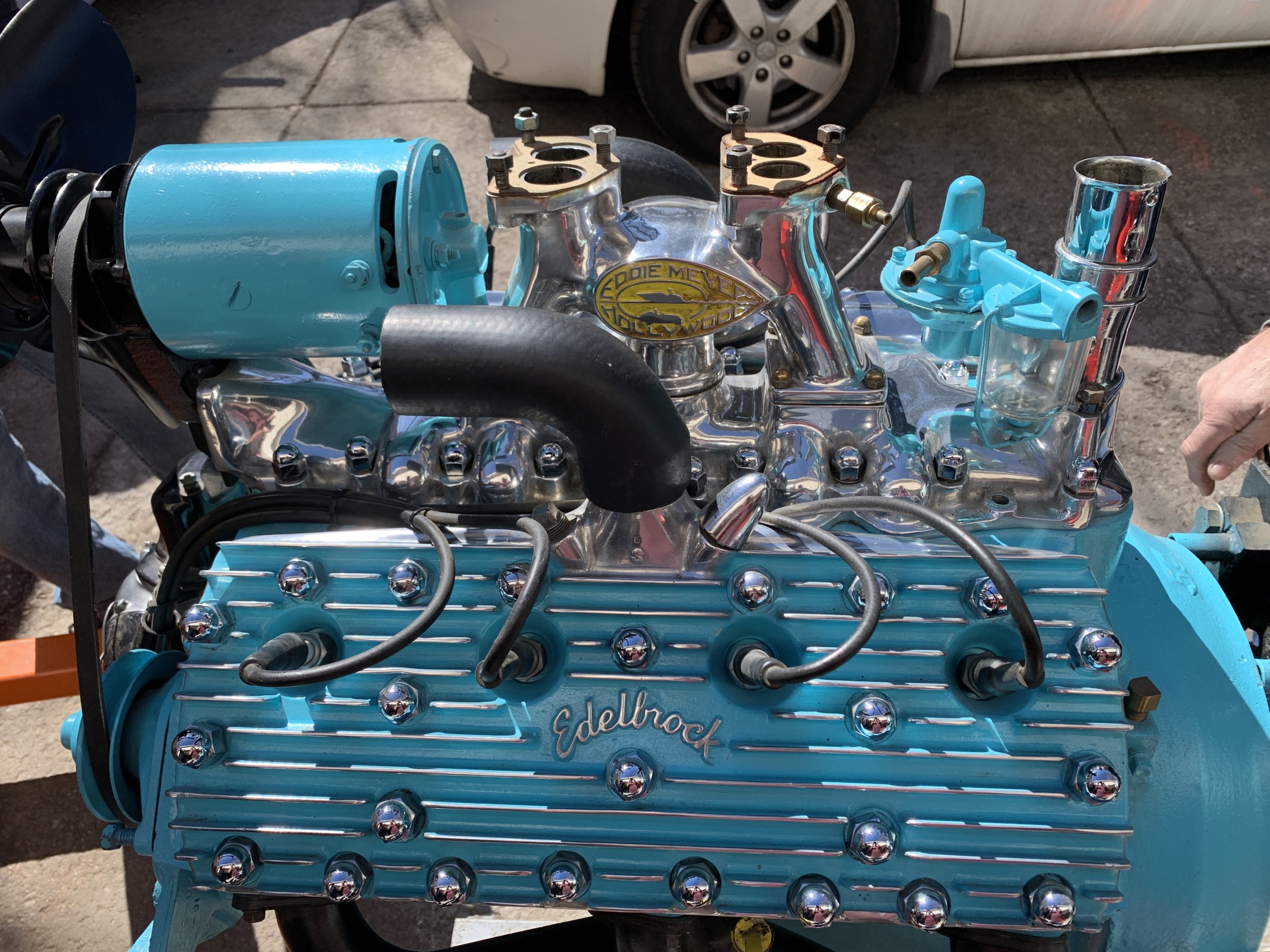

    The early EM Hi-rise used hot water from the cooling system. EM also supplied block off plates for use in hot weather after the car was warmed up. I have a Harrell that uses no engine heat and has the same icing problem on the street. Suggest the later EM that uses exhaust gas heat as above photos or pipe in the coolant. I wanted the coolant hoses to be as short as possible so I found an aftermarket RH water pump for my 21 stud it has two ******s cast into the body for a heater. Or some pumps have one ******.

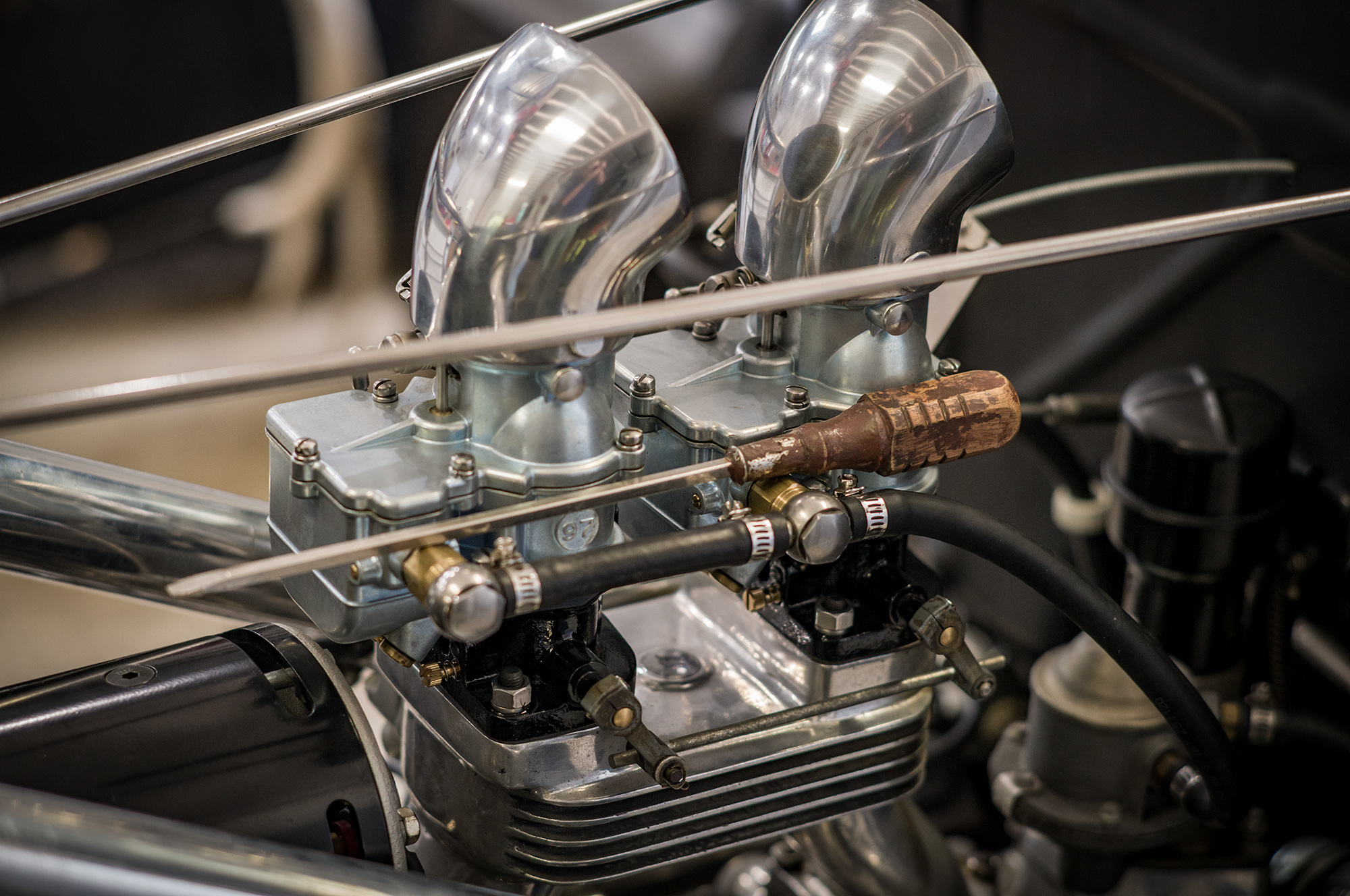

    Also... There's something super cool about tuning your hot rod with your grandfather's screwdriver.
    AeroCraftsman, e1956v, Tim and 3 others like this.
  19. Sharpone
    Joined: Jul 25, 2022
    Posts: 2,987
    Sharpone
    Cool, definitely a traditional screw driver!
