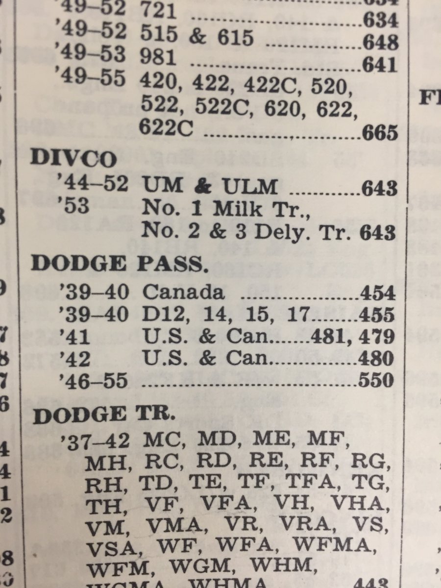

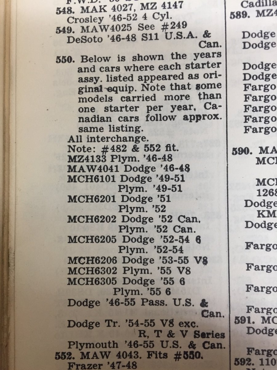

    Here is what the Hollander interchange manual says. it is their interchange number 550. Looks like they all fit
    VANDENPLAS and kidcampbell71 like this.

    he's looking for the ring gear, not the starter.
    hollanders says 41-55 dodge car fluid drive is one part number, but not the later ones.
    Moriarity likes this.
