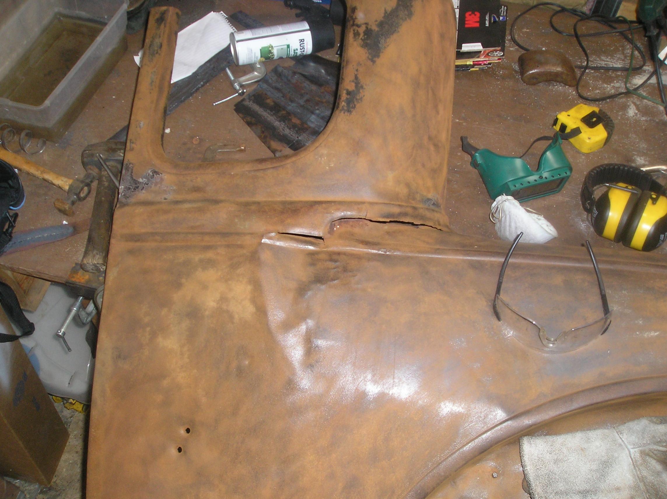

    Maybe its just me, but I'd like to see a patch for common stress cracks in coupe rear quarters. I know somone here on the hamb has recreated the bead using a pullmax, but a nice patch with the bead width transition would be super.
  14. M/H Speed and Design
    Joined: Dec 9, 2008
    Posts: 120
    i had the same problem on my coupe, i used a junk door skin for the reveals, and made a hammer form for the little cove in the back. Mine was cracked, and someone gas welded the cracks up, but didn't lift the body back up, so i had a lopsided roof. Vaphead here on the hamb sells the panels, just without the cove, i should have bought one of those in the first place. http://www.jalopyjournal.com/forum/showthread.php?t=467717&highlight=stress+crack

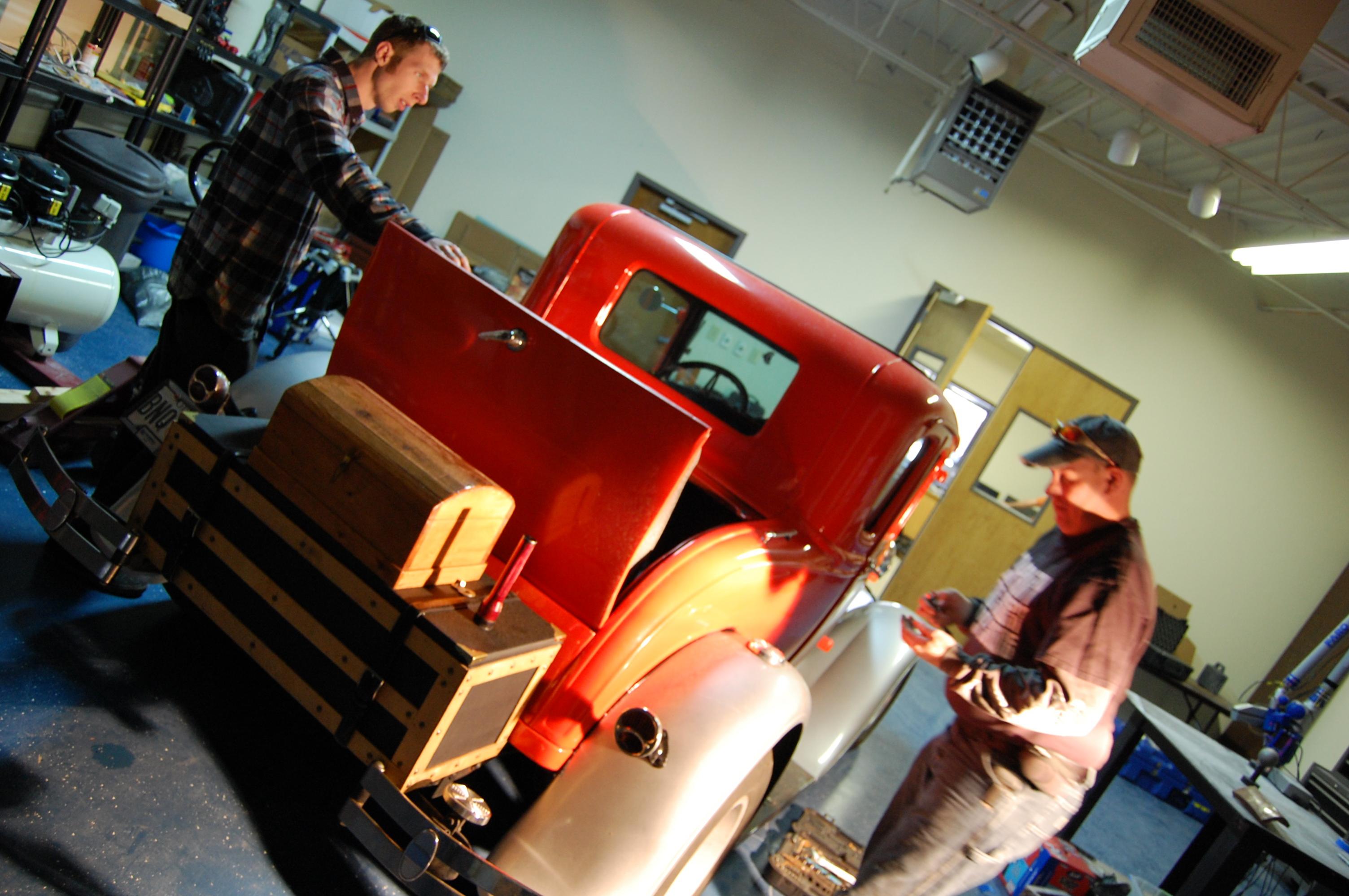

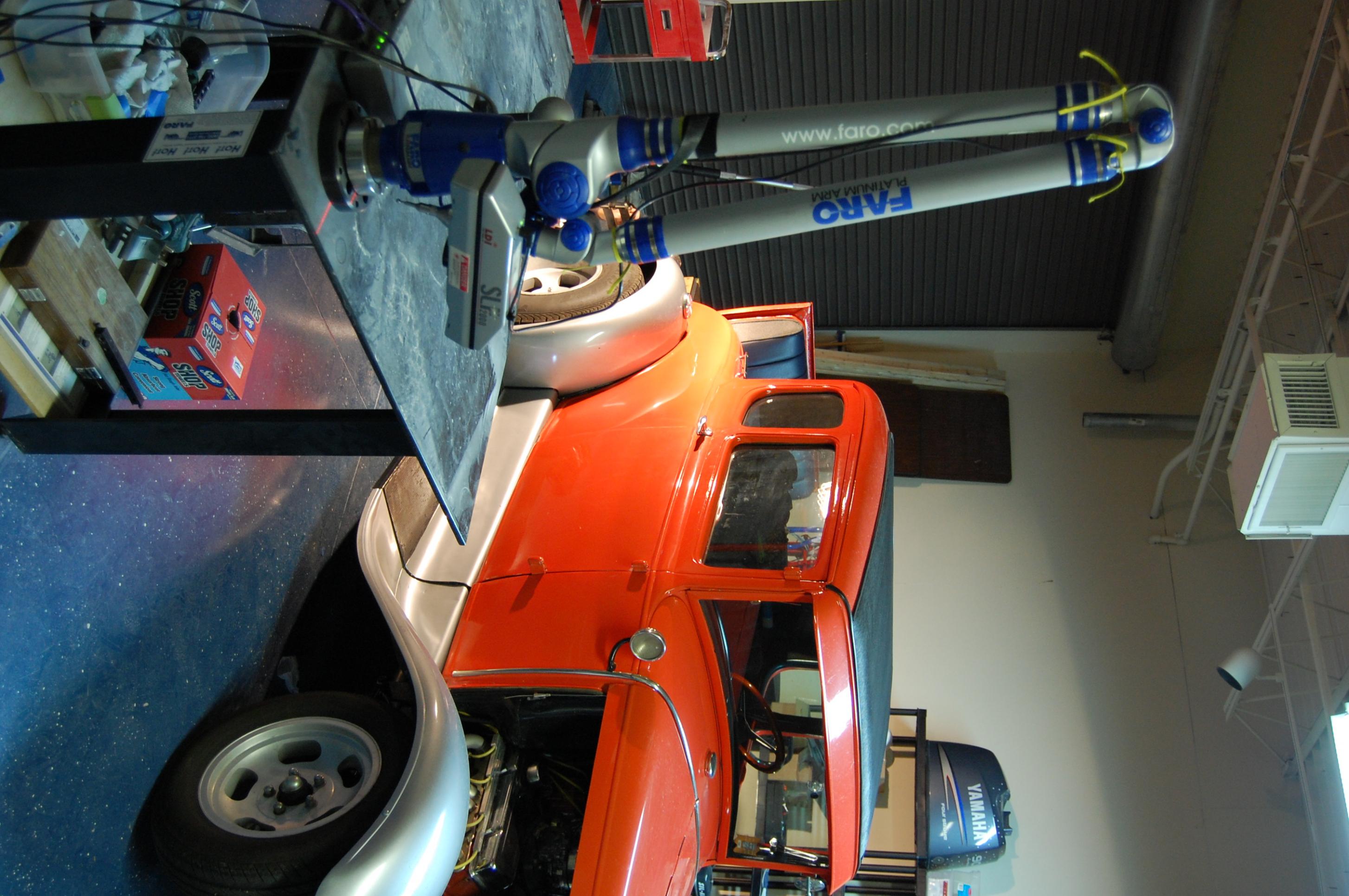

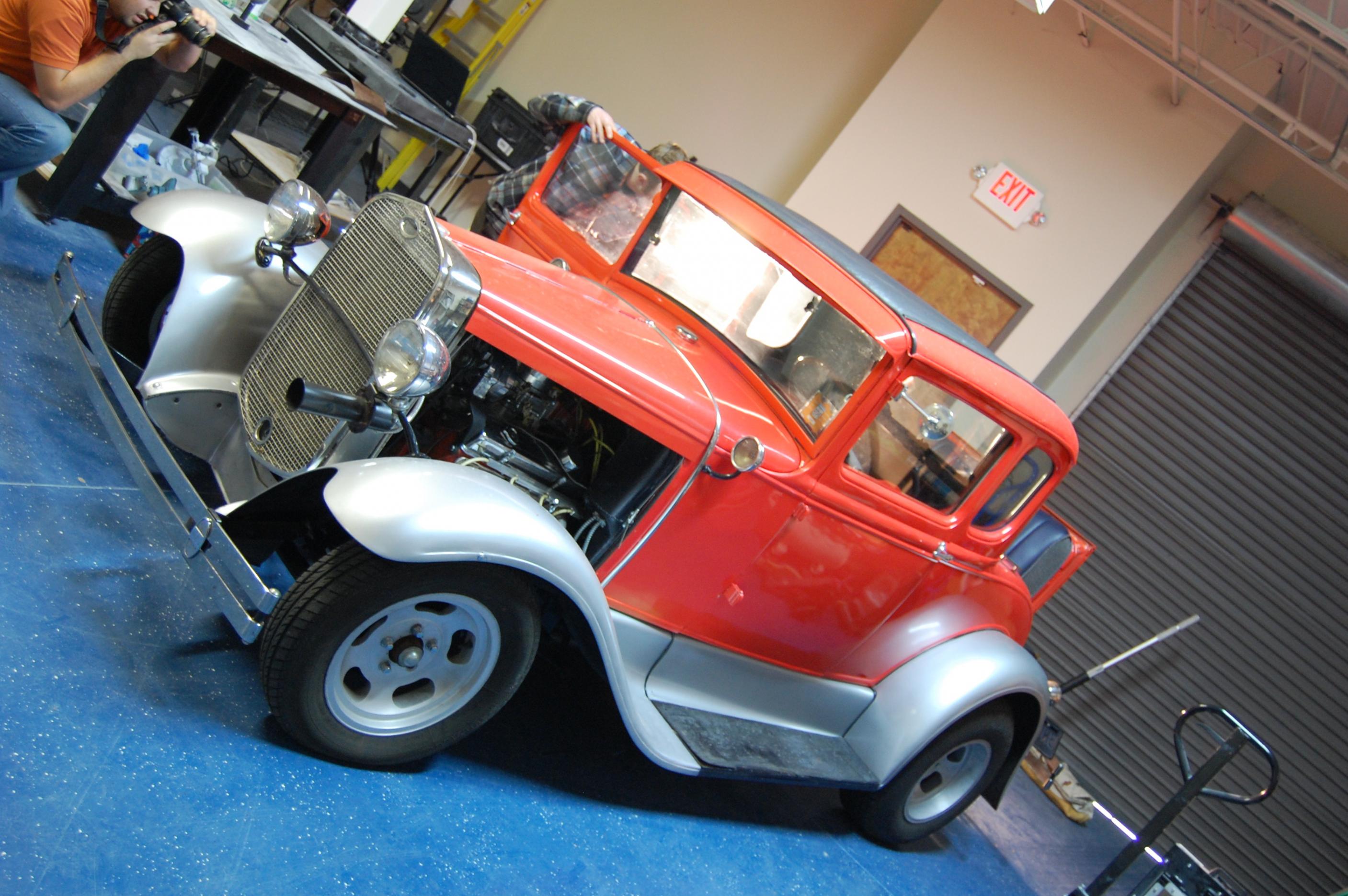

    Well we have a scanned and modeled quarter panel! What an day, we spent it with cool guys and $200,000 laser scanners. More about it and some pictures tomorrow. Stay tuned folks.
  20. M/H Speed and Design
    Joined: Dec 9, 2008
    Posts: 120
    Thursday was one exciting day, David and I left pretty early and headed down to GKS Scanning in Alpharetta where Tim was meeting us. We had a mini scare when we noticed there was no roll up door that we could see. Darin, our scan tech, answered the door and calmed us down when he showed us the door out back. Situation diverted. Tim and his wife showed up in the A like some troopers, all the way from Cartersville, Ga to Alpharetta in Georgia rush hour traffic. He is the man to say the least. Most people that we talked to freaked out about the idea of pulling off a fender. Tim builds everything him-self, and drives them too, so needless to say, the fender was on the ground before we knew it. Darin put some Talc on the quarter to smooth out the reflectivity of the panel, and rolled the laser over. Basically, this couple hundred thousand dollar laser is moved over the panel, and a 3d view is gathered on the monitor, almost like some kind of video game. It's pretty funny, were scanning these 80 year old parts with the latest and greatest technology. I guess that goes with our idea of a nod to the past, with a wink to the future. I'll let the pictures tell the rest. All in all Tim has been awesome, a true example of how gearheads should all be. He was all about helping in a common cause to make parts that everyone can be proud to use and make their projects more enjoyable. Keep an eye on this thread, we'll keep everyone involved as we go through this adventure!
