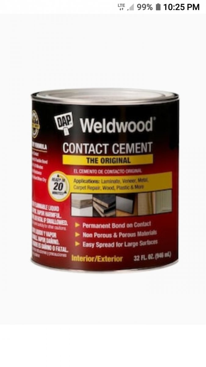

  7. I get it at ace hardware, Lowe's sells it also. Get you a pack of those cheap *** brushes also. Screenshot_20201221-222513_Samsung Internet.jpg
    Krash Vegas and olscrounger like this.
  8. I dip the brush in the glue and swirl it around, slinging the glue on the workpiece in circles, then smooth it out. Cover both pieces. Let it dry to a good tack, line it up and stick it. Rub it down good, flip it over on a clean surface, and brush some glue on the back side about 2" on the doorboard and the cover. Let that tack up, roll it and stick it. Trim off the excess. Serve with a cold beer, serves 2 :D
  9. Oh, and i like to use the industrial velcro tape to secure it. With the 2 pieces of velcro stuck together, stick it to the door panel. Clean the door, line up the panel and press it in place. Then all you've gotta do is pull the velcro apart to remove the door panel

    Thanks, this worked well for me!!!!
