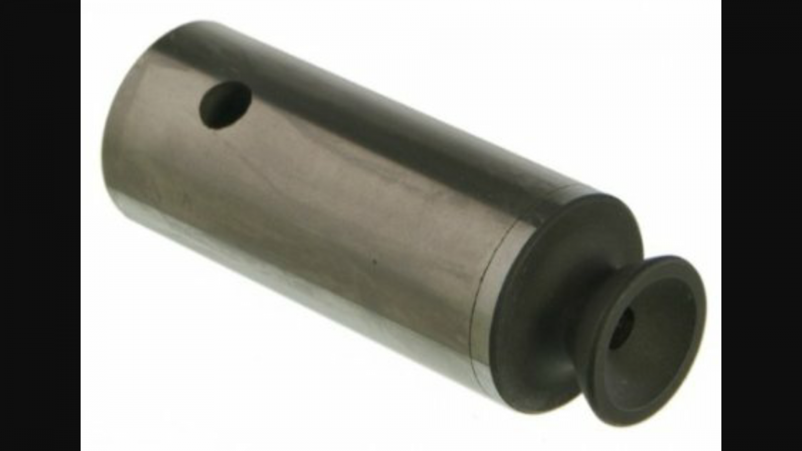

  7. gas pumper
    Joined: Aug 13, 2007
    Posts: 2,964
    gas pumper
    You should show these guys a picture of the lifter. Some of them think you have a modern style lifter. You have a tall lifter that's known as a bottle style. It is hollow and does have a pressed in top. If you try and use a short modern solid body you need to change the pushrods to longer ones.
    Yes these are very expensive because only the old Chevy's and GMC sixes used them and there is little demand for them. You can get singles on eBay. There are also two different ones. One for steel cams and one for cast iron cams. Research this as you could have either one in your engine and you can tell by looking at the gear that drives the distributer.
    The normal break in will work if you get a new one.
    Your best bet would be to do like you have been doing and just push it back together and run it. It can't fall apart while running under normal conditions.
    Frank.

  10. StefanS
    Joined: Oct 7, 2013
    Posts: 1,350
    StefanS
    from Maryland
    Screenshot_2015-05-01-09-09-03.png This isn't my lifter but one I found on google. This is the style I have although I don't remember seeing a hole towards the bottom when I pulled them out. Mine is split exactly where that line is but I only saw it on the one in question, none of the others had a noticeable line. My donut gasket between my manifold and head pipe isn't quite sealed (I got tired of messing with it and gave up). Could that be causing the backfiring and will it screw up any valves driving like that until I get around to fixing it?
