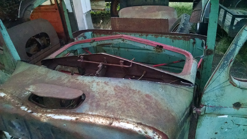

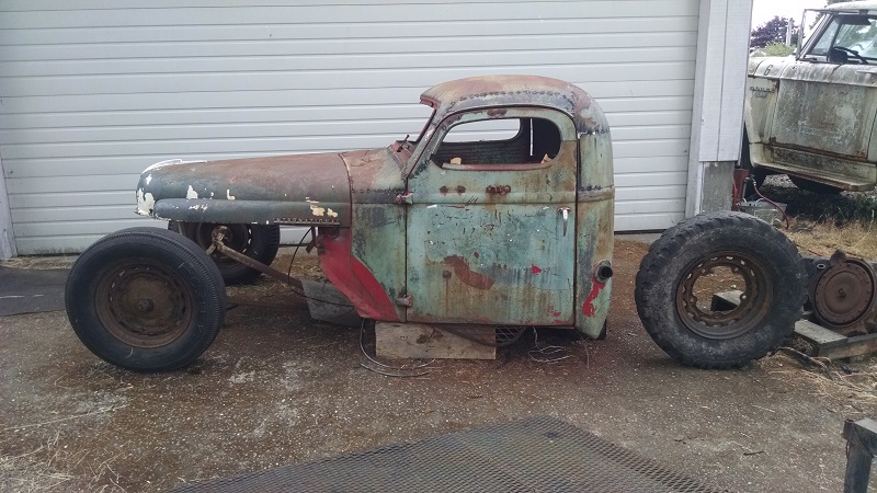

    I just got a 41-49 K or KB International cab and hoods from a friend. I decided to chop it a total of 7". 4" at the door window opening and 3" above the door. The before picture shows how fat the roof looks and by observing other chops of these trucks I wanted to get rid of the fat as it looks fatter when the windows get smaller.
    This chop is a bit more difficult than some because it has an inner structure skin that needs to be dealt with. This is my first chop and I like a challenge so here go's. I removed the rear window opening and the inner skin. Next up I removed the outer skin by cutting right above the windshield and 3" above the doors to let the top drop and down to the belt line removing the skin in one piece.
    IMG_20150620_221352293.jpg IMG_20150705_201752520_HDR.jpg IMG_20150705_194912227_HDR.jpg IMG_20150705_201741091_HDR.jpg IMG_20150705_204533966.jpg IMG_20150705_204550143.jpg

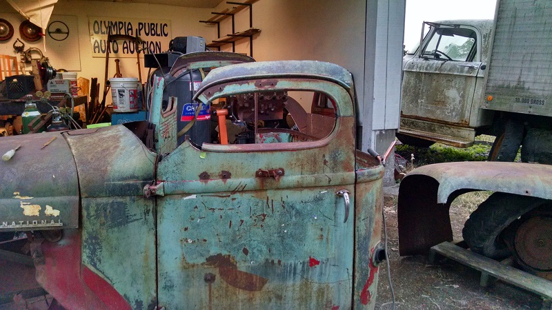

    Most chops I have seen on these trucks end up with oval side windows and a fat roof. Both of which will be addressed in this chop. Most chops start with lowering the lid and then making the doors fit, I will do the opposite. After removing the roof and x bracing the cab I cut 4" out of the door tops at the rear and cut the front in the middle of the transition at the front of the door top. I then tacked the rear potion of the door top back on being sure to line up the window channel area.
    The next step was to remove the windshield and dash as a unit. I then cut the door post at the transition at the lower corner where it would be leaned back. This took careful planning to make it flow with where the windshield would be leaned back. I cut the top of the door opening at the front where there was a seam and at the back where it met the belt line and then fit it to the door top. IMG_20150706_204312974.jpg IMG_20150706_212212771.jpg IMG_20150707_205747421_HDR.jpg

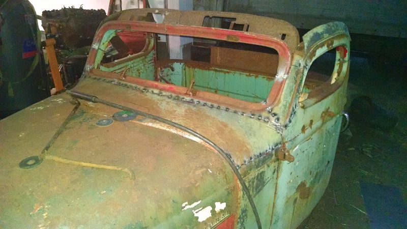

    I then fit the wind shield and door post to get the slope right and figure how much to take out of the windshield height. I tacked it all back together making sure to line up the door window channel because gl*** does not bend or twist. When the doorpost leaned back it got wider at the top because the doors taper out at the rear. With the windshield tacked in place it became apparent that it needed to be wider at the top.
    At this point I cut the wind shield top off inside the windshield post and cut 2" out of it. I then cut the lower corners and pulled them out a bit to line up with the door tops so the doors will seal. From the front it looked like the windshield was peaked up too much in the middle so I cut it and lowered it about 5/8" causing the sides to be wider and lining the posts back up. IMG_20150707_205836874_HDR.jpg IMG_20150707_212544348.jpg IMG_20150708_211404731.jpg IMG_20150712_204530714_HDR.jpg

    After getting the windshield and door posts to fit it was on to fitting the roof skin. I cut 7" off of the bottom and about 2 1/2" off above the windshield. I had to cut out the back corners of the roof so that the sides were free to flair out and meet the 3" pieces I left above the door openings that were bent in to meet the roof skin. I used clecos to hold these together while I tacked the front edged of the roof and the back down by the belt line.
    After it was held in place I removed one cleco at a time and cut the roof to match the sides and tacked it as I went. Then I had to install the cab corners and move them out 1" adding a filler strip. IMG_20150708_211918477.jpg IMG_20150708_211927330.jpg IMG_20150714_213919299.jpg IMG_20150725_205455895_HDR.jpg IMG_20150725_205455895_HDR.jpg IMG_20150805_062309984_HDR.jpg IMG_20150714_213919299.jpg
