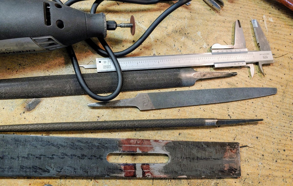

    I wanted the alternator as low as practical.
    This simple mount combines ideas from @D-Russ , @scotty t , & @alfin32 . Thanks, guys.:cool:
    A double sheer "pivot piece" is made of 1.5" x 1.5" angle. It attaches to the motor mount/frame bolt.
    1/4" thick pivots added. One tapped with a 5/16"-18 threaded hole
    A slotted "belt tensioning piece" is 3/16" plate.
    The alternator is from a Suzuki Samurai; ACDelco #335-1271, generating 55 internally-regulated amps.
    Belt is a Dayco #15460.
    Lightening holes make everything look faster & cost just a little time.
    They also improve quarter mile ETs, gas mileage & reduce carbon emissions. ;):rolleyes:

    Something satisfying about hand filing a slot like that in metal.
    looks great!

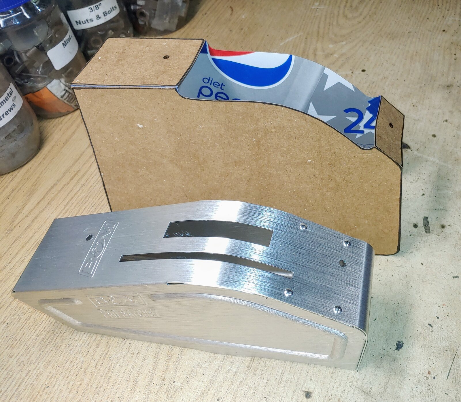

    The "Otie's Automotive" Fiat Fuel Altered inspired my shifter... with help from some '60's G***ers' B&M "Series 60" shifters & @toxictom 's console.
    otie 05.JPG otie int2.jpg 013 studebaker lark gasser shifter.jpg b&m series 60 04.jpg pedal moon 99.JPG diamond hrxp-1205-1941-willys-coupe-restored-gasser-003.jpg vanderhook 02.jpg toxic 02.jpg
    But I'm limited to ~2.5" max width due to the close-together, tip-forward seats & huge trans tunnel.
    Also, comfortable ergonomics & a gear position indicator are must-haves so Wifey can drive it.
  16. Just Gary
    Joined: Oct 9, 2002
    Posts: 5,829
    Just Gary
    The results:
    A homegrown 1/8" steel bracket attaches to the trans tunnel.
    The bracket is slightly offset toward the driver, raising & rotating a new B&M shifter so it's within easy reach.
    A traditional-ish housing encloses it.
    The guarded toggle switch enables 4th gear lockup.
    Paint & powercoating will follow later.
    :cool:

    I could see the sides with a pinstriped panel with engine turning in the panel itself. Looks good man
  20. mad mikey
    Joined: Dec 22, 2013
    Posts: 9,459
    mad mikey
    Love the shifter Gary.:) Very nice.;)

    M/T knob is cool.
  23. mad mikey
    Posts: 9,459
    mad mikey
    Yea! The M/T knob is killer!;) Are you almost ready for a test drive? :)
