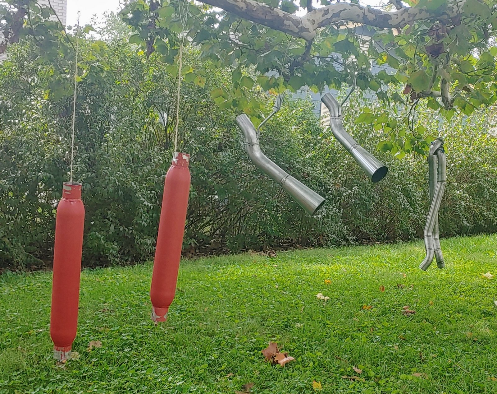

    1) @ol55 , a fellow Cl***ic Chevy Club buddy, donated a pair of "old-chrome-but-I'm-painting-'em-black-anyway" exhaust tips. Thanks, Larry! :)
    Hi-temp exhaust paint:

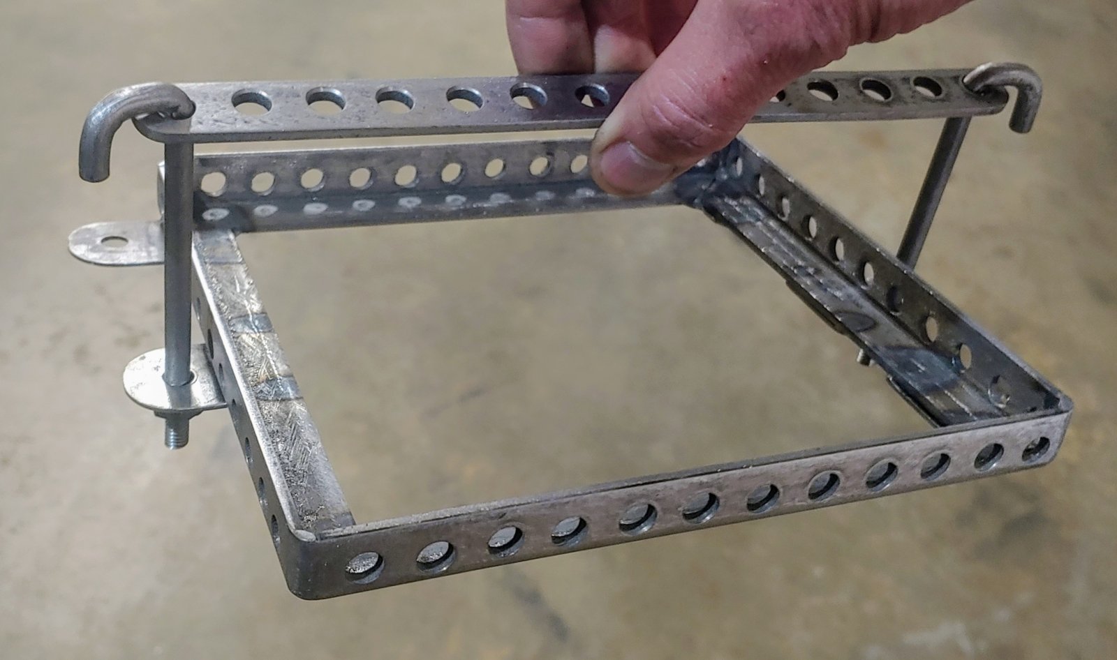

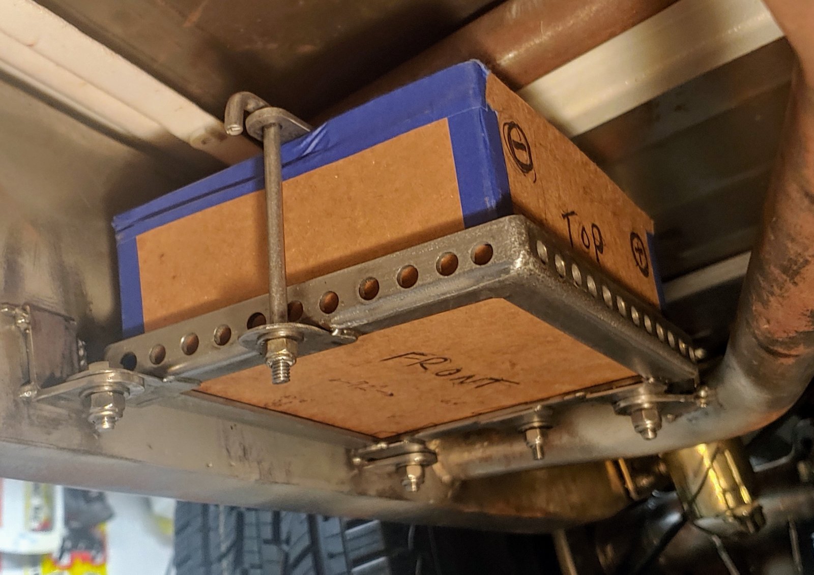

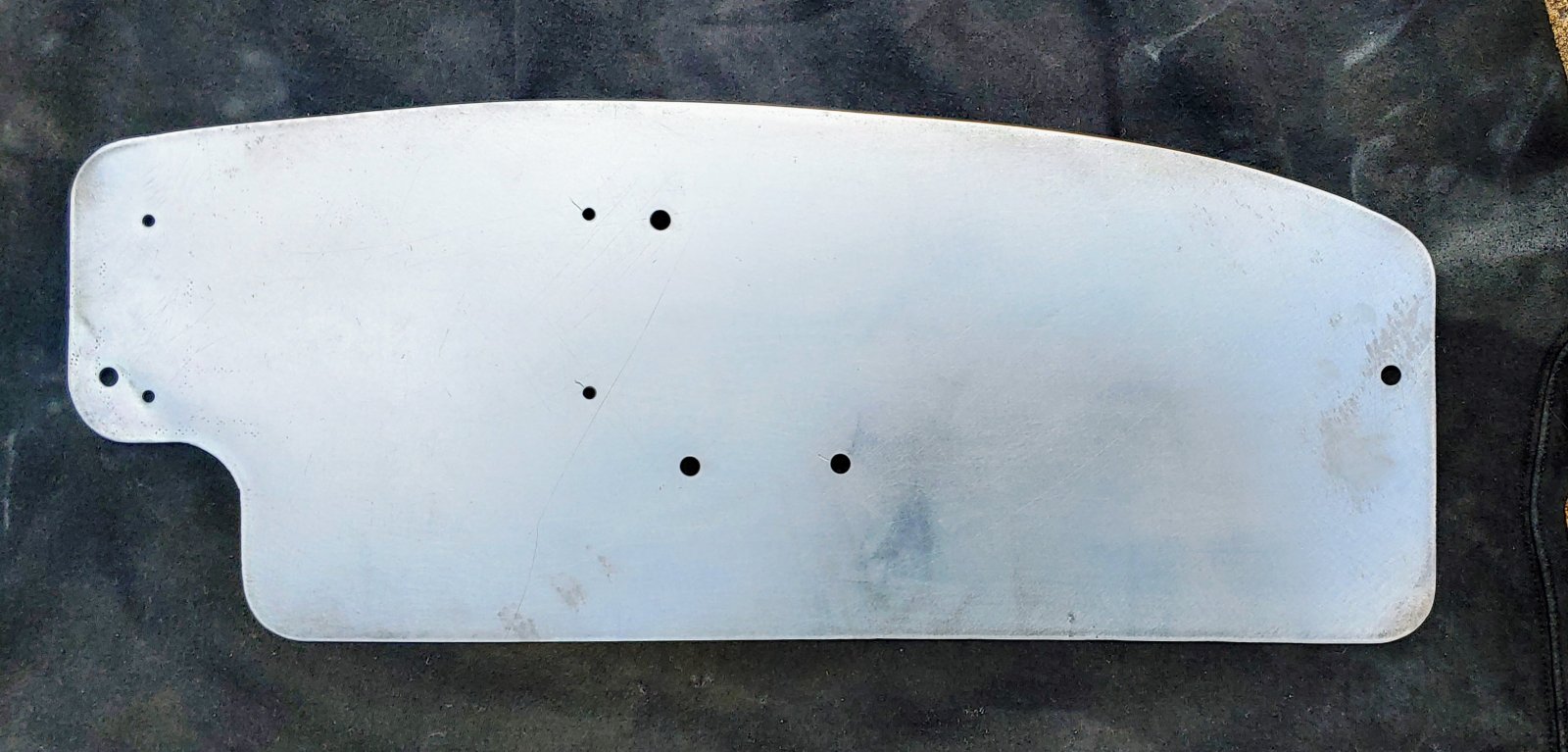

    The battery box is 0.75"x 0.75" angle, sized for an Odyssey 680.
    It fits under the rear p***enger floorboard. Frame tabs are 1.5" x 1.5" angle.

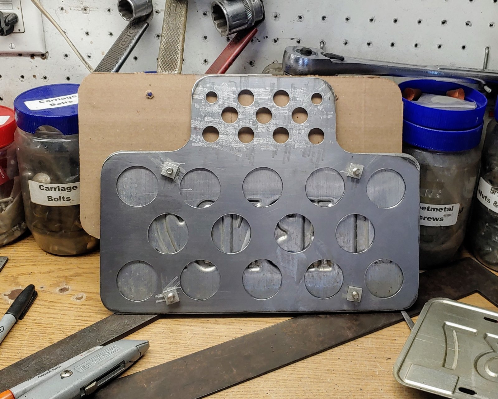

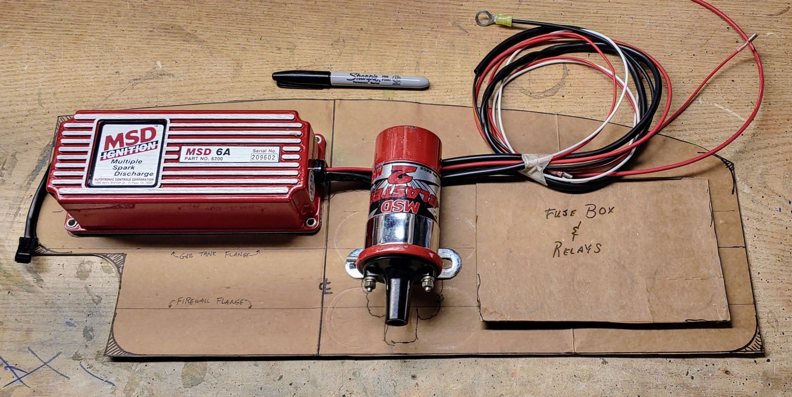

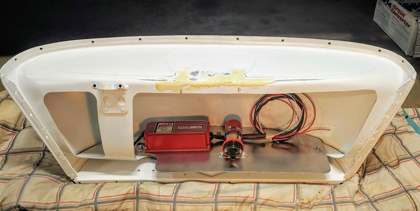

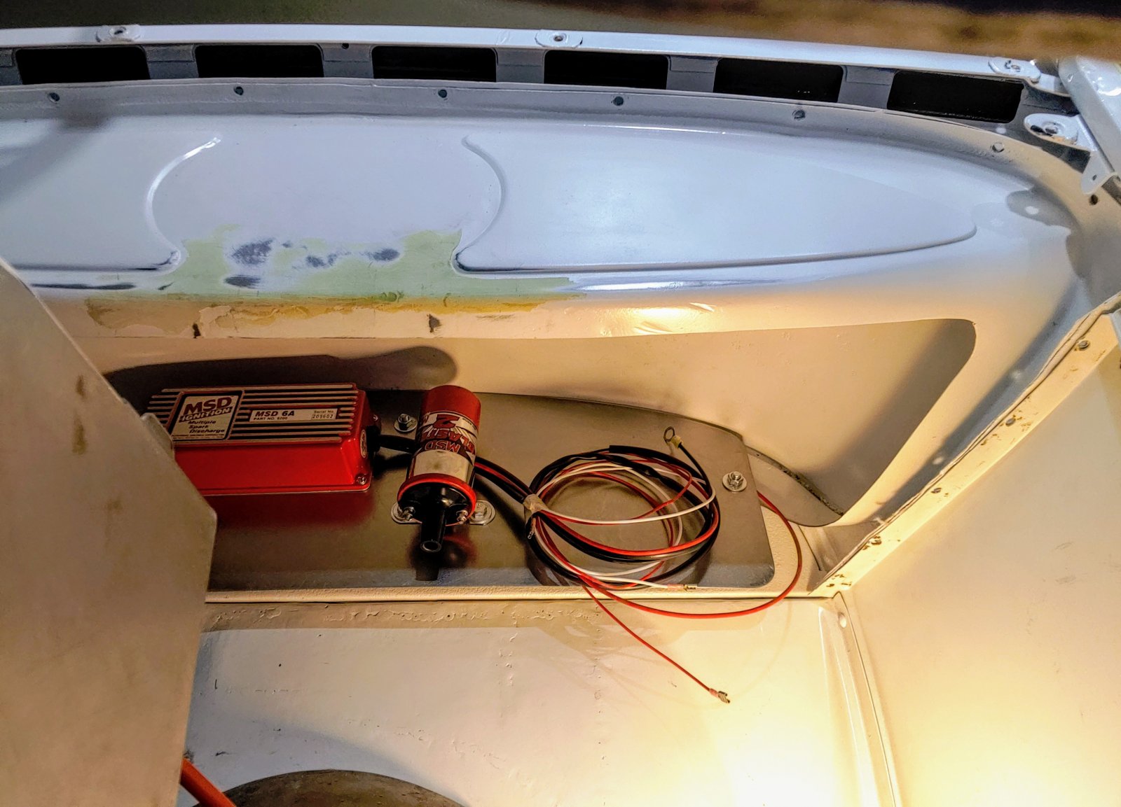

    I also made an easily-removable under-dash electrical panel.
    There's room for an MSD box, coil, and fuse panel, with extra space for relays, USB ports & future growth.
    It's just 20 ga steel...
    ...and bolts to what's left of the stock gas tank.
    Insulation will fit in the 1" gap between it and the stock firewall. :)

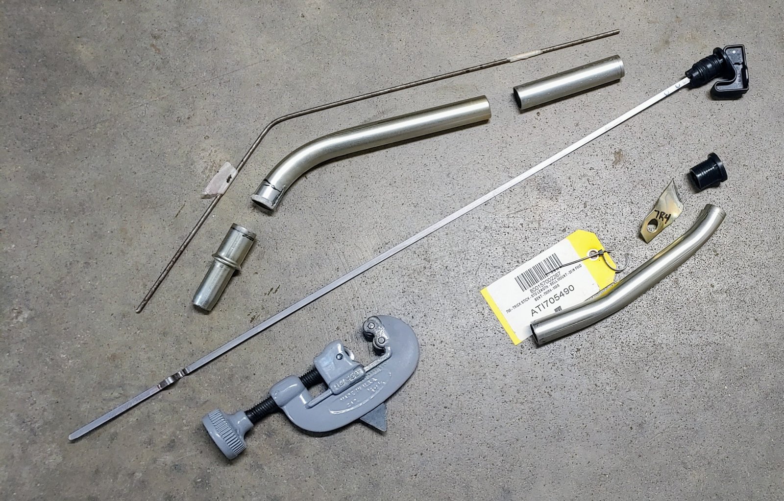

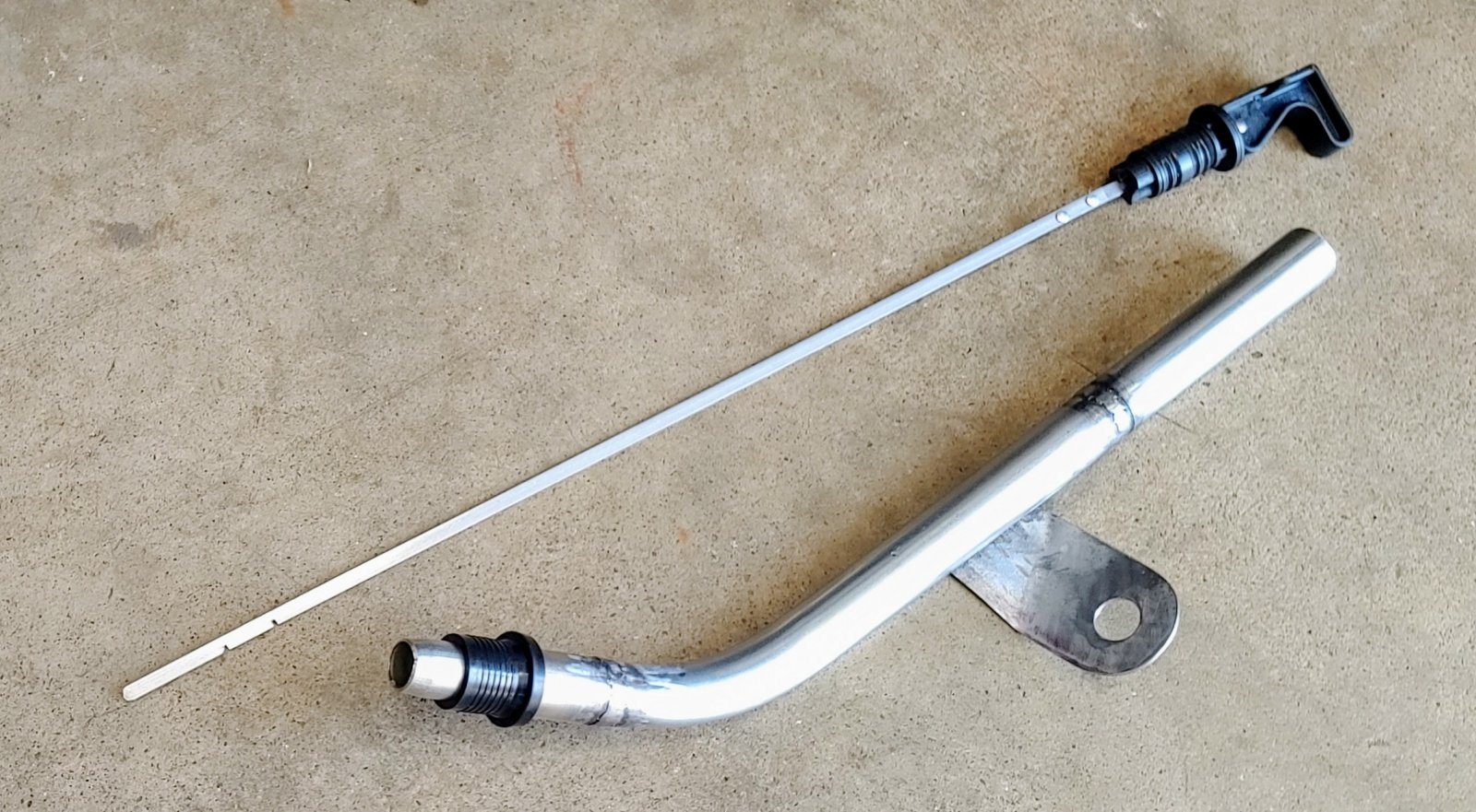

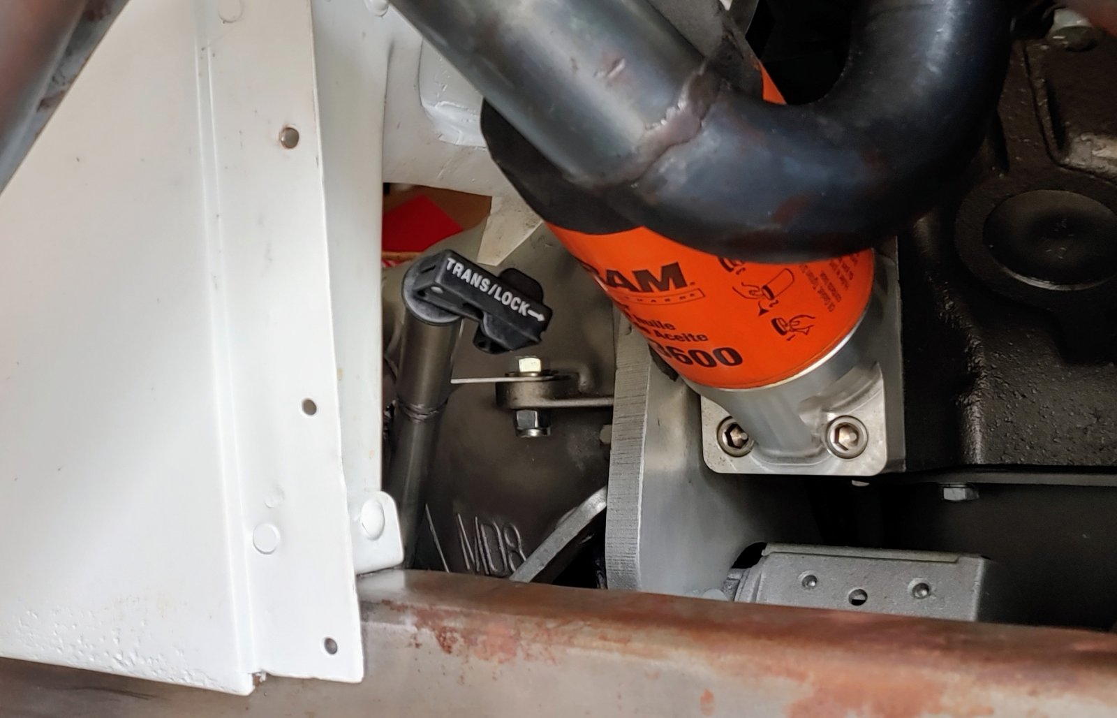

    NHRA requires a locking dipstick & securely fastened fill tube on all automatic cars running 10.99 (6.99 1/8 mile) seconds and quicker.
    I'm nowhere near that quick, but thought adapting one might be wise.
    "Hack hack!"
    I ground off the gold iridite coating wherever I'd be welding; then fine-tune my MIG settings by practicing on the tube s****s.
    The spring steel dipstick got trimmed & new high & low level notches added.
    The tab bolts to a convenient transmission case lug.
    Snug fit but functional; and simple. :cool:

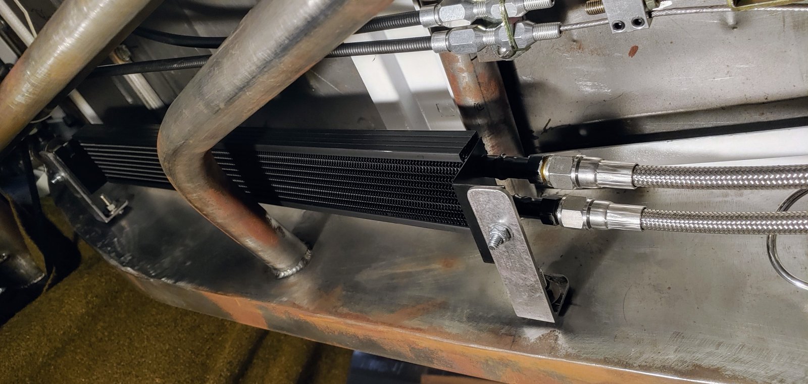

    Finally, I've laid under this car with a tape measure & cardboard cutouts for hours, wondering where to squeeze in all the components.
    The last puzzle piece was a 24" "tube & fin" trans fluid cooler, attached to the driver's side frame rail, well away from the exhaust.
    Brackets allow lots of air flow all around.
    5' long hoses might also give a bit of cooling capacity.
    -6 AN fittings. Go Navy! Beat Army! Ha ha! :D

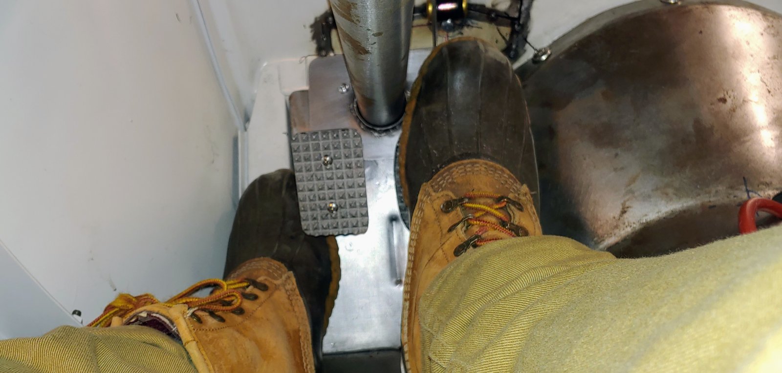

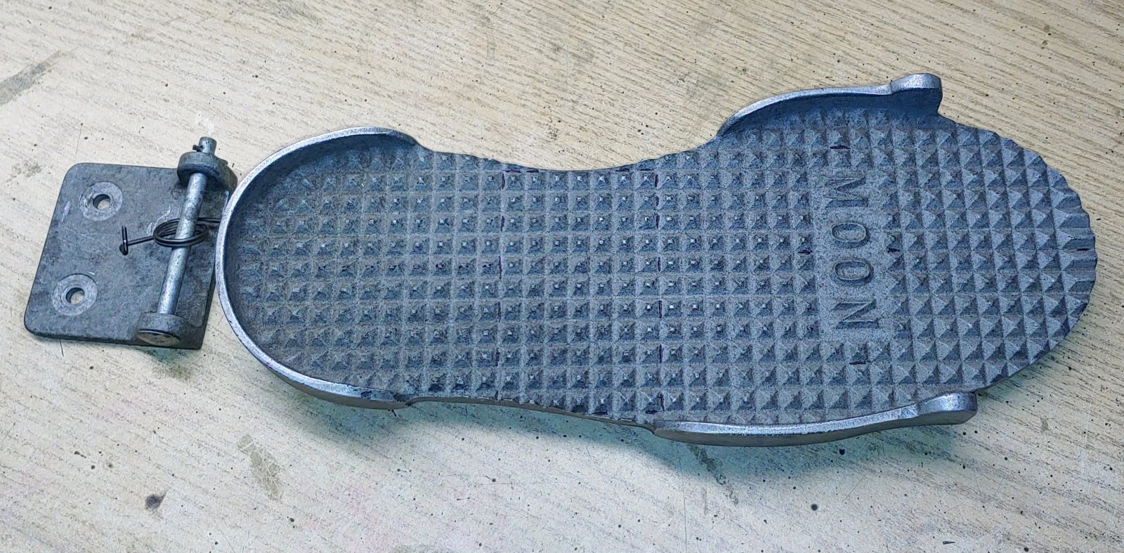

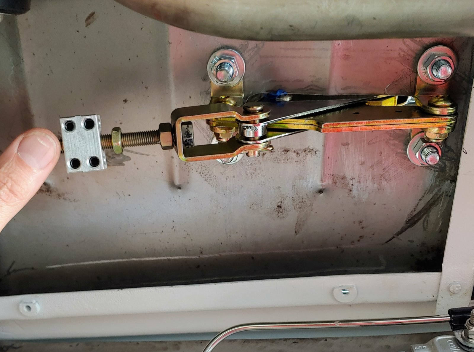

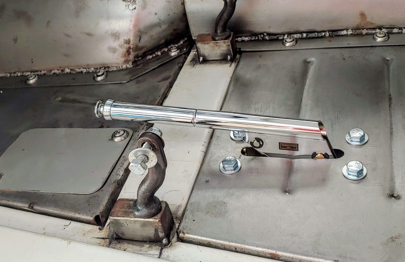

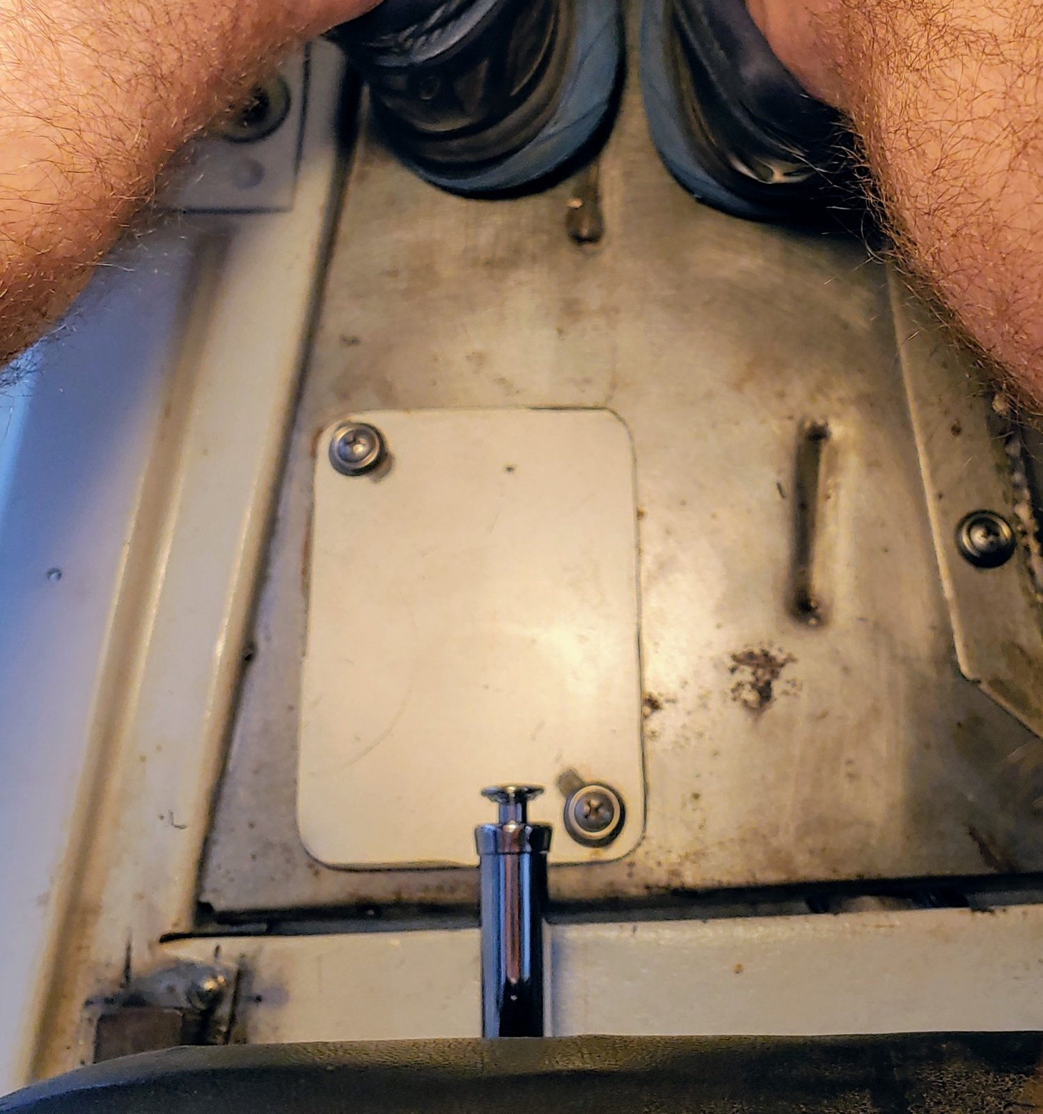

    Foot-shaped Moon, Cragar & Cal Custom gas pedals were common on mid '60's drag cars.
    A skinny rectangular Moon pedal would've fit the narrow footwell, but I carved up my cherished swapmeet piece instead. :oops:
    The top piece screws into aftermarket linkage.
    Despite measuring a zillion times, my firewall mounting holes weren't quite right so I welded them up and redrilled 'em. I also added fender washers on the engine side of the firewall to prevent wobbling.
    The bottom "heel cup" bolts to the floor where my foot naturally falls. The bracket flexes a bit so no hinge is required.
    Finally, the leftover middle piece underwent "gender re***ignment surgery" to become a brake pedal. :eek:
    A 1/2-20 bolt threads into the P&J brake arm.
    Everything fits comfortably & functions beautifully. :)
    Even wearing Bean boots (it's 40* F in the garage).
    Thanks to @Dino 64 for being my sanity check.
