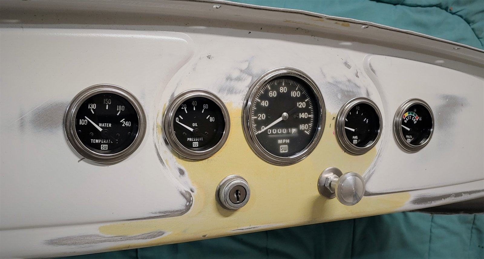

  18. This car demanded SW Deluxe instruments.
    My NOS speedo sidesteps their modern ones' unreliability. The others are new.
    The 0-90 ohm gas gauge matches the tank's sending unit.
    To keep the holes perfectly round, I clamped plywood behind the dash. Then, after drilling pilot holes, I replaced the hole saw's center bit with a metal rod.
    Basic switches. Bezels are 1.25" stainless steel fender washers.
    Racecar spartan.:cool:

    Always great to see your work. What is the metal rod in place of the drill bit for?

  23. Hi Larry!
    If the drill bit is retained & your drill wobbles, the bit's flutes will wallow out the pilot hole slightly so its bigger & the hole saw cuts a bigger hole. :(
    The metal rod has no flutes, so it just spins harmlessly in the pilot hole, keeping the hole saw precisely where you want it.:)
