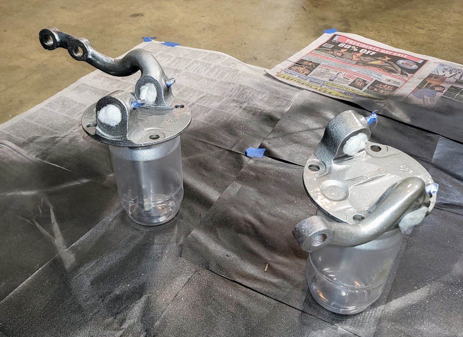

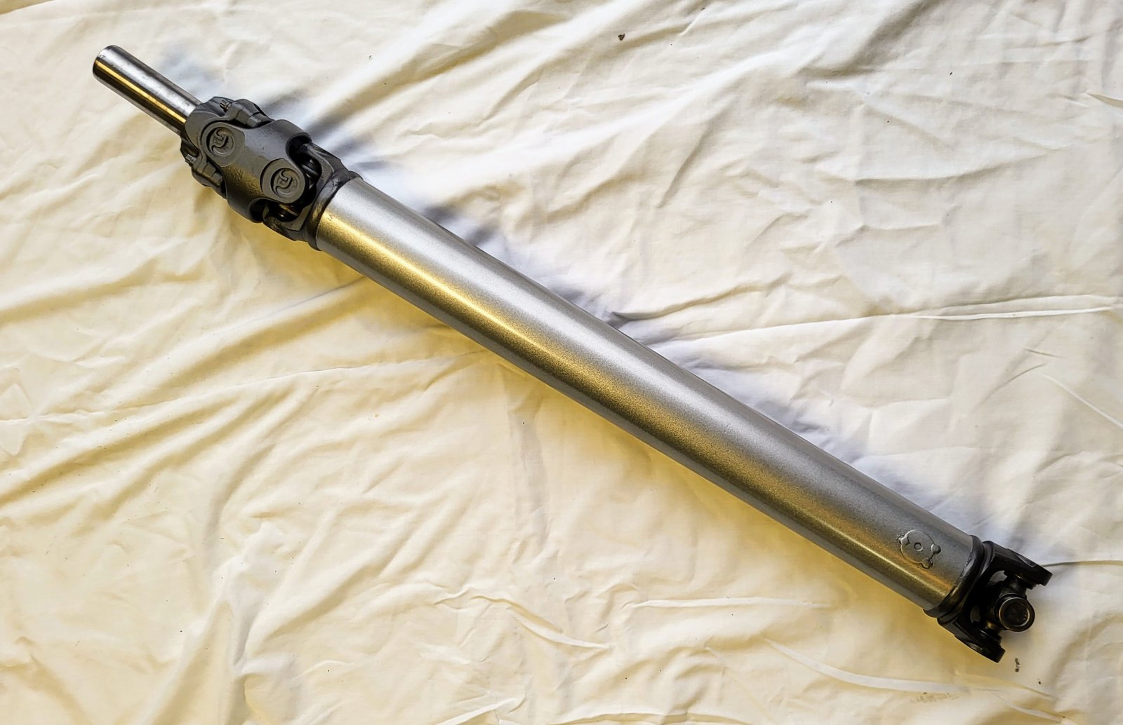

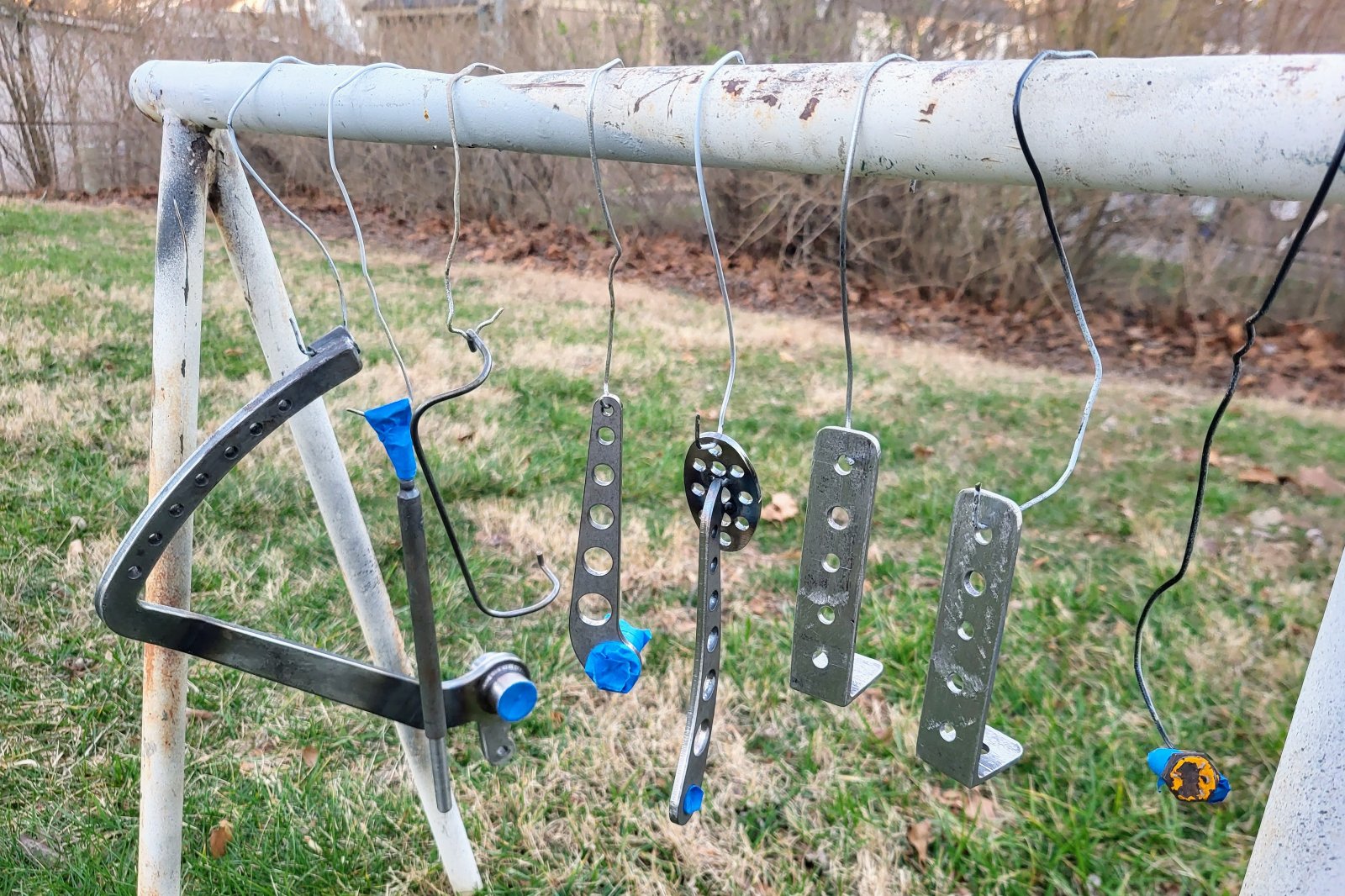

  2. Took a break from bodywork to finish weld the last few brackets.
    And detail the drivetrain.
    More rustoleum flat antique nickel metallic.
    I'd already sprayed it on the front wheels because it matches the ET III rear wheels' paint. :)

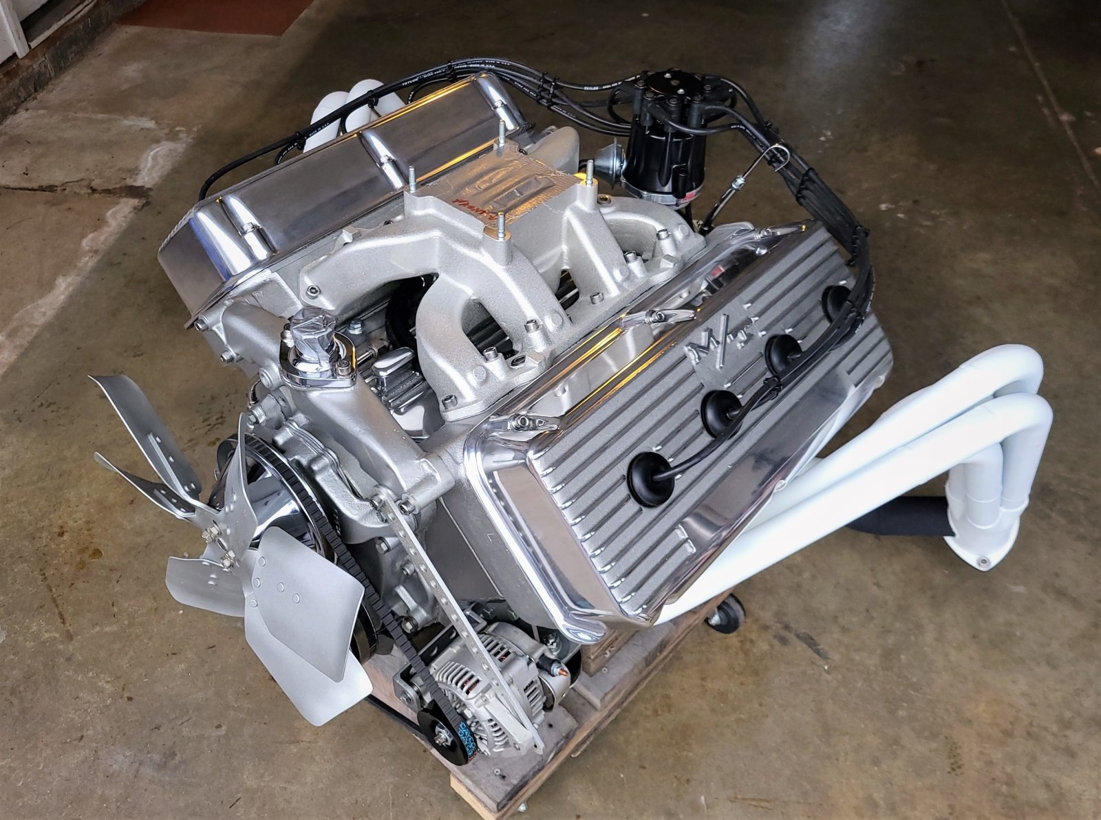

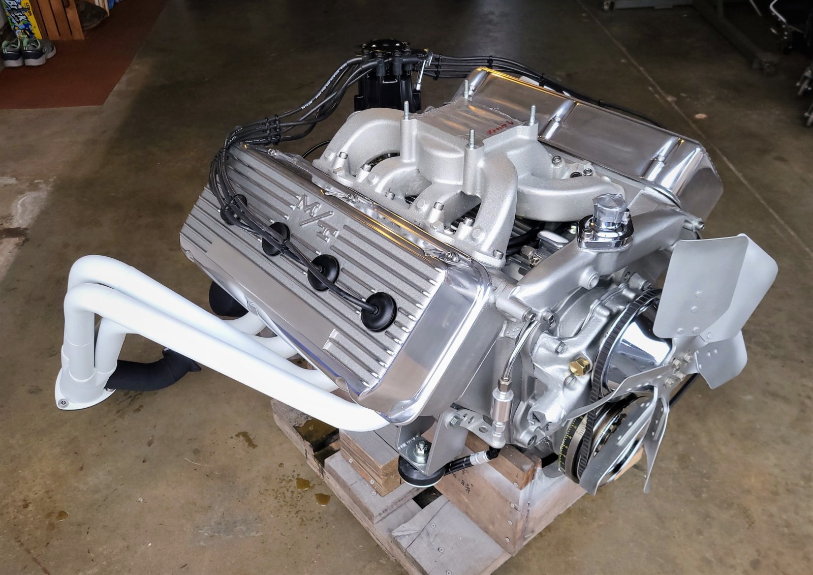

  16. The headers got sandblasted, then cleaned with wax/grease remover.
    VHT painting instructions call for heating them, both before & after spraying. I used what I have- MAP gas.
    Spraying a smooth, even, run-free finish was tough, especially around tight bends.
    "It's just a "Black 'n Decker aquarium pump.";):D
    tomcat11, Joe Blow, swade41 and 28 others like this.
  17. Gary, the engine with the white headers looks sooooo good.
  18. Dino 64
    Joined: Jul 13, 2012
    Posts: 2,523
    Dino 64
    from Virginia
    I gotta put on my sunglasses :D;)
    Looks great !!
  19. Tim
    Joined: Mar 2, 2001
    Posts: 19,453
    Tim
    from KCMO
    Man I sprayed my ram horns white vht a week ago that shits thin! Ended up with one good one and one drippy one. I’ll put the drippy one on the side I don’t look at lol

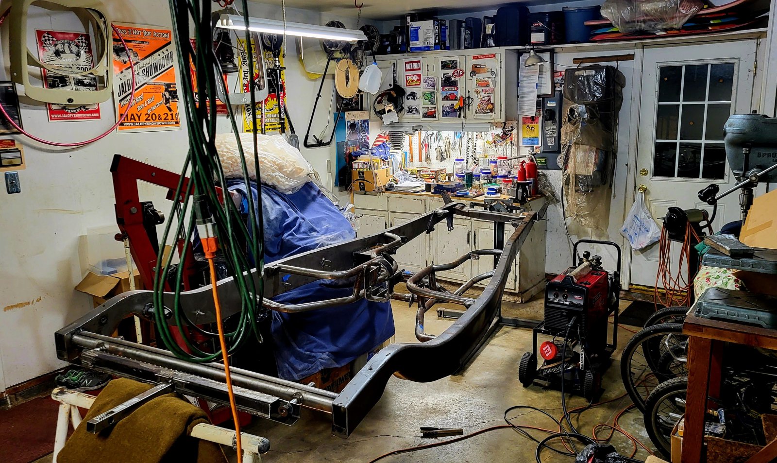

  26. I sanded & degreased the frame & small parts while awaiting a warm, dry Saturday.
    Same epoxy as on the body; but reduced 4:1:1 for better flow-out, and with a *decent* gun regulator.
    Unfortunately, the 15' long "booth" was a bit too short for all-around frame access and I accidently bumped into the hanging parts a couple times.:rolleyes:
    I squirted a bit less than a half-gallon of primer (before thinning). Even on the rotisserie, getting even coverage on the center x-member was tough. Still, everything got ~3 coats before running out.
    Between coats, I checked coverage, drained the compressor tank, and refilled the spray gun cup.
    I'm pretty happy with the results.:)
    Now for a filler skim coat on the frame and more sanding dust.
