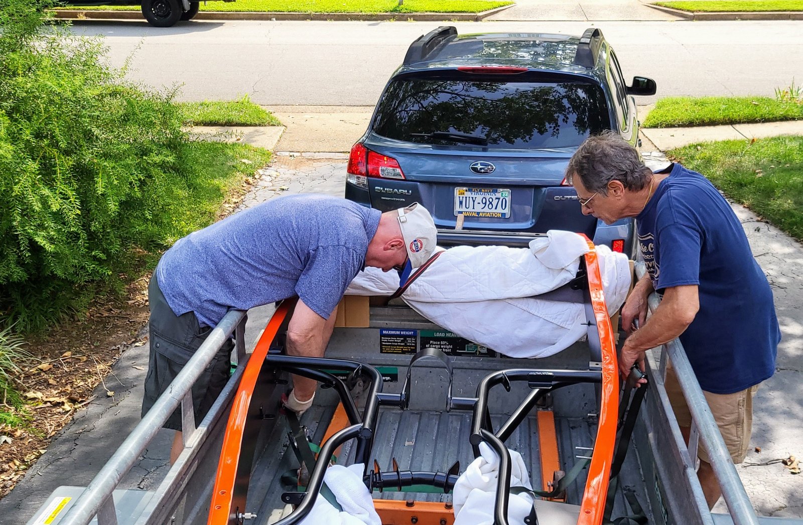

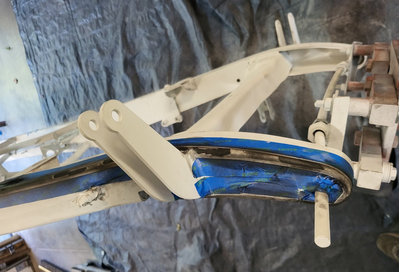

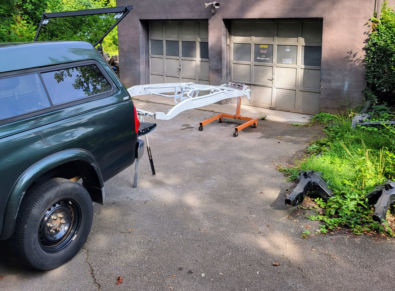

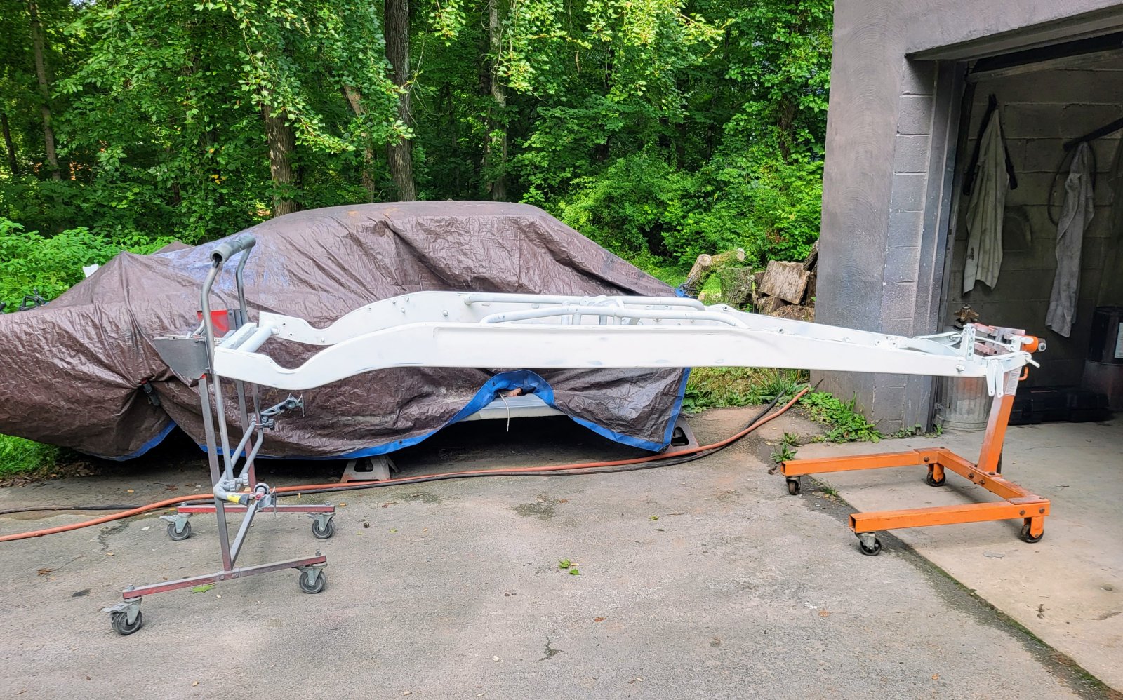

    Thanks! It hung out the back about 3'. We flipped up the tailgate and the frame rested on its top edge.

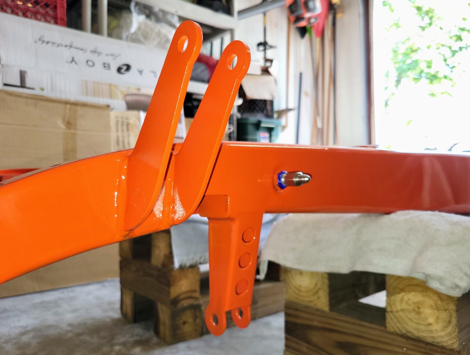

    BTW, the color was decided back in 2006:

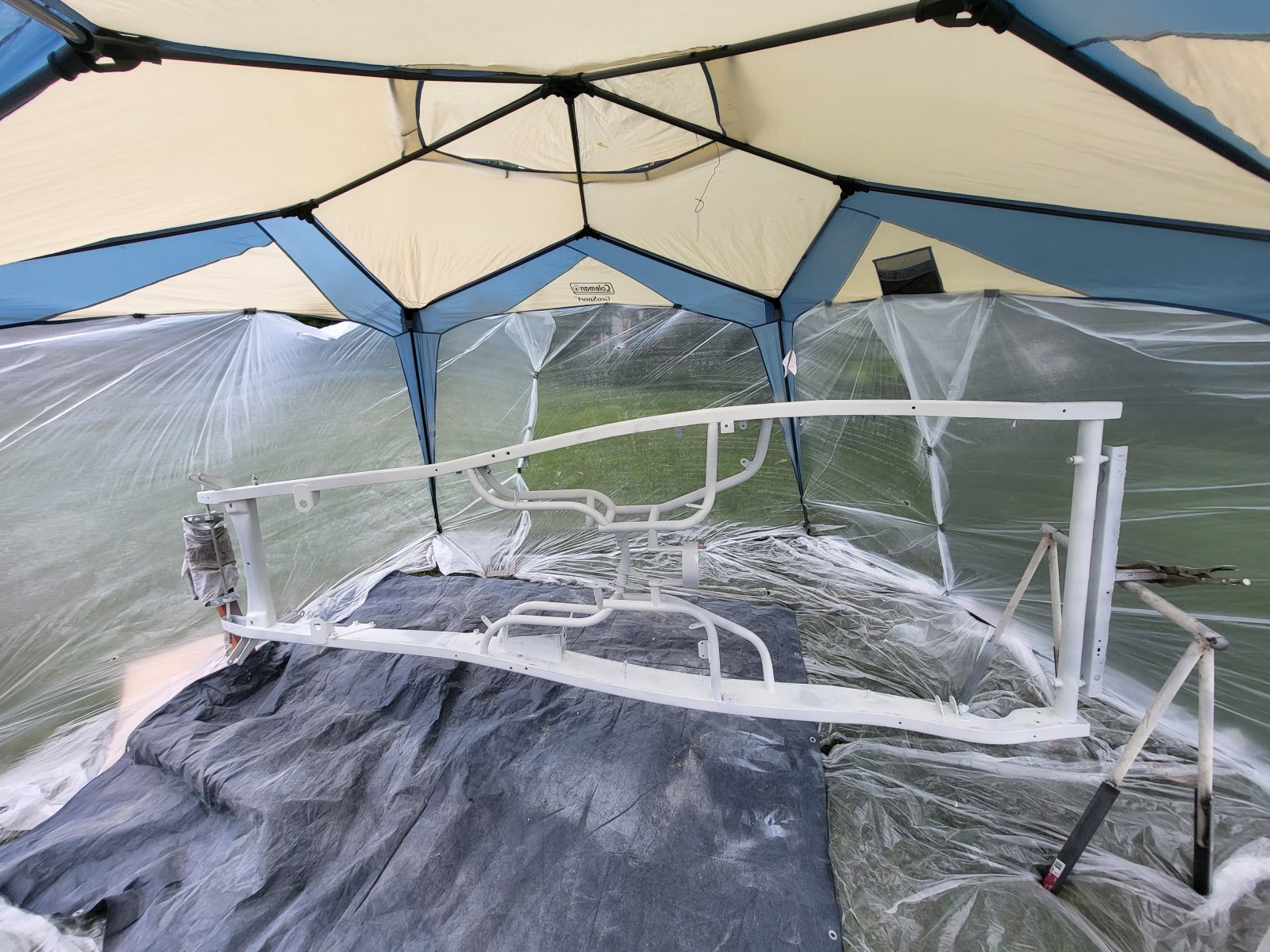

  5. Just Gary
    Joined: Oct 9, 2002
    Posts: 5,812
    Just Gary
  6. X38
    Joined: Feb 27, 2005
    Posts: 17,498
    X38
    Bright!
    Is that a straight tinter or a mix?

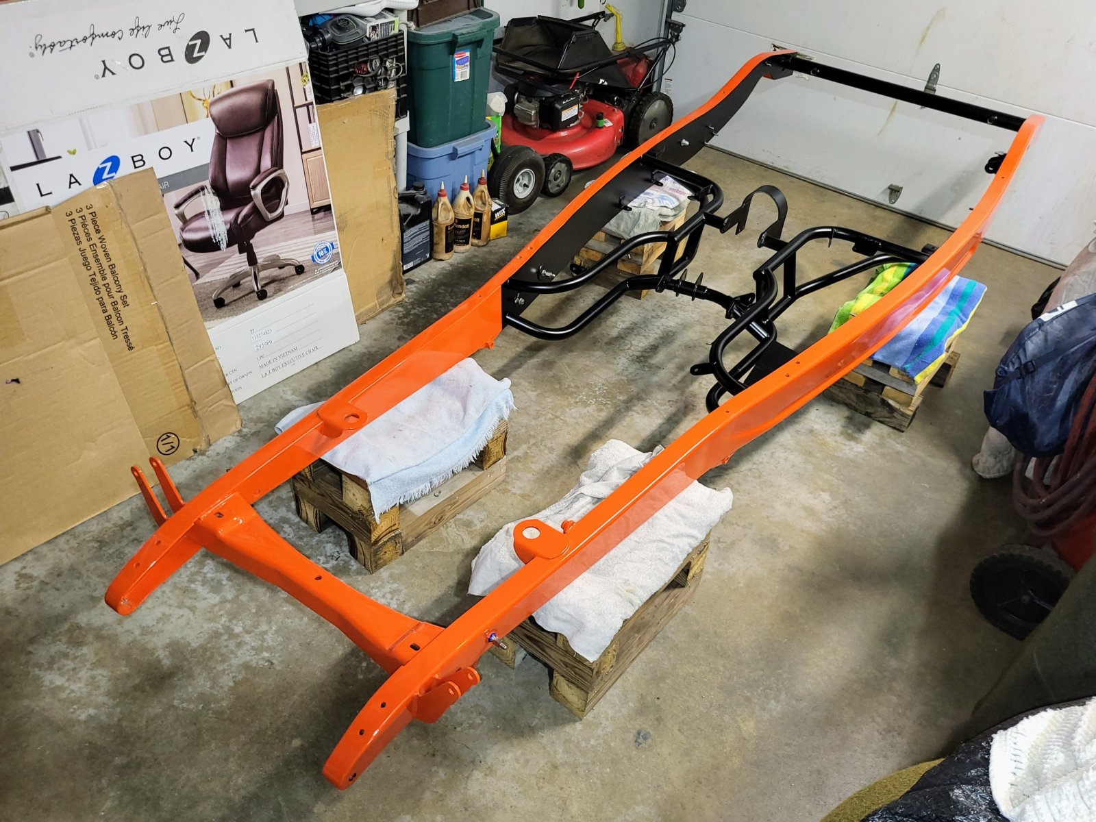

  10. Just Gary
    Joined: Oct 9, 2002
    Posts: 5,812
    Just Gary
    Thanks for the kudos, guys. :)
    It's stock '69 C*m*ro Hugger Orange, code 72. Pontiac used the same code, but called it Carousel Red.

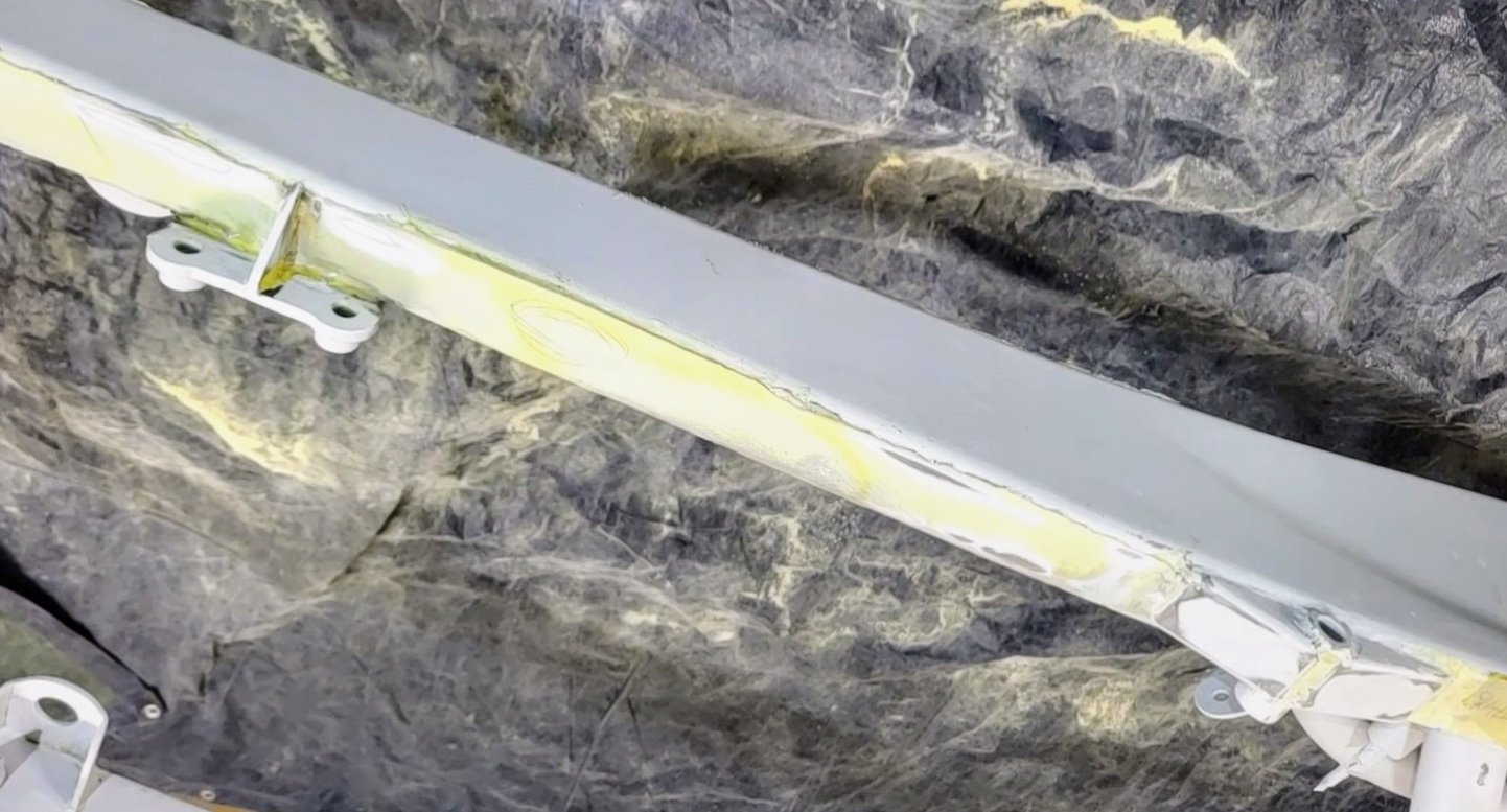

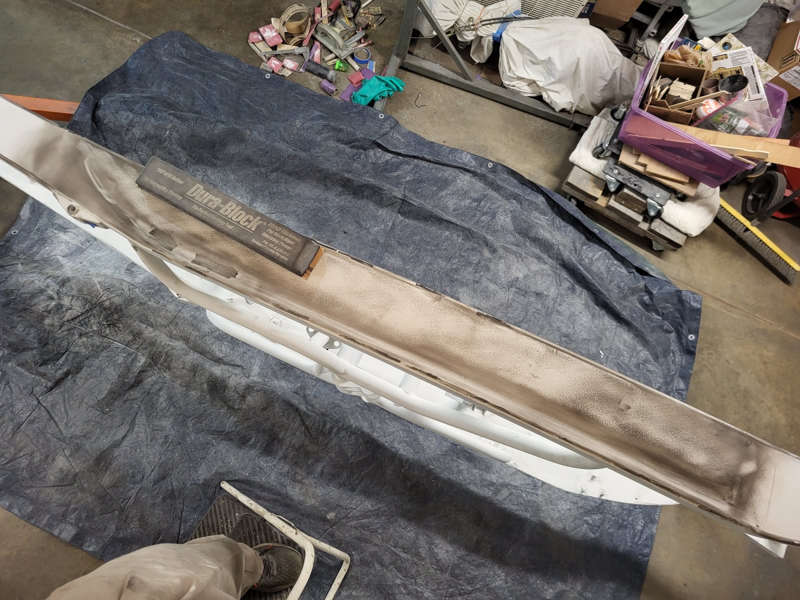

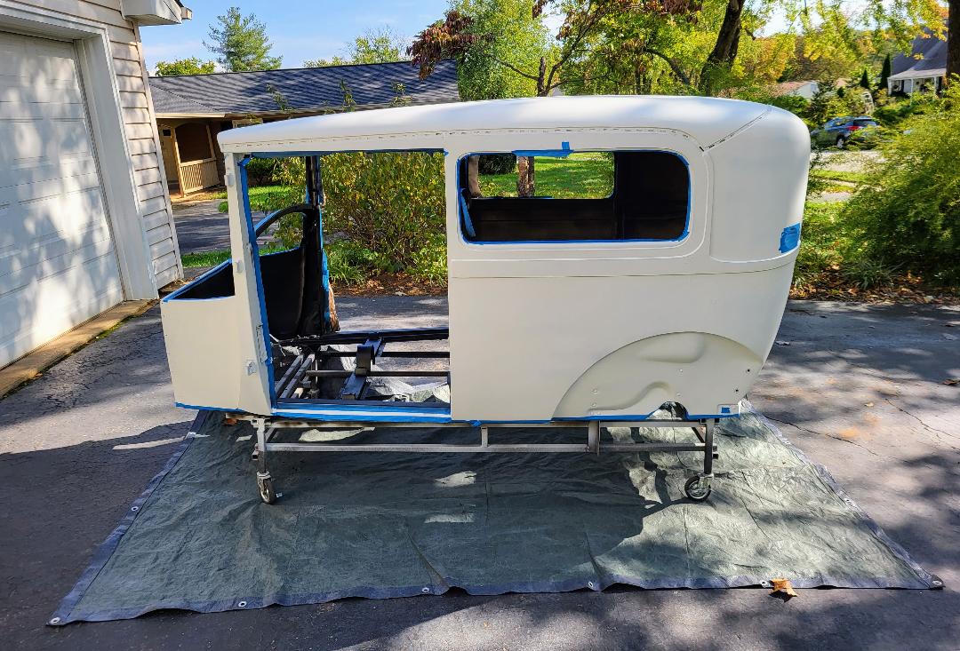

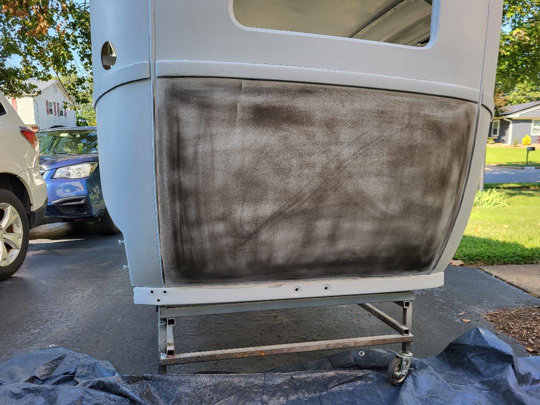

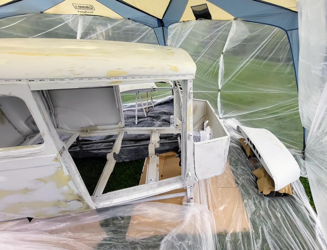

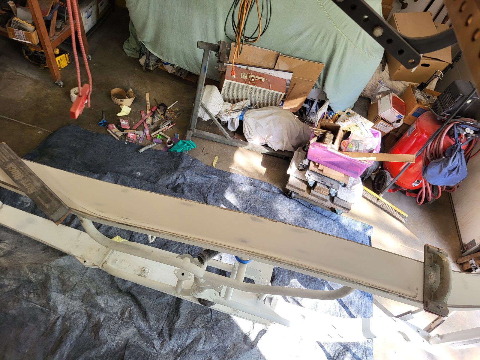

    Back to the bodywork "sand-prime-sand" do-loop.
    I also tapped down a few bare metal highs and spread a thin schmear of epoxy glaze in the remaining lows.
    BTW, black guidecoat mixed with sanding dust is like tal*** powder; it gets everywhere. :eek:

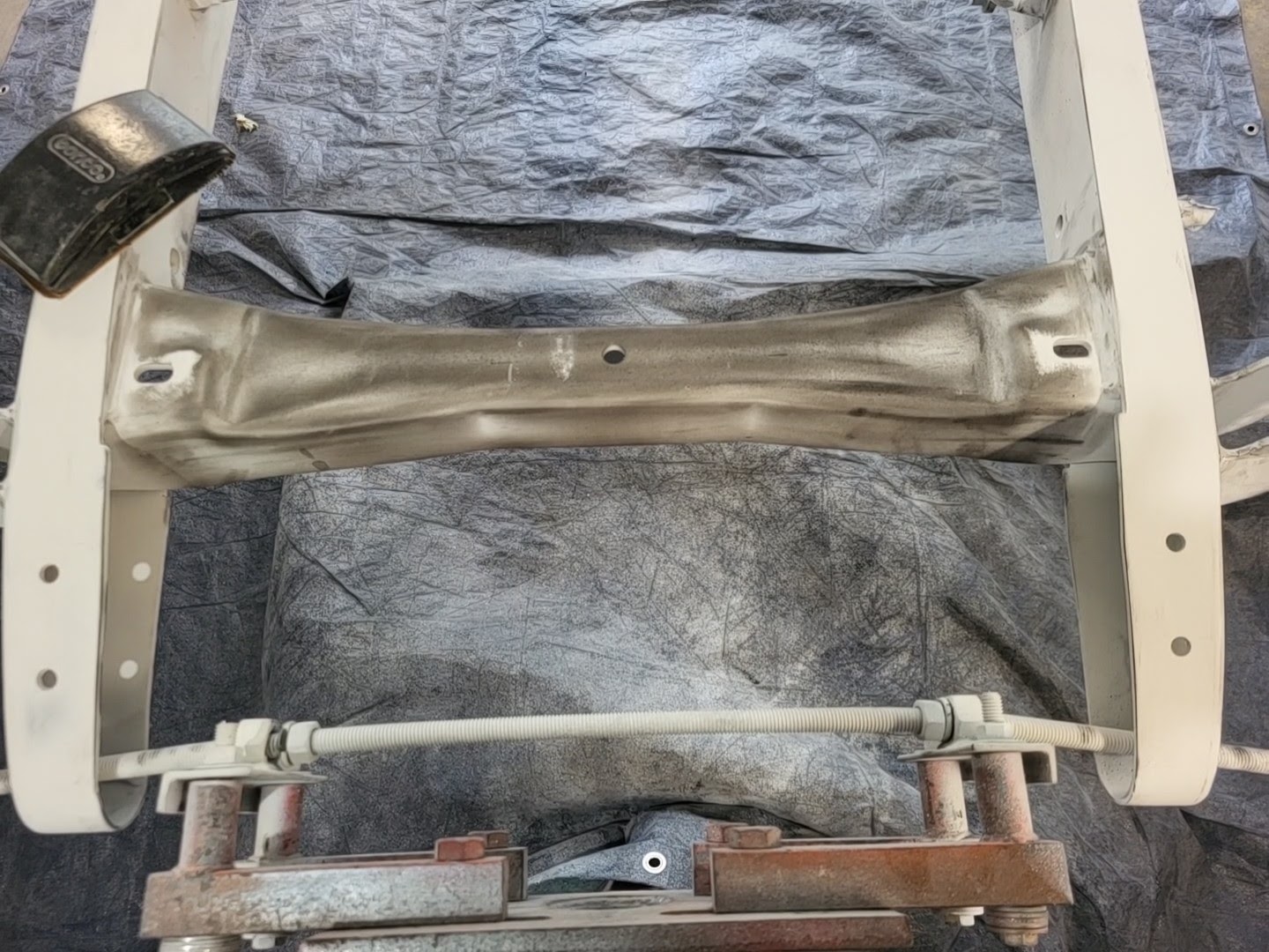

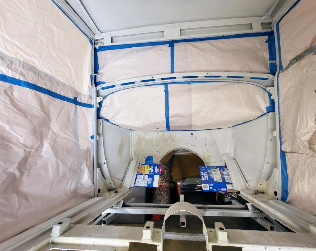

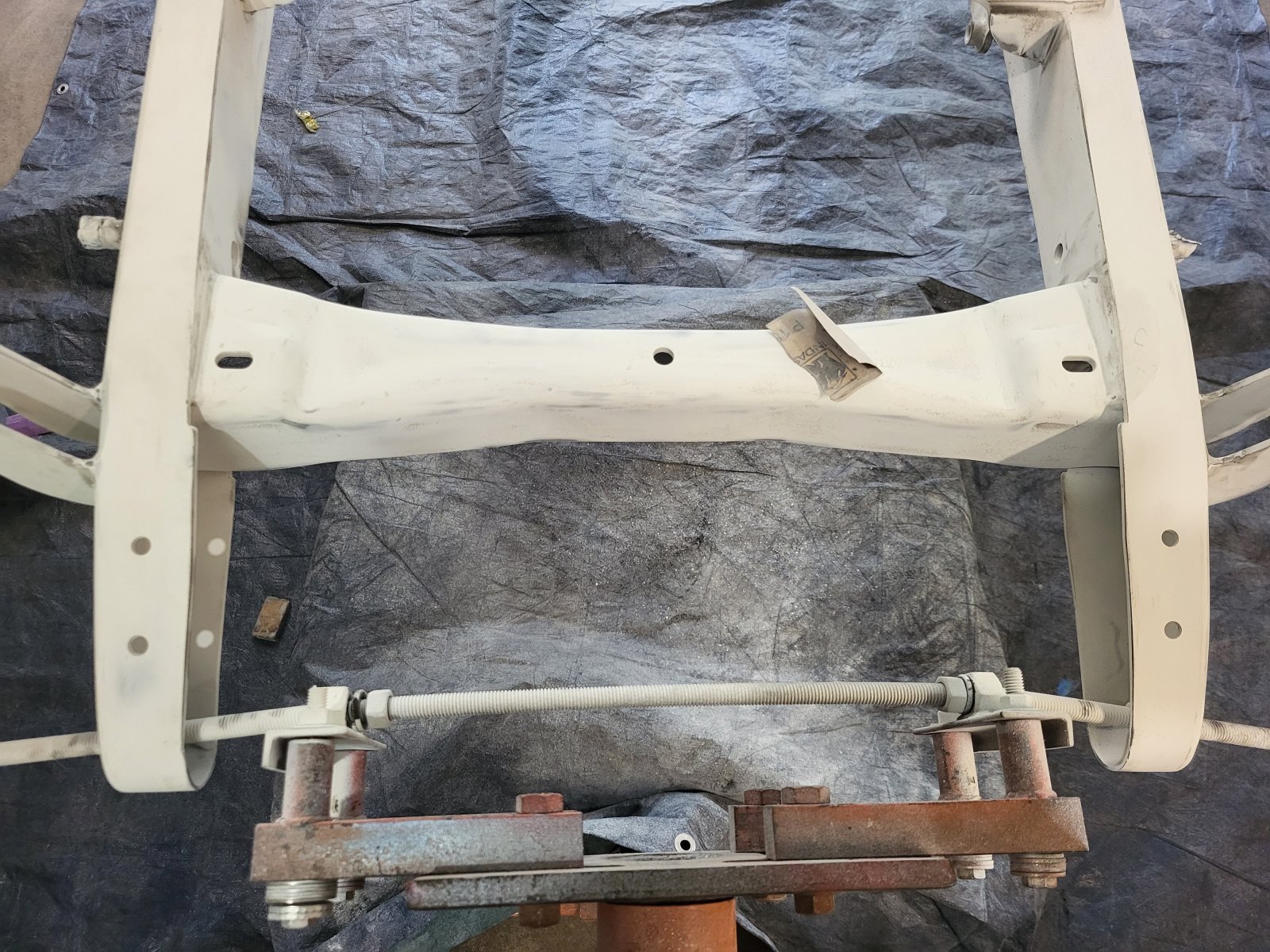

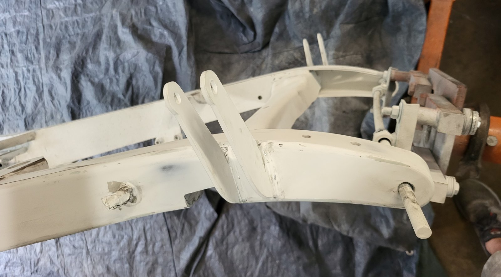

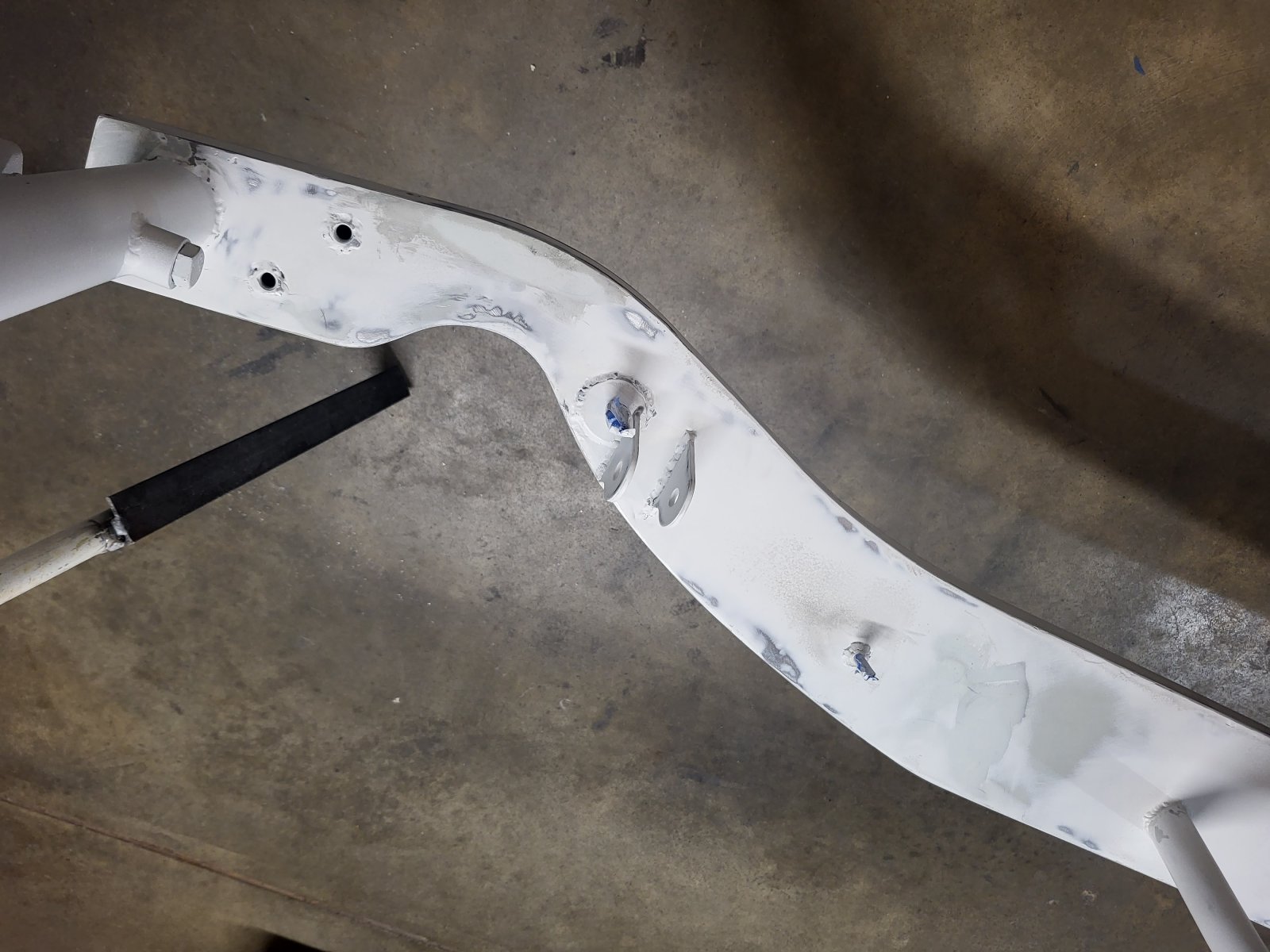

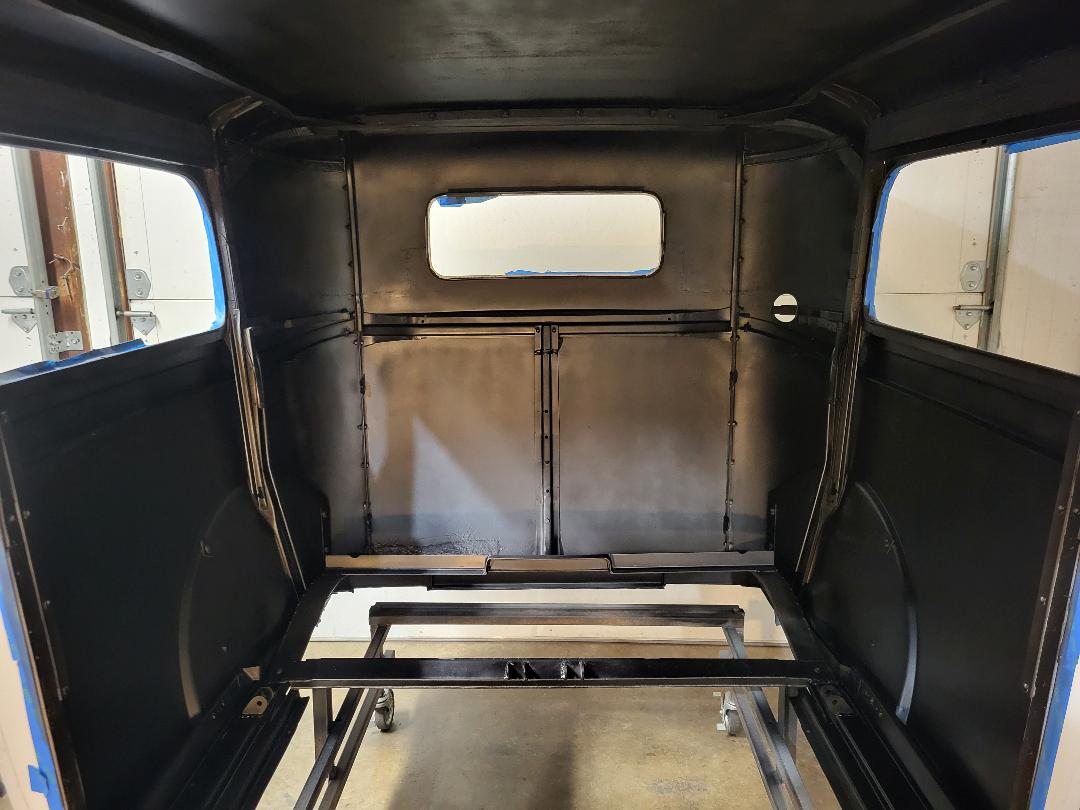

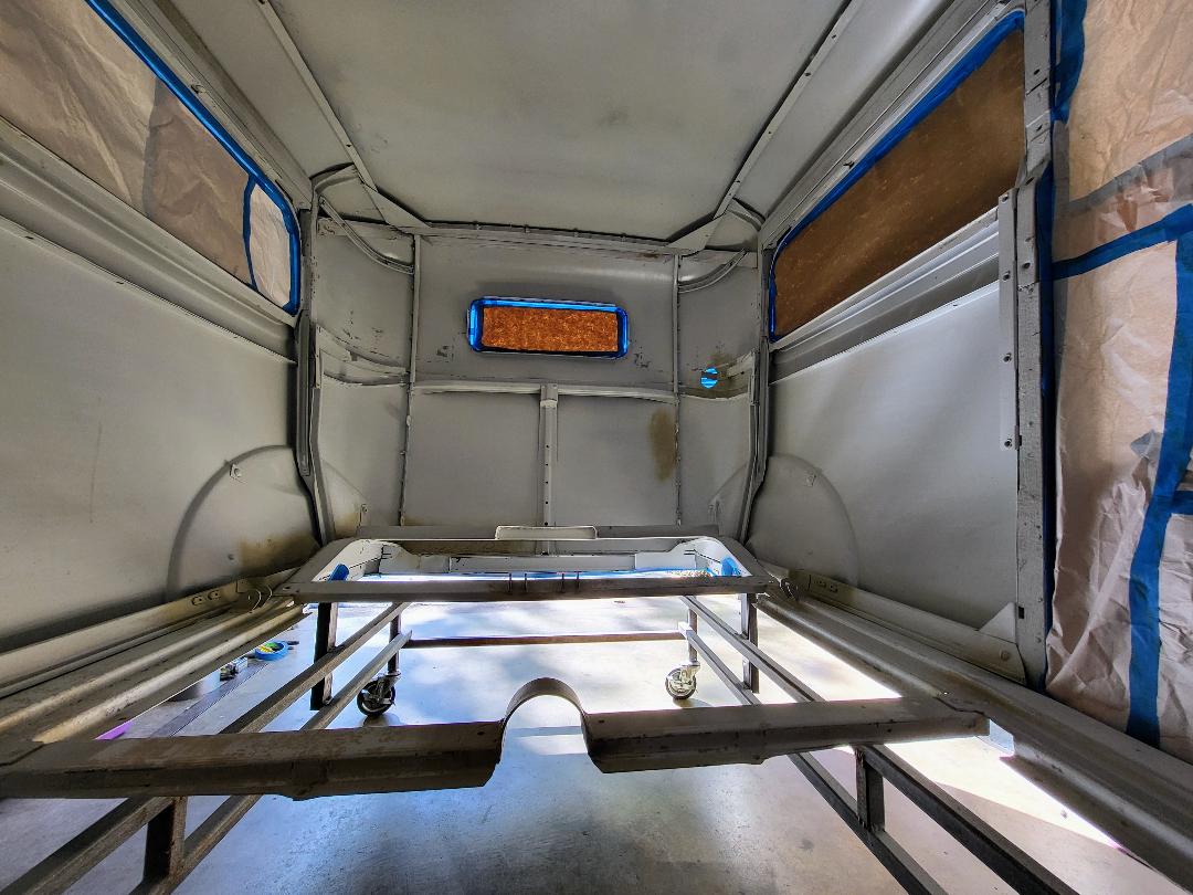

    I scuffed and masked the interior and undercarriage....
    ...and jacked up the body to access the sub- and cross-rail bottoms.
    Then I squirted on some TAMCO matte black single-stage urethane.
    It's mixed 4:1 plus ~5% reducer and sprayed through a 1.4 mm tip at 28 psi, per the TDS, and (what I thought was) 50% overlap.
    Two coats didn't cover the white primer very well.
    Maybe gun pressure? Or fluid setting? Or too thin? Or a combination?
    Anyway, I snuck out of work early today, re-masked, mixed, and sprayed another coat; this time unreduced, which covered much better. :)
    The satin finish should contrast nicely with the sparkly stuff. :cool:
    Now for some final sanding then off to Roy for paint!

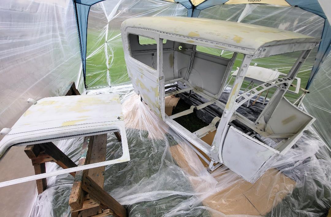

    While impatiently waiting for my turn at Roy's paint booth, I blocked the edges of the door openings & raised beltlines to get nice consistent radii.
    Then began ***embling the ch***is. It's fun- like a giant Lego set...:)
    .... but with protective quilts & anti-seize.
    20231110_093811.jpg 20231110_093549.jpg 20231110_094942.jpg 20231110_094349.jpg 20231110_095511.jpg
