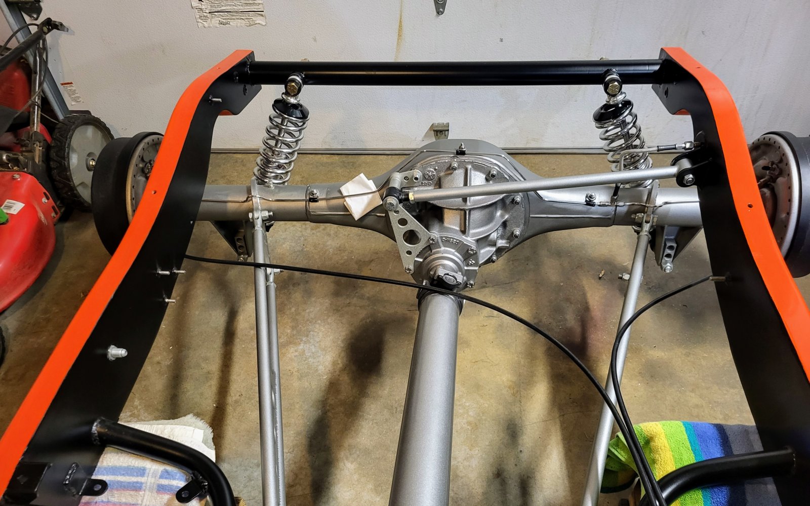

    Great question. Here's why:
    1) So I don't feel compelled to keep the undercarriage show-car clean 24/7. This will be a nice driver.
    2) Esthetics. When seen from behind, the bright highlights (rearend, bumper & springs) jump out and the darker distractions (crossmembers, frame brackets, etc.) disappear.
    3) Tradition (plagiarism to be precise:rolleyes:). Gary Kessler painted his roadster's inner rails black. "A common '60's practice", according to TRJ #34.
    4) Cheaper, even with the extra masking. Easier to touch up too.

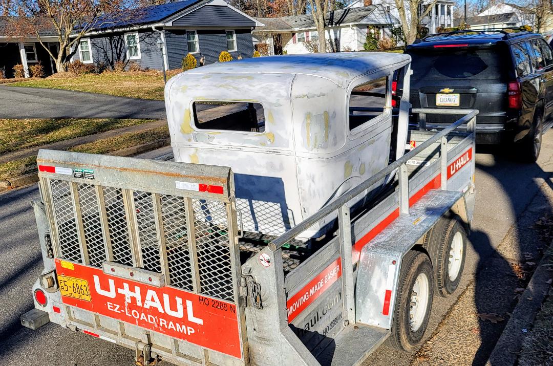

    My 700R4 dust cover holes were neither standard nor metric threads (Maybe sheetmetal screws? Or Whitworth? Or alien? :confused: )
    Anyway, I drilled and tapped them for 1/4-20 x 3/4" machine screws.
    Then dropped off the body...
    ...and picked up some small pieces. :)
