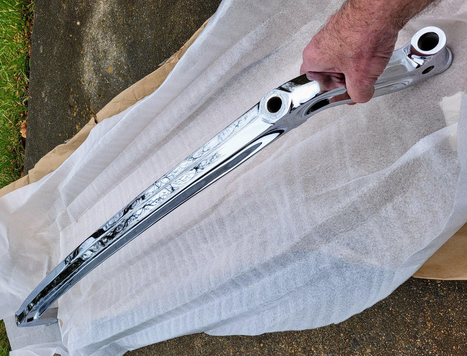

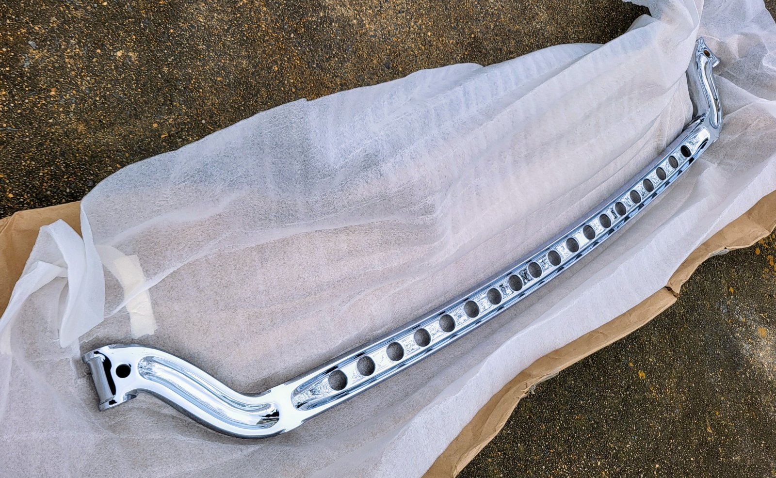

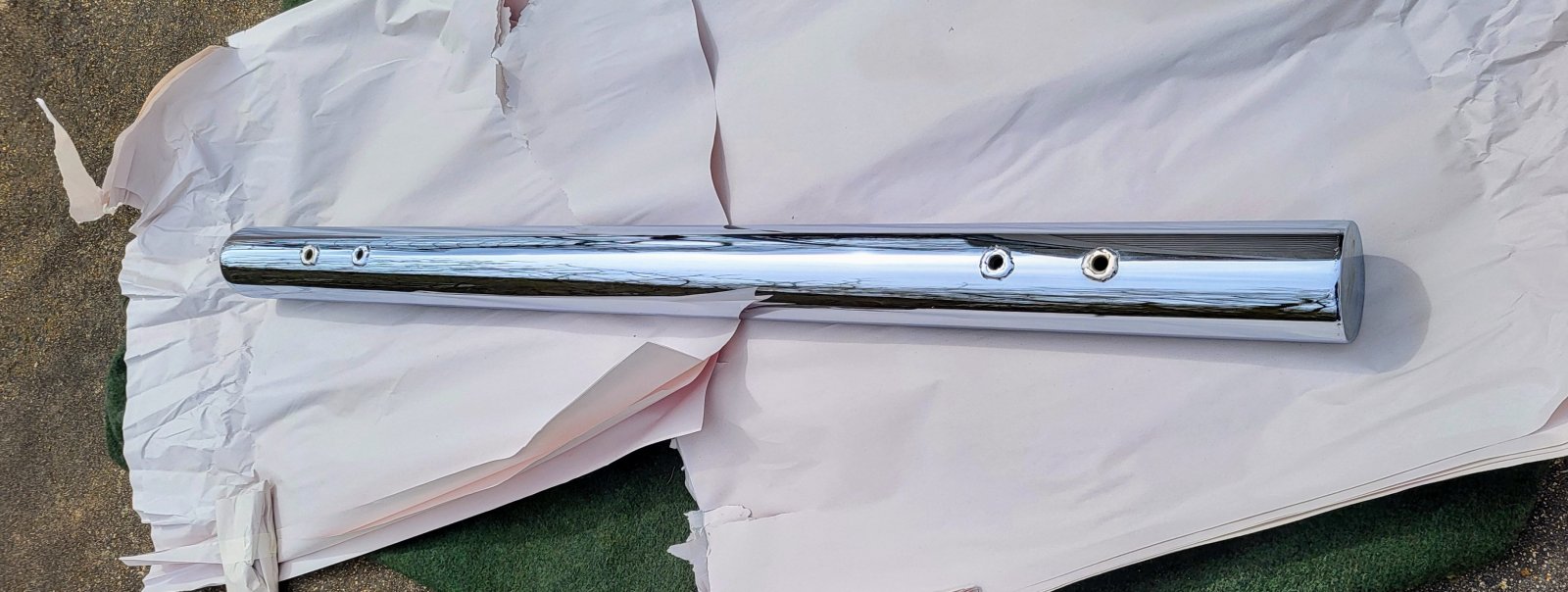

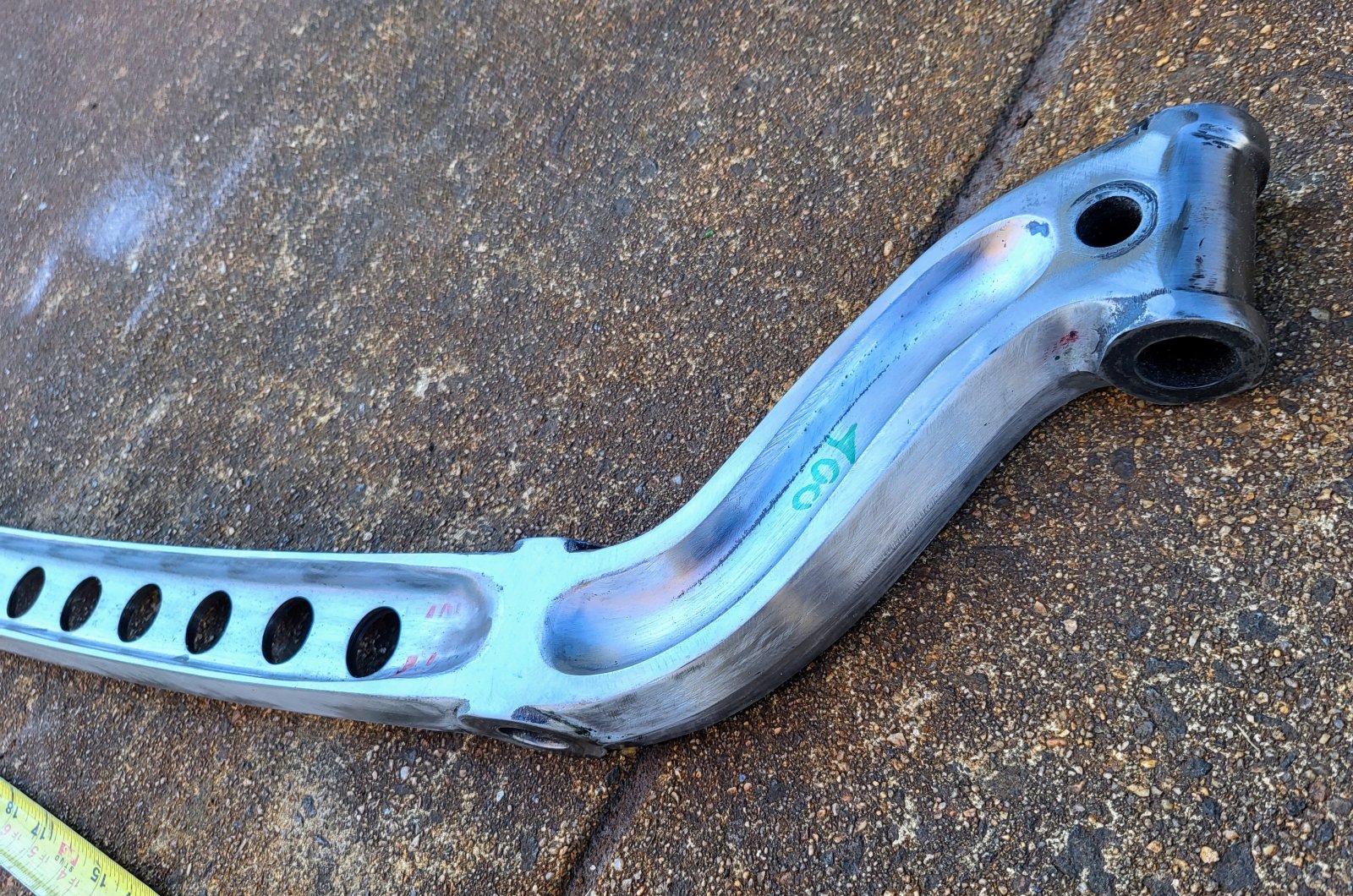

    I'd already ground and sanded the front axle and rear bumper to #400 to reduce chrome shop labor costs.
    20231125_114143.jpg 20231125_114115.jpg 20231125_113658.jpg 20231125_113617.jpg
    Wayne's Auto Parts in Fredericksburg, VA, finished sanding, then triple (copper, nickel, chrome) plated them both.
    Wayne’s Auto Parts | Wayne’s Auto Parts (waynesautoparts.com)
    Excellent quality and very reasonable price. I'd definitely trust them with future work.
    The twelve-week turnaround (Wayne had predicted 8-10) was a minor inconvenience but I pressed ahead with other tasks while waiting.
    BTW, that's a '33-36 Ford axle dropped by @jackandeuces :cool:

    That is nice work, Gary. Very nice. Triple plating these days is a real bonus. I know that some platers are skipping the copper stage because of the expense of the copper. You should be well pleased with that.
  14. The37Kid
    Joined: Apr 30, 2004
    Posts: 32,491
    The37Kid
    Very nice dropped axle, always like to see consistent spacing on the dropped area, chrome looks great. Bob

    Those chrome pieces are the cat's pajamas !

    That axle is art.

    Oooh chrome !! Looks fantastic, they did a great job !
