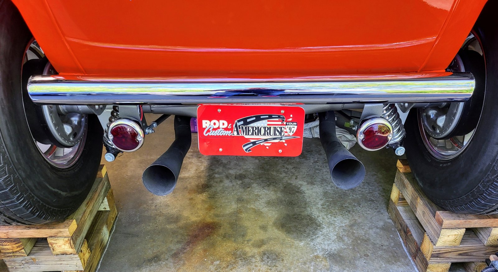

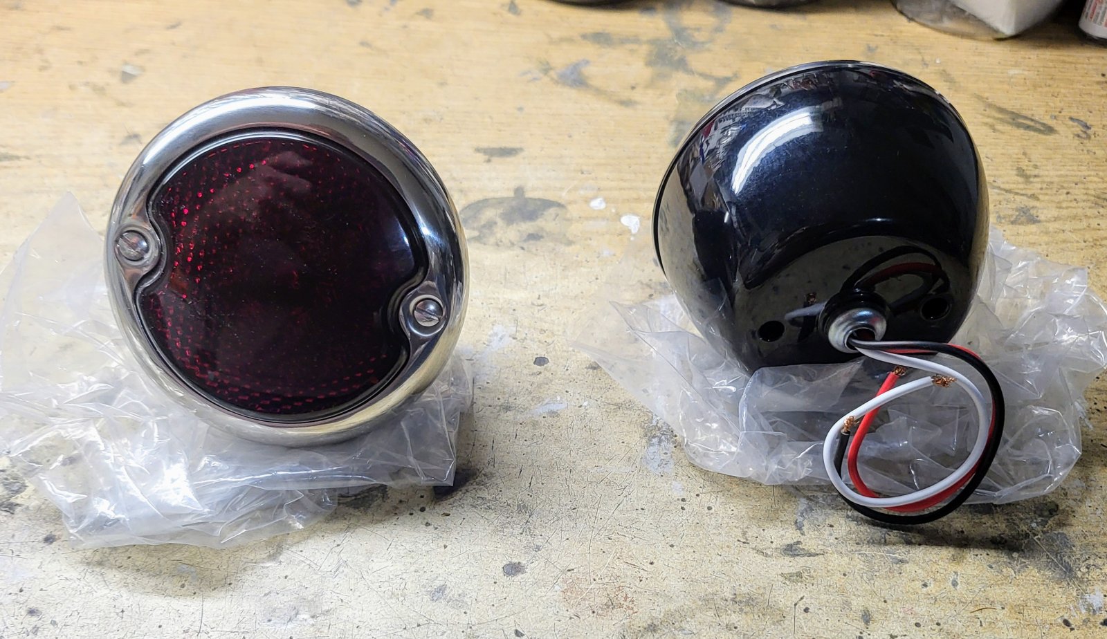

    The one pic that Gary shown of lights/tag
    Under car is only about 8 inches from Garage door,
    Sharpone and Just Gary like this.

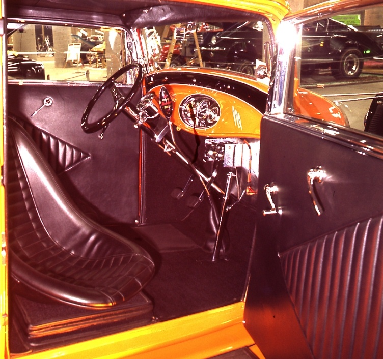

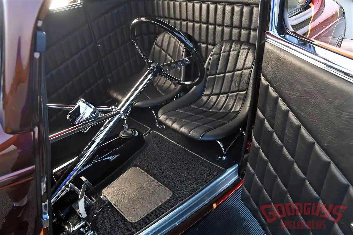

    I researched the *all* the 1960's HRM digital archives: motortrend.com/plus/magazines/hot-rod/3169
    and realized....
    -Military surplus seats weren't used in racecars anymore.
    -Lightweight fibergl*** bucket seats (aka "Eames", "laundromat" or "bowling alley" seats) predominated in NHRA's Altered, G***er & A/FX cl***es, often covered by Tony Nancy-style square, diamond, or pleated black naugahyde.

    Phil Kendrick's (then guitarist Jeff Beck's (RIP :()) "Super Prune" Deuce sedan
    @BRENT MAGGI 's ***-kicking A coupe
    The "St Christopher" '34 Ford coupe, 2023 Goodguys HROTY
    and the 15 oz Fuel Coupe.

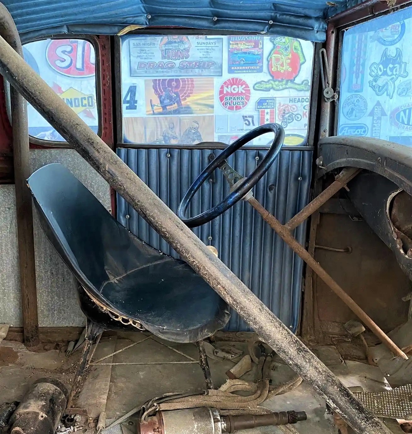

    If you find the right issue of one of the "Little Pages" there was feature on making seat frames from supermarket SHOPPING CARTS. Someone may have posted it here on the HAMB, worth a search. The only finished Hot Rod here in town back around 1965 had blue plastic chairs for seats. I better start looking for two of them for the future clone I'd like to start collecting parts for.

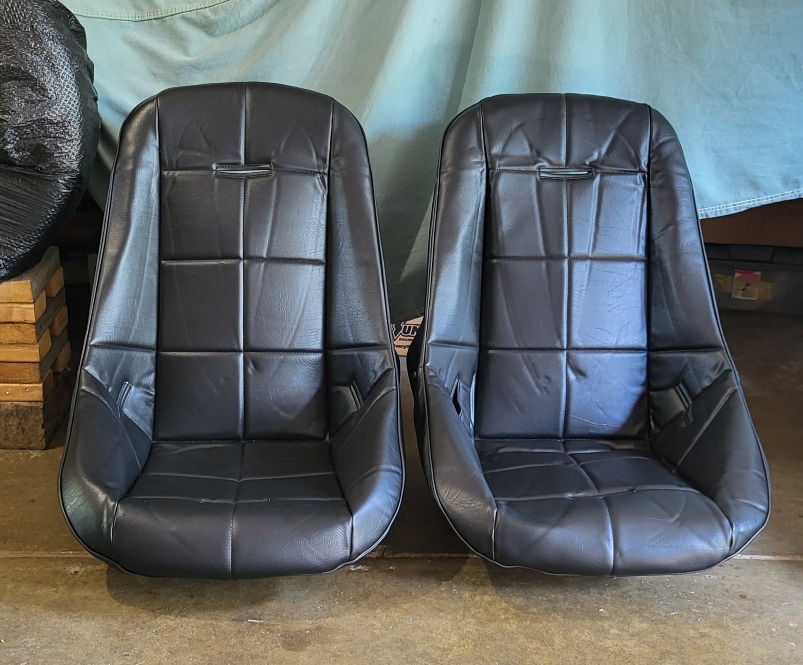

    ..... I returned to my original 2006 plan (see post #1) and bought two EMPI "Dune Buggy" :eek: seats, covers and bases.
    Thanks to @mad mikey and @chevy57dude for measuring their racing seats to confirm these would fit.
    More progress after I get back from camping in the Smokies.

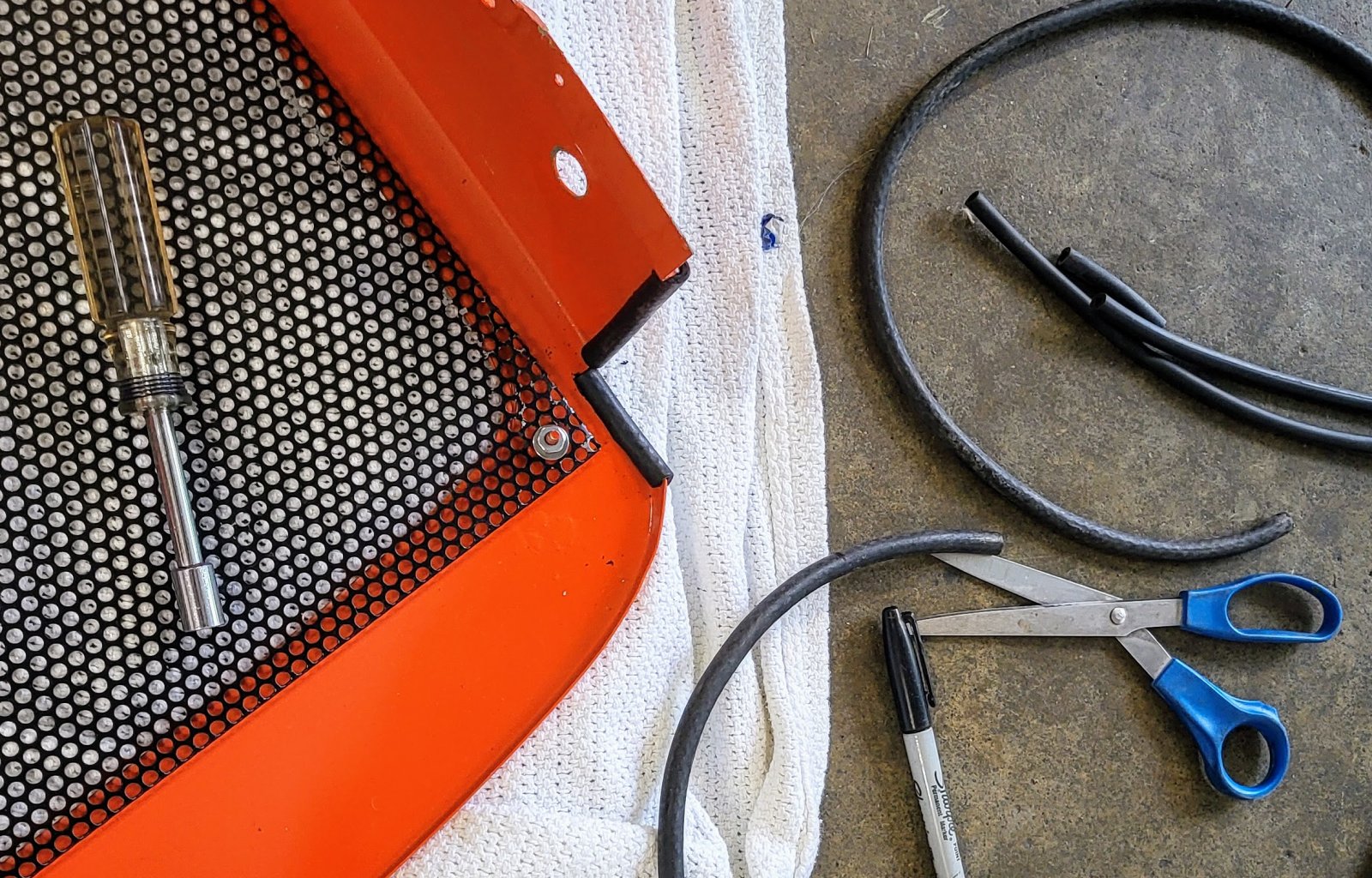

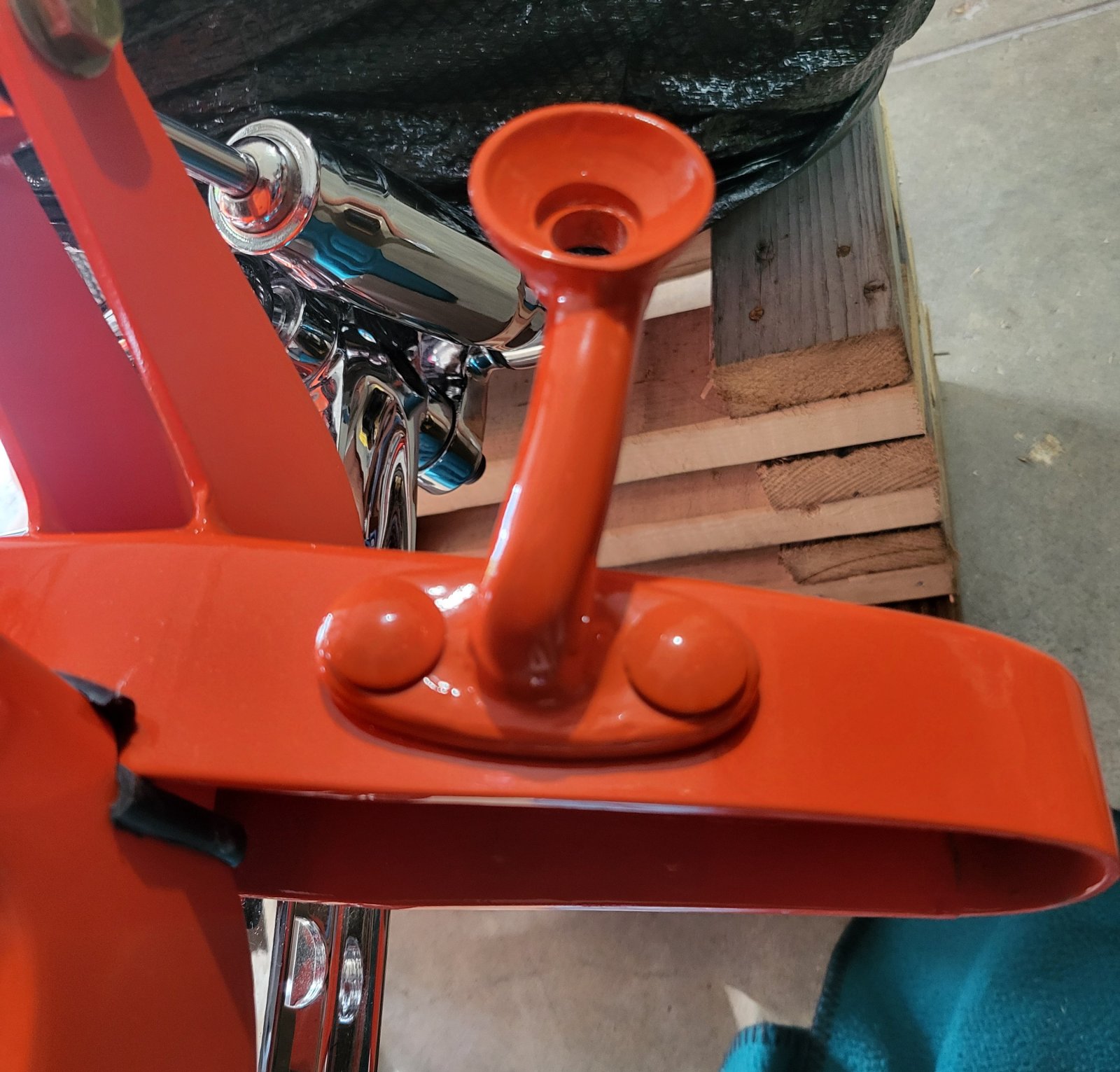

    Meanwhile, some progress while my wiring harness is in transit.
    super tach ad 02.jpg 20240608_093742.jpg 20240609_180008.jpg 20240712_210620.jpg 20240603_184720.jpg 20240712_173318.jpg
    I might add washers under the grade 8 bolt heads to spread the load. Thoughts?o_O 20240712_190306.jpg

    Seat belts Anchors ,
    How about 2 inch wide flat bar from bolt to bolt under neath floor 3/16 ,
    Maybe Not , I think I would go ahead & do ,,
    Even if you donot plain on running hard like I do ,
    Yes ,
    Just Gary likes this.
  24. The37Kid
    Joined: Apr 30, 2004
    Posts: 32,492
    The37Kid
    Nice bracket, I'd turn the hose clamp 180 degrees for knee and pants leg protection.
    brEad and Just Gary like this.
  25. 05snopro440
    Joined: Mar 15, 2011
    Posts: 2,992
    05snopro440
    Black shrink tube will take away the sharp edges and make it disappear somewhat.
    brEad, lothiandon1940 and Just Gary like this.
  26. 05snopro440
    Posts: 2,992
    05snopro440
    If you're referring to putting washers between the bolt head and the metal end of the seat belt, you certainly can for sure. However those washers are going to be thinner than the seat belt end and probably don't add a lot. As long as the bolt is relatively matched in size to the hole, it's probably not necessary.
    The car is coming right along!
