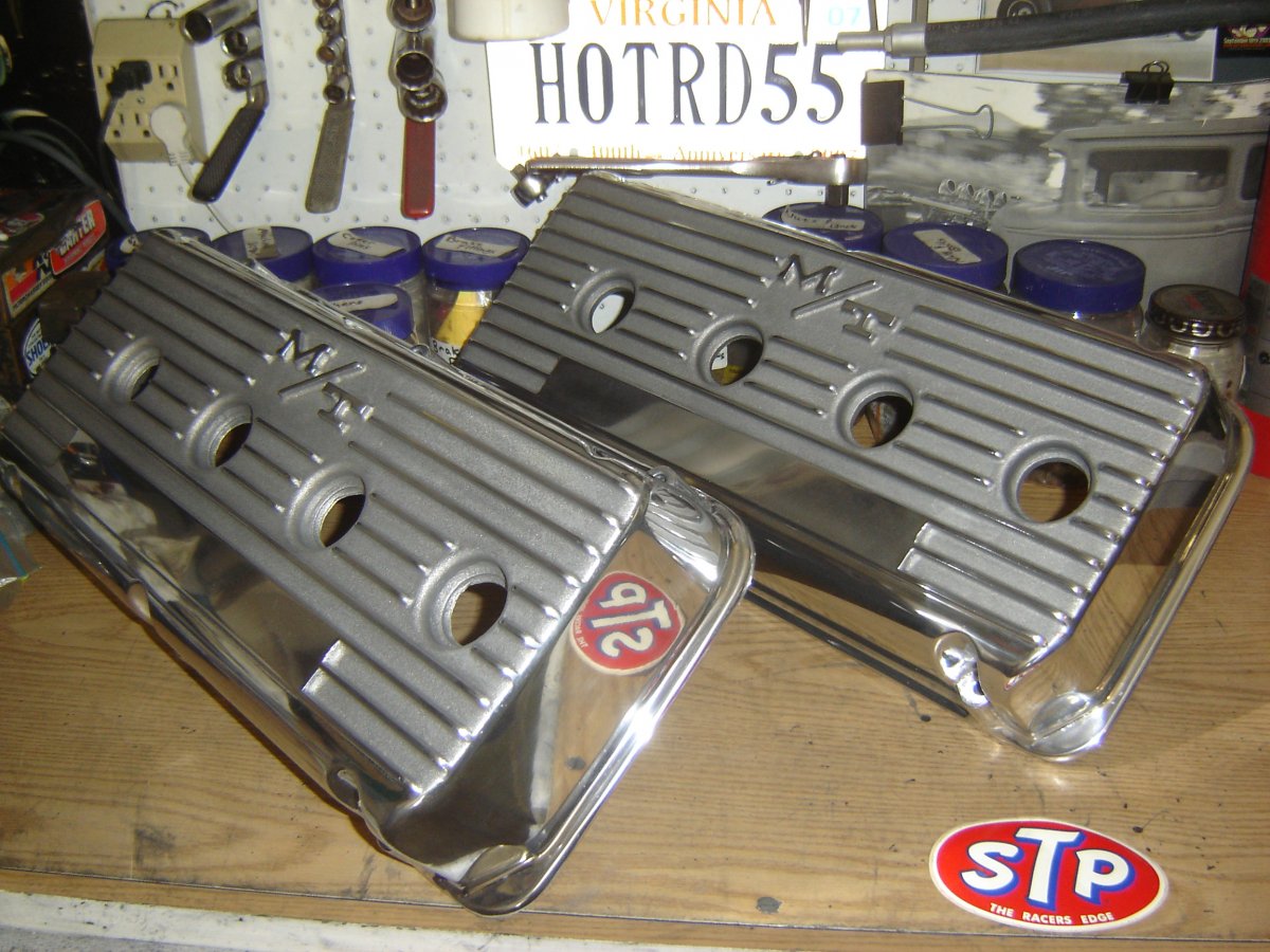

    I'm almost finished sanding and buffing the valve covers:

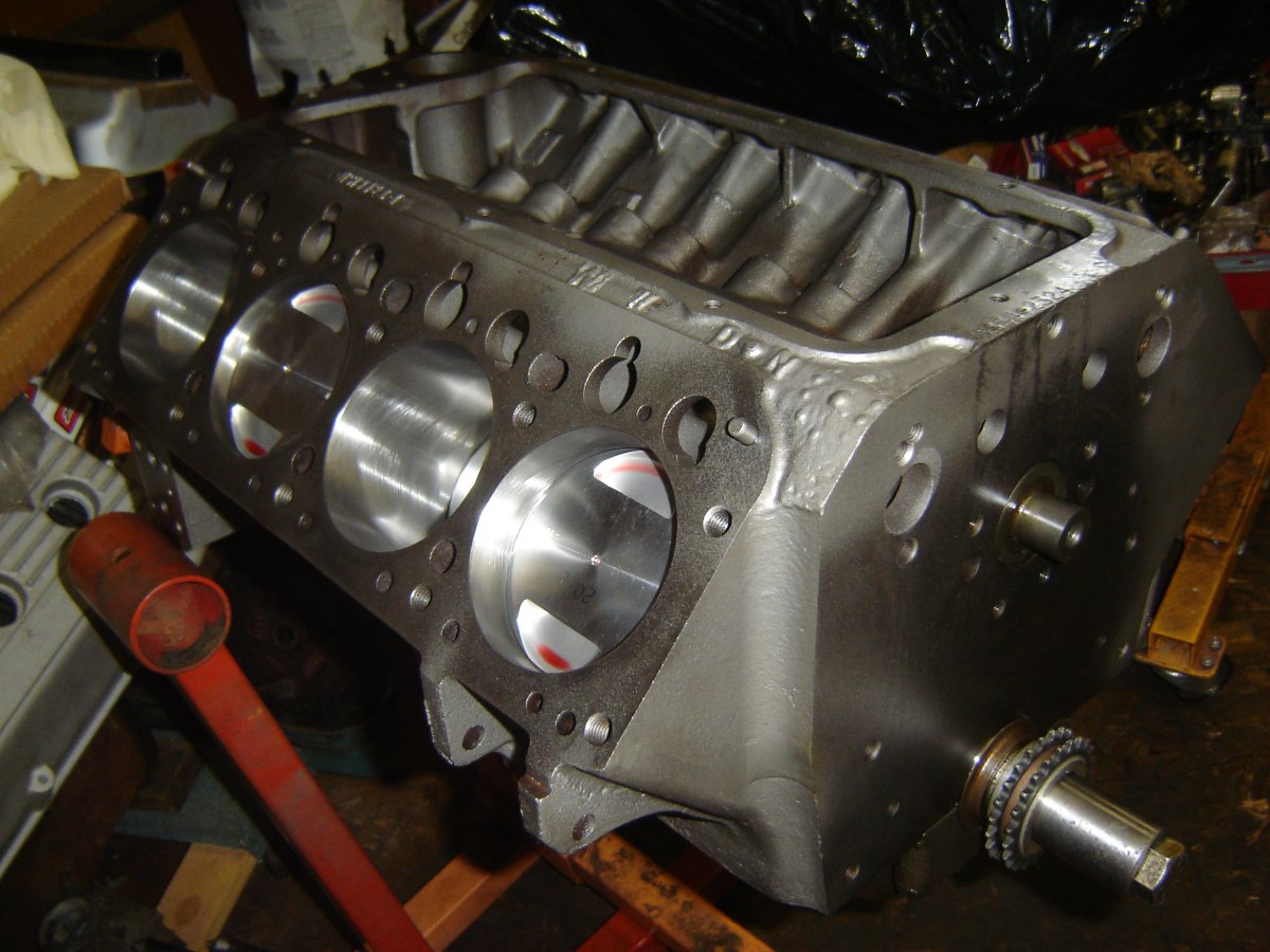

    The shortblock is finished: It's a 354 with 392 10:1 pistons and a 224' @ 0.050" cam. The heads are next and we'll fire it ~ Labor Day.

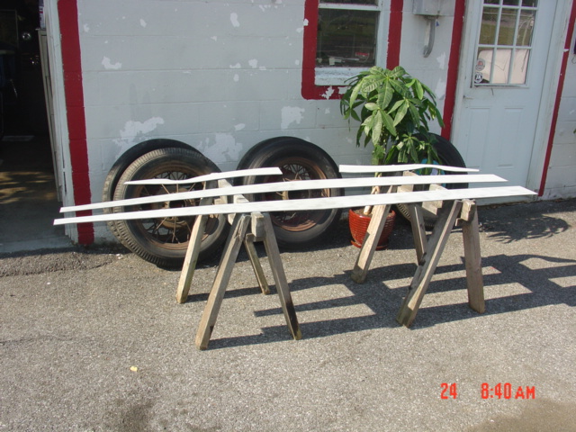

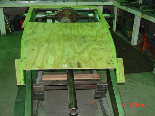

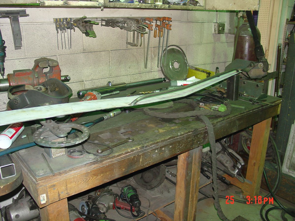

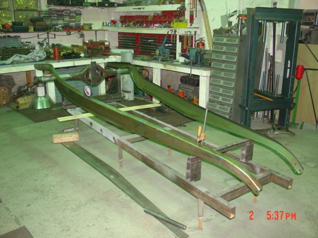

    Fortunately, fellow Virginia HAMBer OJ is nearby and is fabbing a Deuce frame to match my ’28 A, using JW Garage rails, boxing plates & crossmembers. He’s adding fixtures to a basic table, positioning the components based on Wescott dimensions and a plywood template of my Tudor body:

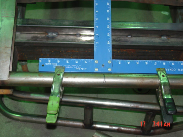

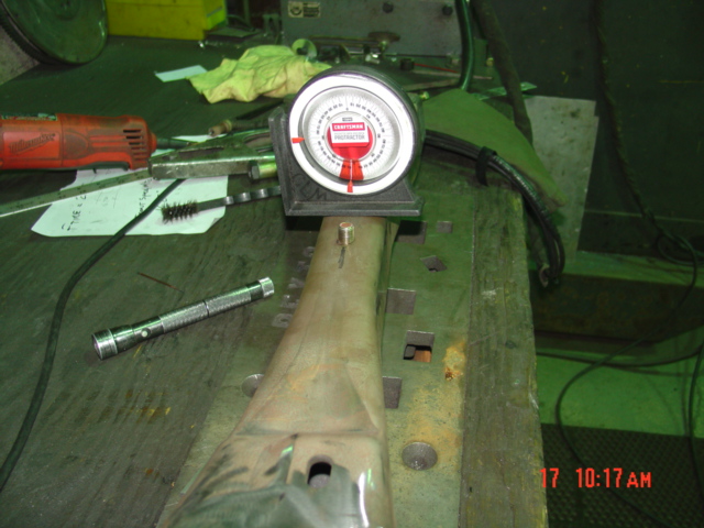

    The pinion is centered. Wheelbase is 107.5".
    A ruler is cleco'd to the top of the alignment bar/'driveshaft', from the pinion support along the centerline. It shows the true distance to the rear axle.
    The front crossmember fixture locks it at 6* caster.

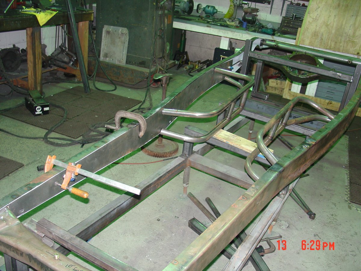

    More of OJ’s magic:

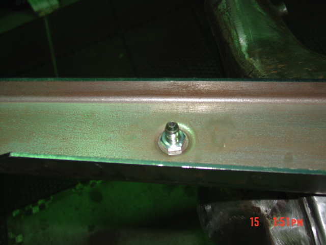

    Frame rails’ insides have been primed with rust inhibitor and captive nuts are to mount the body.
    The jig is configured so the frame rails can be removed and the fixtures stay in place. After the front crossmember is welded, that fixture can be removed and the spring takes its place with the front axle & spindle mockup. DSC00743.JPG DSC00754.JPG DSC00755.JPG DSC00756.JPG

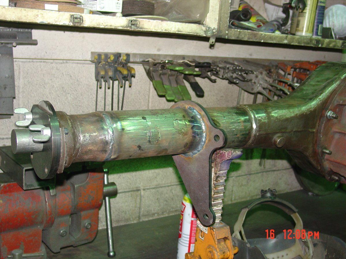

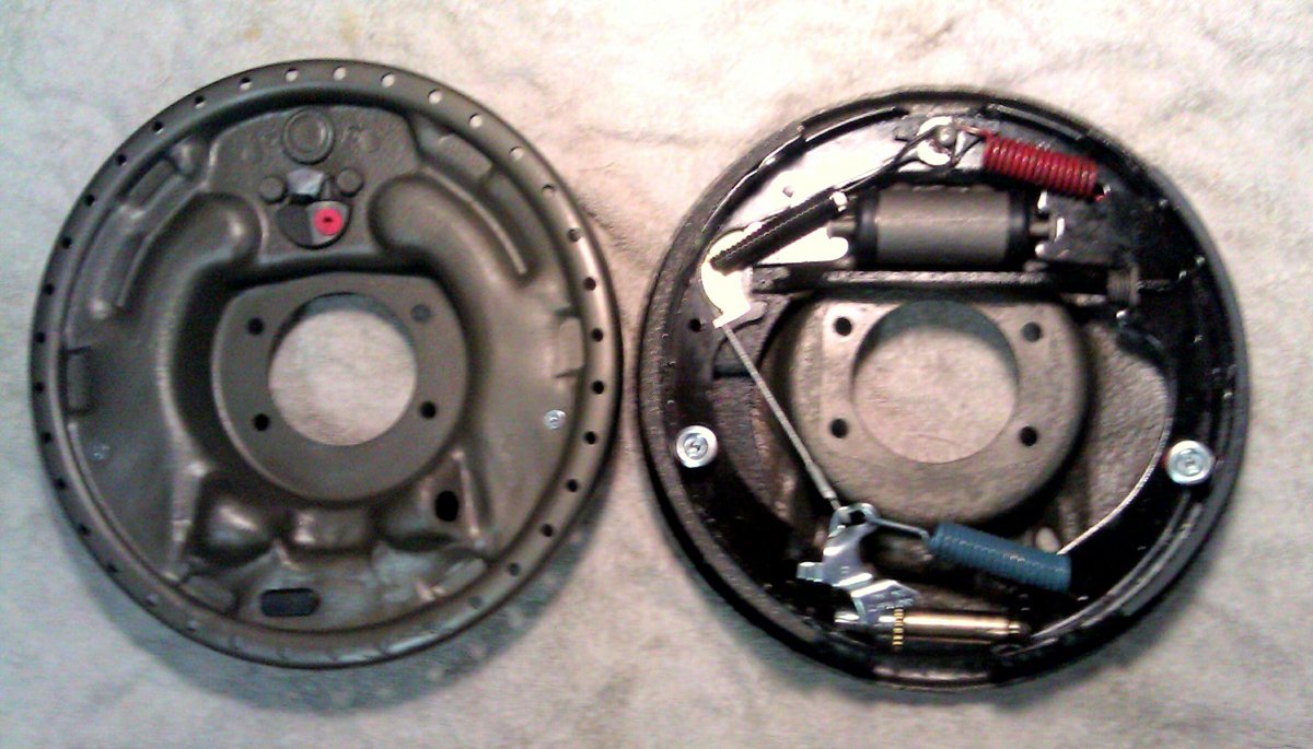

    Finally, I rebuilt the rear brakes and drilled the backing plates. Then welded, ground & filed smooth the F-150 axle housing.
    Meanwhile, fellow VA HAMBers, “ClutchDumpinDan” and “BurnedOutOldMechanic” (Dan & Al) rebuilt the differential.
    The level of talent around here is both humbling and inspiring…

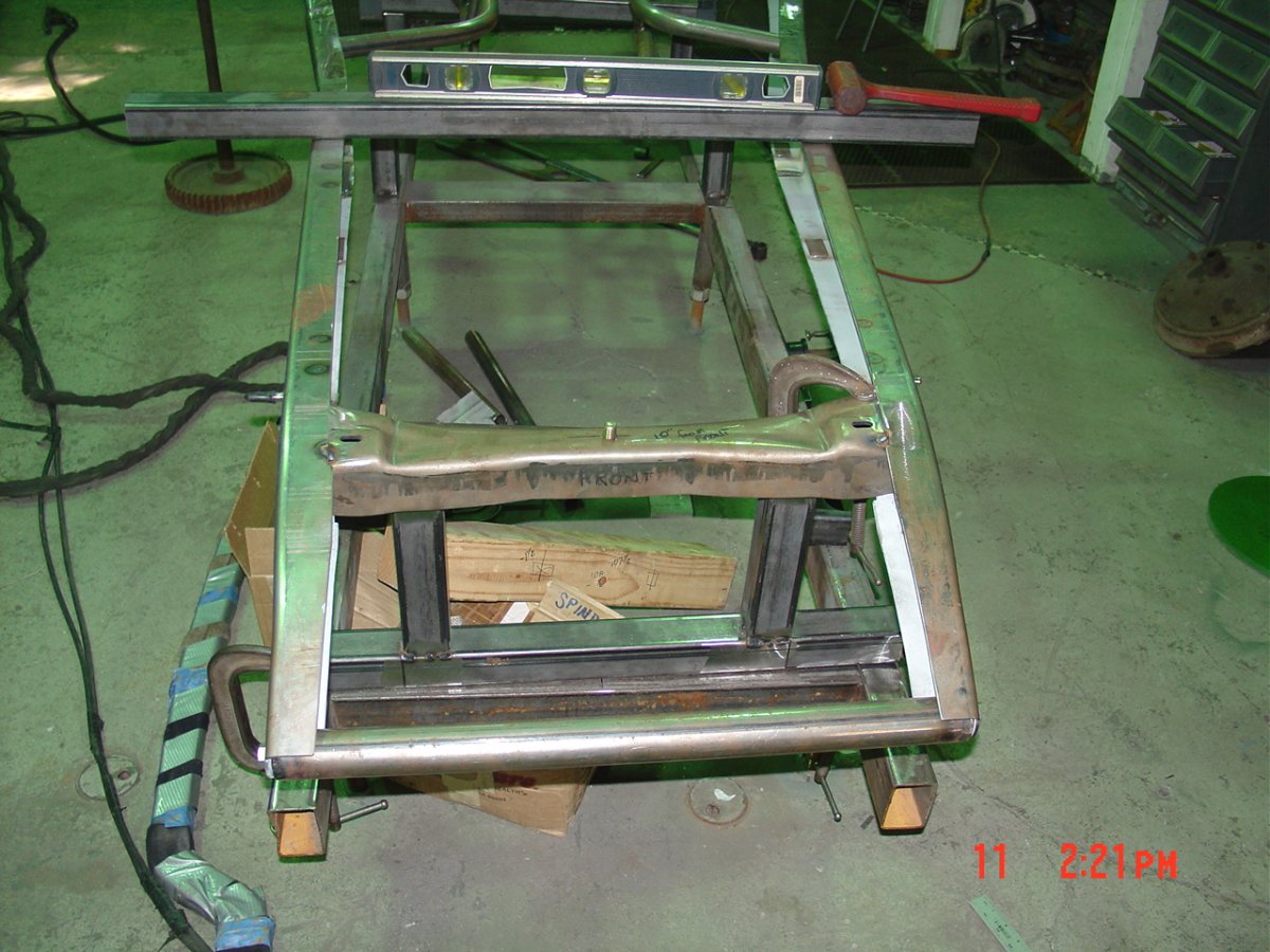

    More frame progress:
    The front crossmember is finally tacked in and boxing plate "backstops" are welded into place.
    Then boxing plates are clamped into place and center and rear crossmembers are positioned. Also, the rearend housing ends are cut off in preparation for narrowing.
    Looking at these pictures is like watching ultrasounds of my kids. :D

    ... while I mocked up the rear wheels/tires & body to determine required axle width:

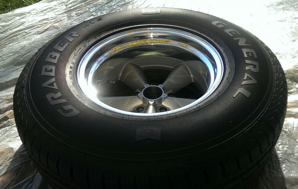

    I gl***-beaded the Fenton Gyro front wheels and polished their outer lips, both front and back. Their centers will get painted to match the ET-III rears. The polished/painted treatment lends a more of a purposeful- less showy- appearance.

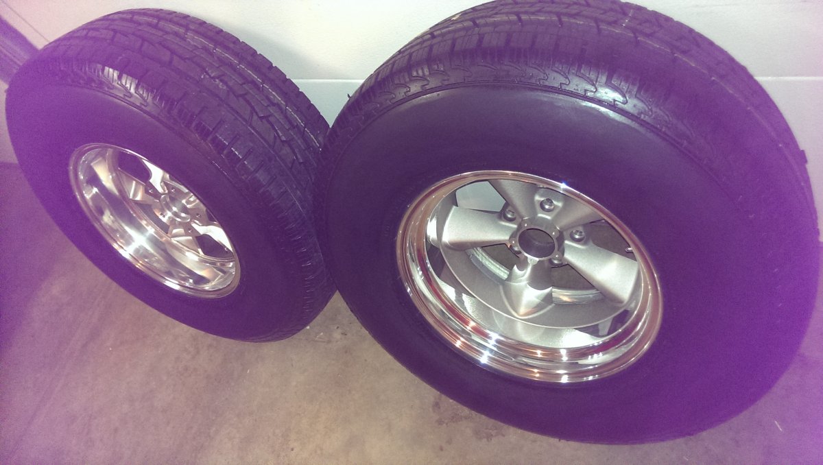

    Watching! Care to share tire and wheel sizes? Nice combination of height and width
