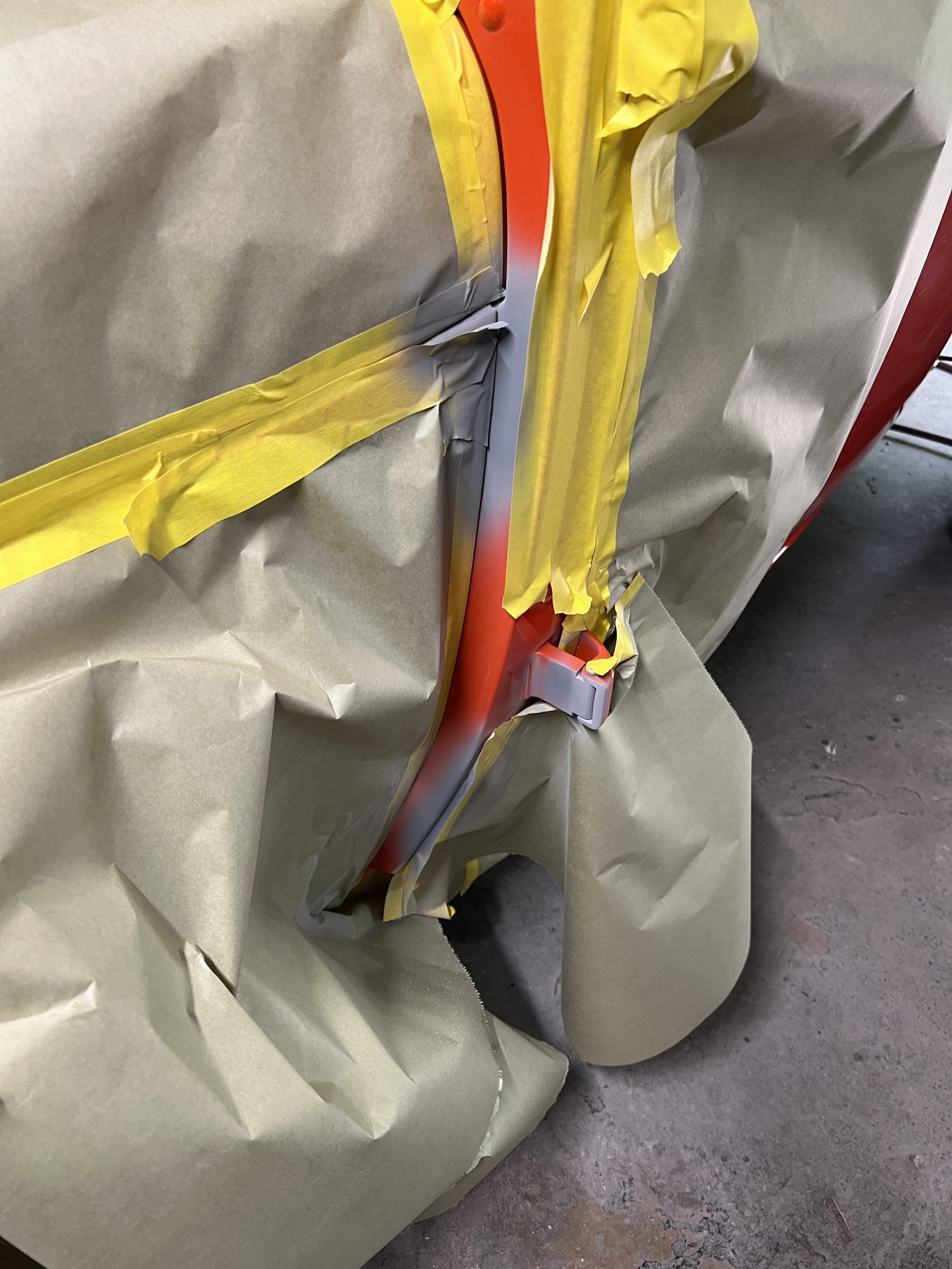

    Roy repaired my ***embly scratches...:oops:
    ...then color sanded and buffed everything.:cool:
