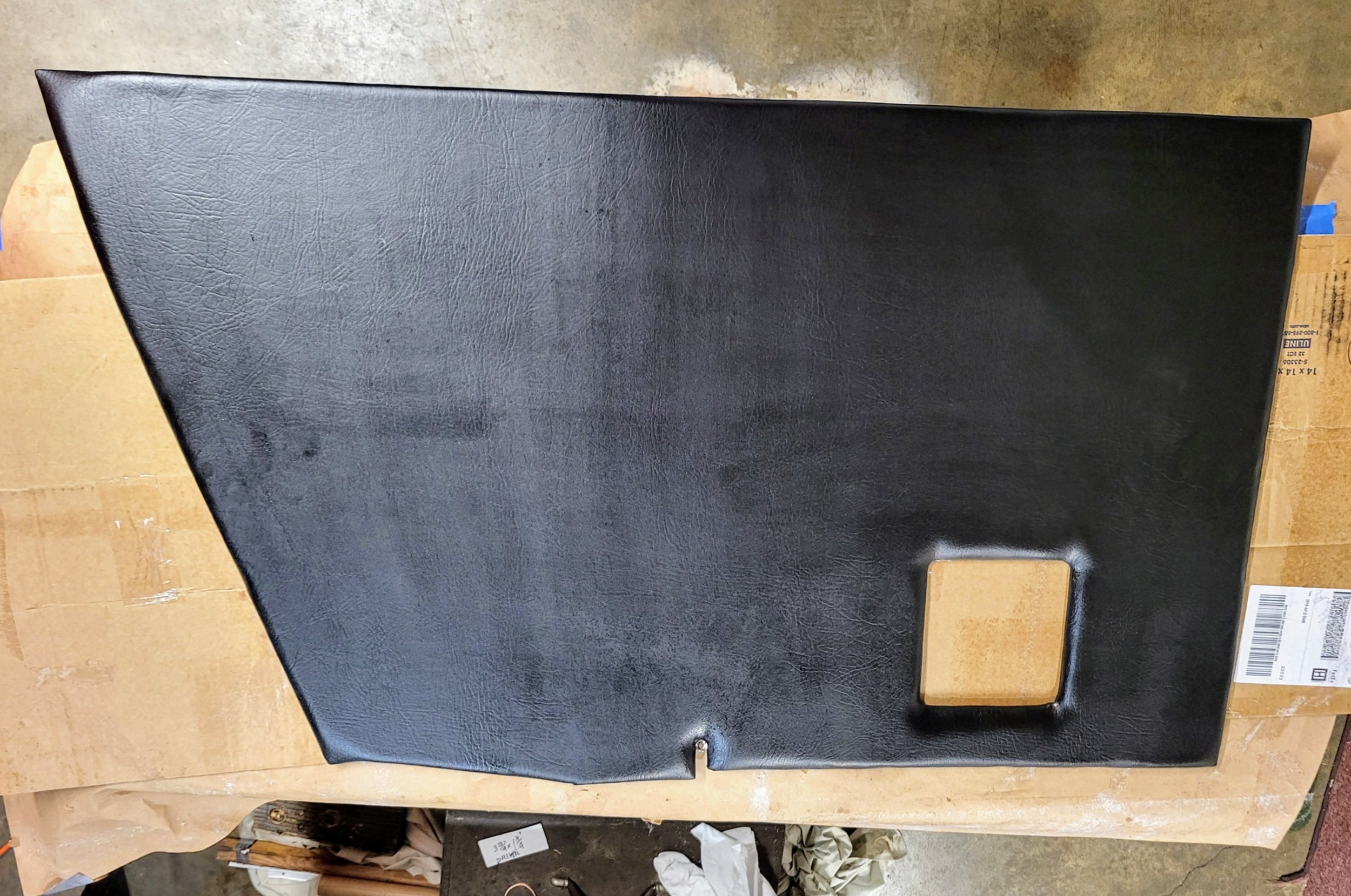

    First, came butcher paper patterns.
    Then 1/8" thick plastic-coated hardboard. I cut it a bit large and "snuck up" on the final size.
    20250802_184447.jpg 20250802_184500~2.jpg 20250802_184557.jpg 20250802_184620.jpg
    More shortly.
    Stogy, Joe Blow, Tim and 14 others like this.
  13. chevy57dude
    Joined: Dec 10, 2007
    Posts: 9,649
    chevy57dude
  14. Just Gary
    Joined: Oct 9, 2002
    Posts: 5,811
    Just Gary
    Auveco #808 trim clips attach the doors.
    https://www.amazon.com/dp/B0058W0FDC/?tag=atomicindus08-20
    3M-90 spray adhesive (expen$ive but seems worth it) attaches 3/8" foam to the hardboard.
    I slightly beveled the foam edges with a Dremel.
    Then Hobby Lobby black marine vinyl is glued to the foam. Its texture matches the seats.
