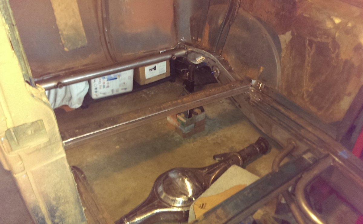

    I bobbed the rear frame horns just inside the body…
    …then cut away the still-solid rear seat mount, floor & rear subrails, retaining as much stock metal as possible. Yes- that’s the original 1928 green paint.
    I had to trim the body’s rear cross-brace to clear the frame horns & upper coilover mounts.
  10. Just Gary
    Joined: Oct 9, 2002
    Posts: 5,812
    Just Gary
    Then I fabbed new subrails: 14ga 1”x2” rectangle tubing sliced lengthwise, pie-cut, bent & welded to match the frame’s curvature…
    …and a pair of vertical 16 ga. pieces that connect the new subrails to the existing body.
    I welded everything together… and also attached some of the old subrails’ remnants to the new subrails for a more integrated look.
    …then made some 16 ga. boxing plates for the body’s rear cross-brace and welded them in place.
    Finally, I tacked one of the still-Ford-green transverse cross-brace to the new subrails near its original location. It’ll probably get moved later; depending on rear seat & gas tank location.
    Thanks for looking!

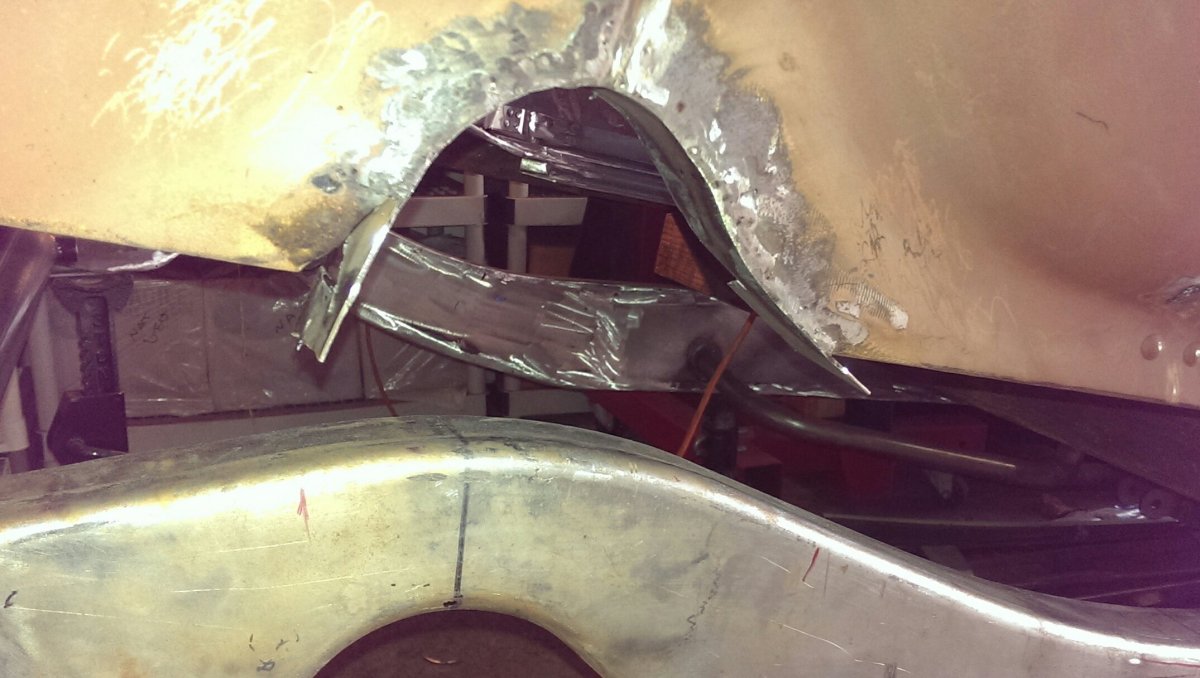

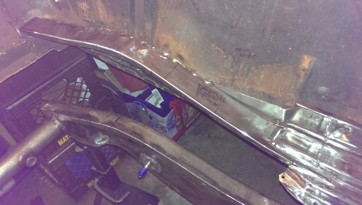

    A little progress during this year’s Washington DC blizzard:

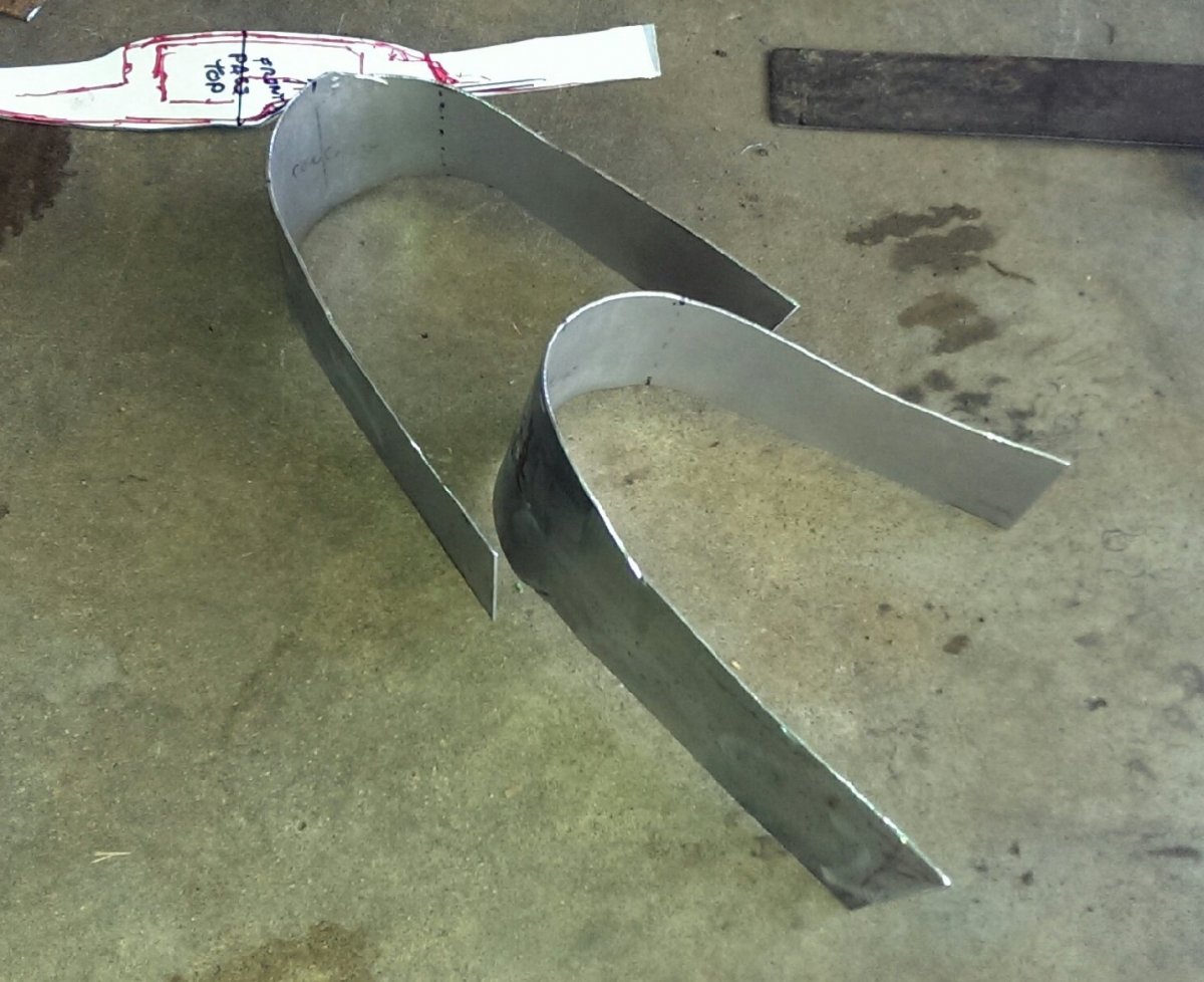

    I cut c-notches in the body to clear the rear axle. Then cut 16 ga. sheetmetal strips, bent them around a pipe…
    …and welded them between the outside of body and the subrails. Finally, I trimmed the excess and ground everything smooth.
    Now the cutouts follow the frame rails’ curvature:

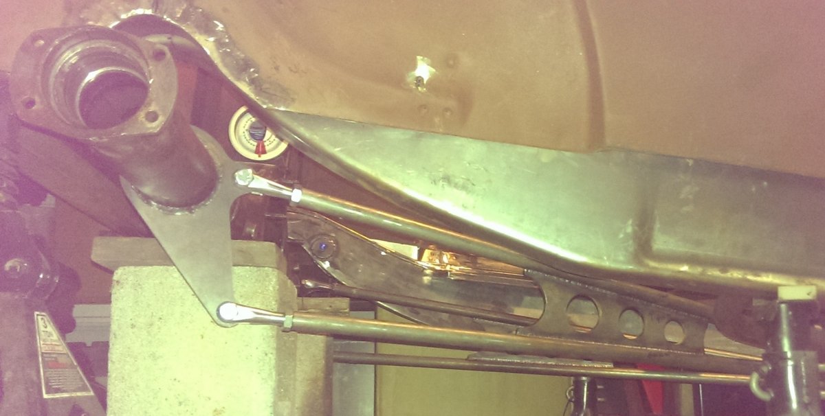

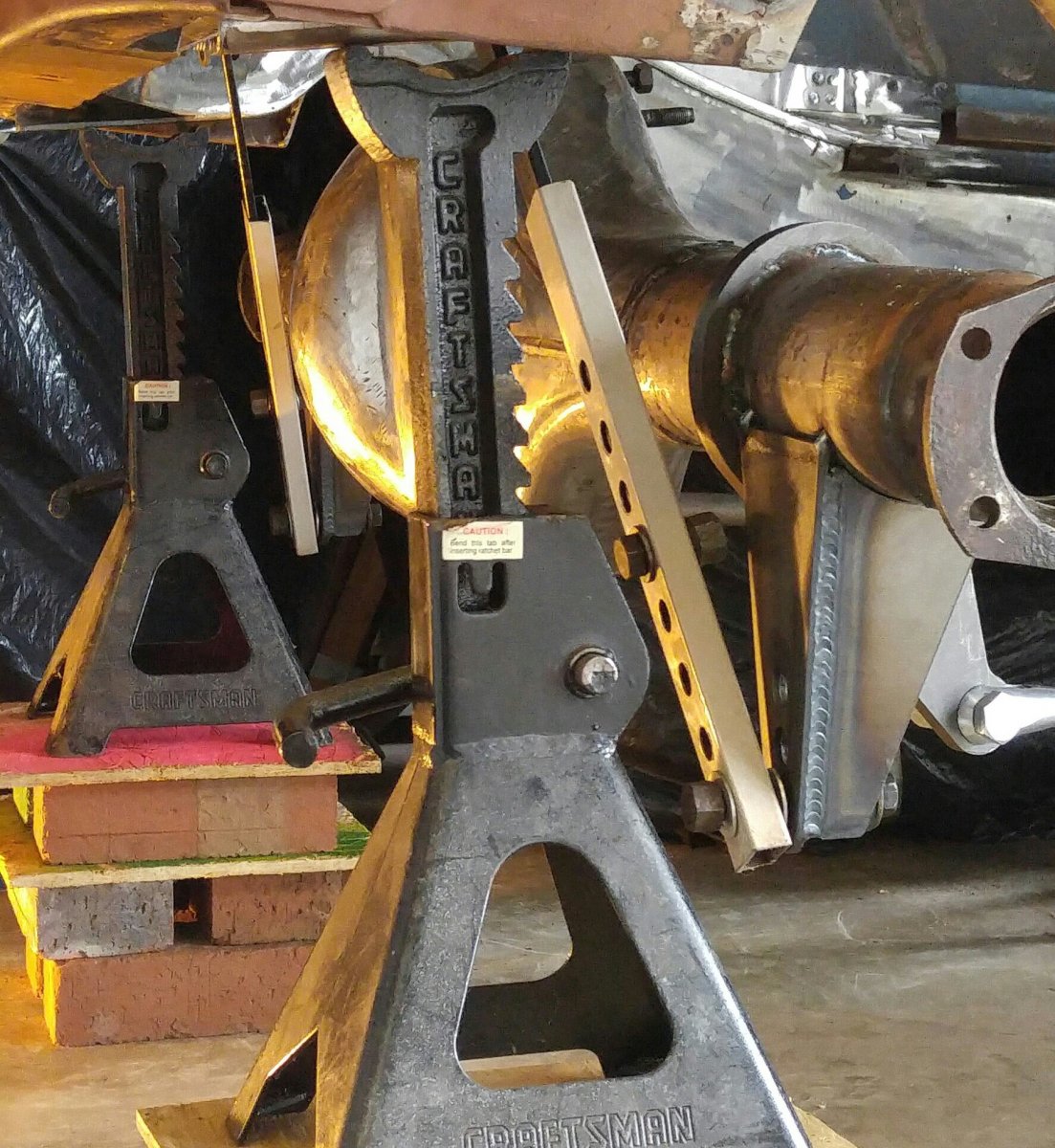

    After bolting on the ladder bars; measuring and cross-checking, I tacked on lower coilover brackets. They’re extra-long for greater shock travel.
    … then made some adjustable “coilover subs***utes” from s**** metal and bolted ‘em in place. They’ll allow choosing just the right ride height so the tires are centered in the wheelwells.
    I’ll get coilovers and a panhard bar with next month’s allowance.

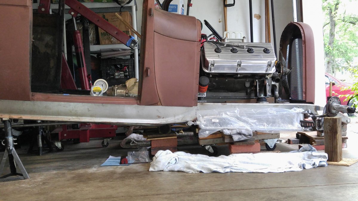

    After consulting with OJ and a whole lot of eyeball engineering, I positioned the engine & ******:
    • High enough:
      • for 4-into-1 equal-length headers inside the pinched frame.
      • for a mechanical steel fan centered in the radiator.
      • to minimize under-frame clutter.
      • but not cartoonishly high or cause excessive driveshaft vibration.
    • Far enough back to allow a thick radiator inside the ’28 grille shell.
    • As parallel with the frame/body as possible--so the car doesn’t look broken in half.
    I'd also sliced a small crescent out of the firewall flange so it clears the distributor by ~ 5/8”.
    Then trimmed the P&J mounts to fit & tacked ‘em in place. Nice & simple, like a ‘60’s racecar ch***is builder might’ve done. :cool:
    I’m tacking in the trans mount now, but it looks just like every other 700R4 street rod trans mount. :rolleyes:
    I’ll take the frame back to OJ for some finish welding. Like Clint Eastwood, I know my limitations.
    Mocked up with the grille shell, headlights, wheels & scoop… in my vast workshop.

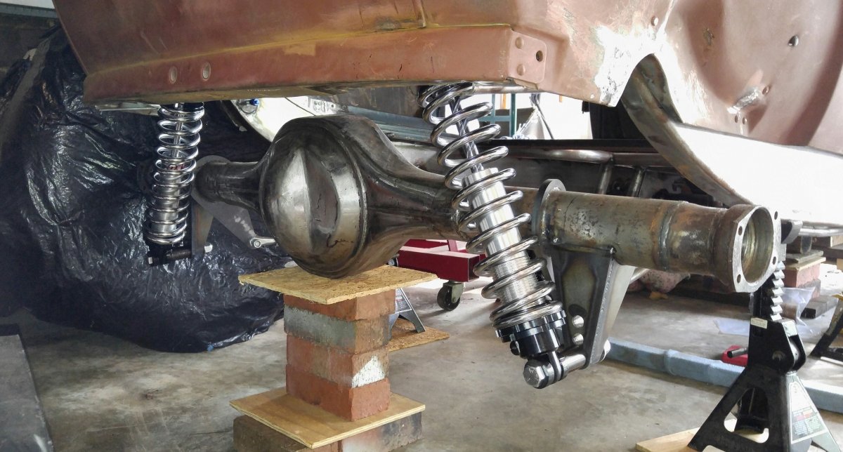

    I scored a set of barely-used QA-1 adjustable coilovers off Craigslist and new #225 springs:

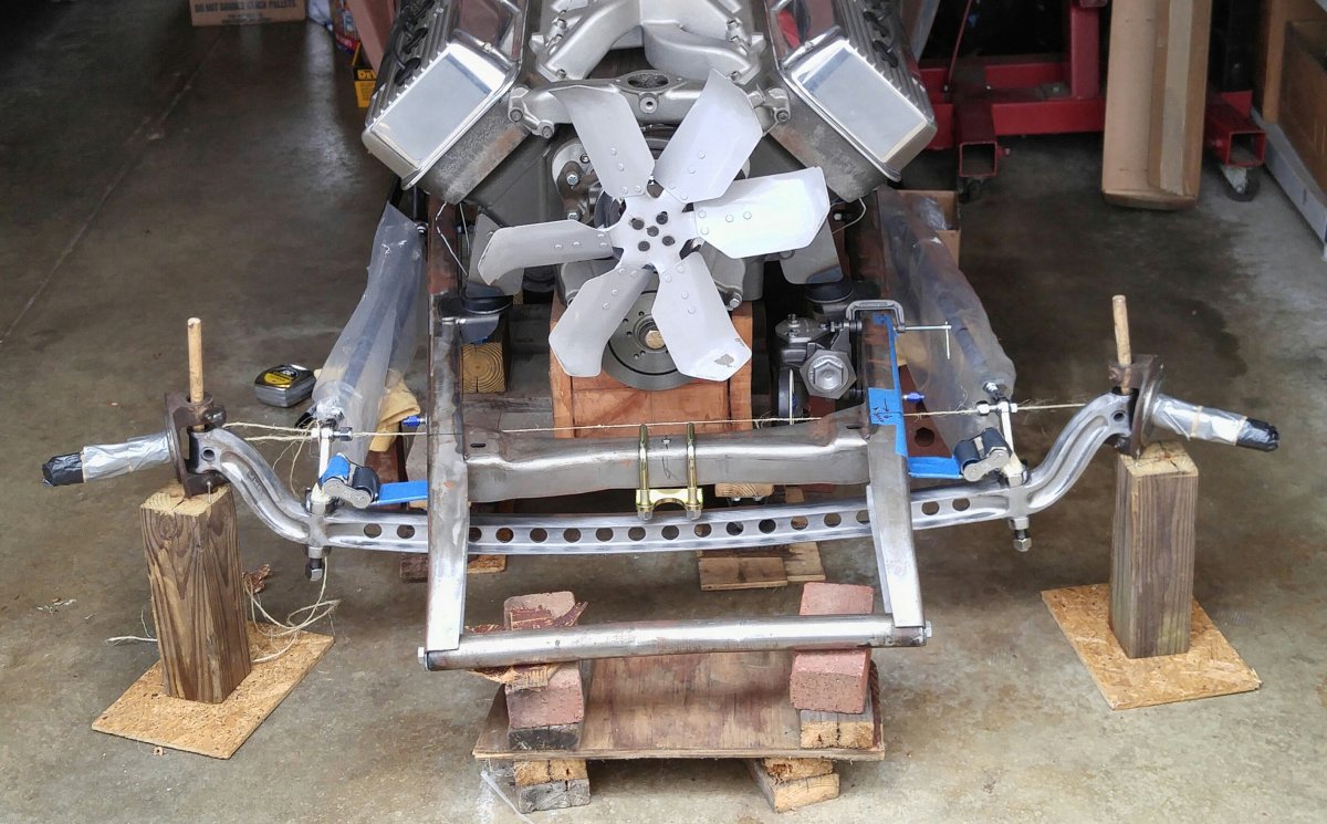

    The front end is a combination of Henry Ford & P&J parts:
    117 Harv inspired me to raise the bar-- sanding and peaking my dropped & drilled ’34 axle just a little more in preparation for chrome::cool:
    Thankfully, Jason Slover hooked me up with P&J’s last Borgeson Vega steering box, after Summit strung me along for four months:
    Sparkly chrome P&J hairpins, perches, and a Posies “superlow” leaf spring, with ’40 “round-back” spindles at the ends.
    The frame desperately needs to be c-notched for spring clearance and the spindle arms will need to be lowered to fit.

    Thanks guys but honestly, the ***ulative knowledge & enthusiasm on the HAMB is what got me this far. :)
    Next step is to bend the spindles' steering arms, then ***emble the rest of the steering.
