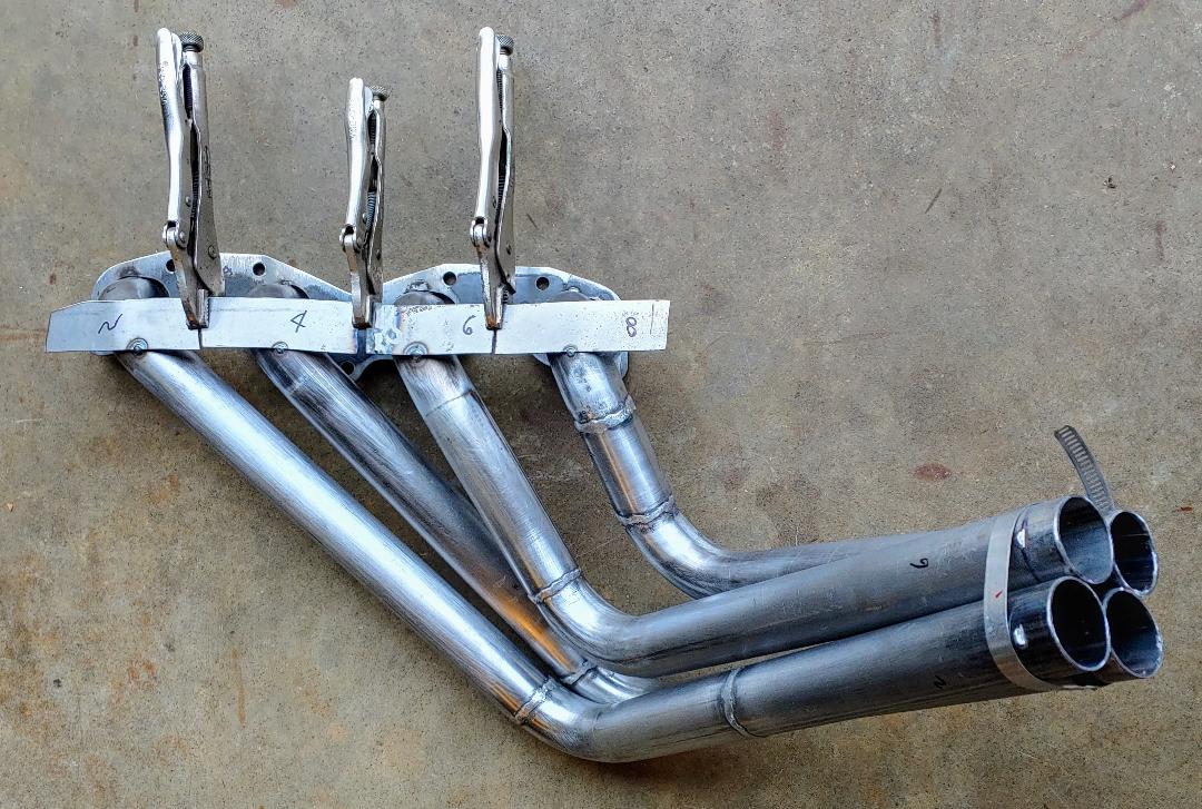

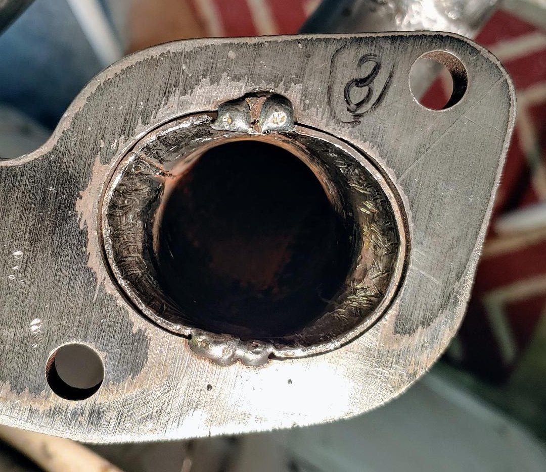

    Nice work, love the headers!

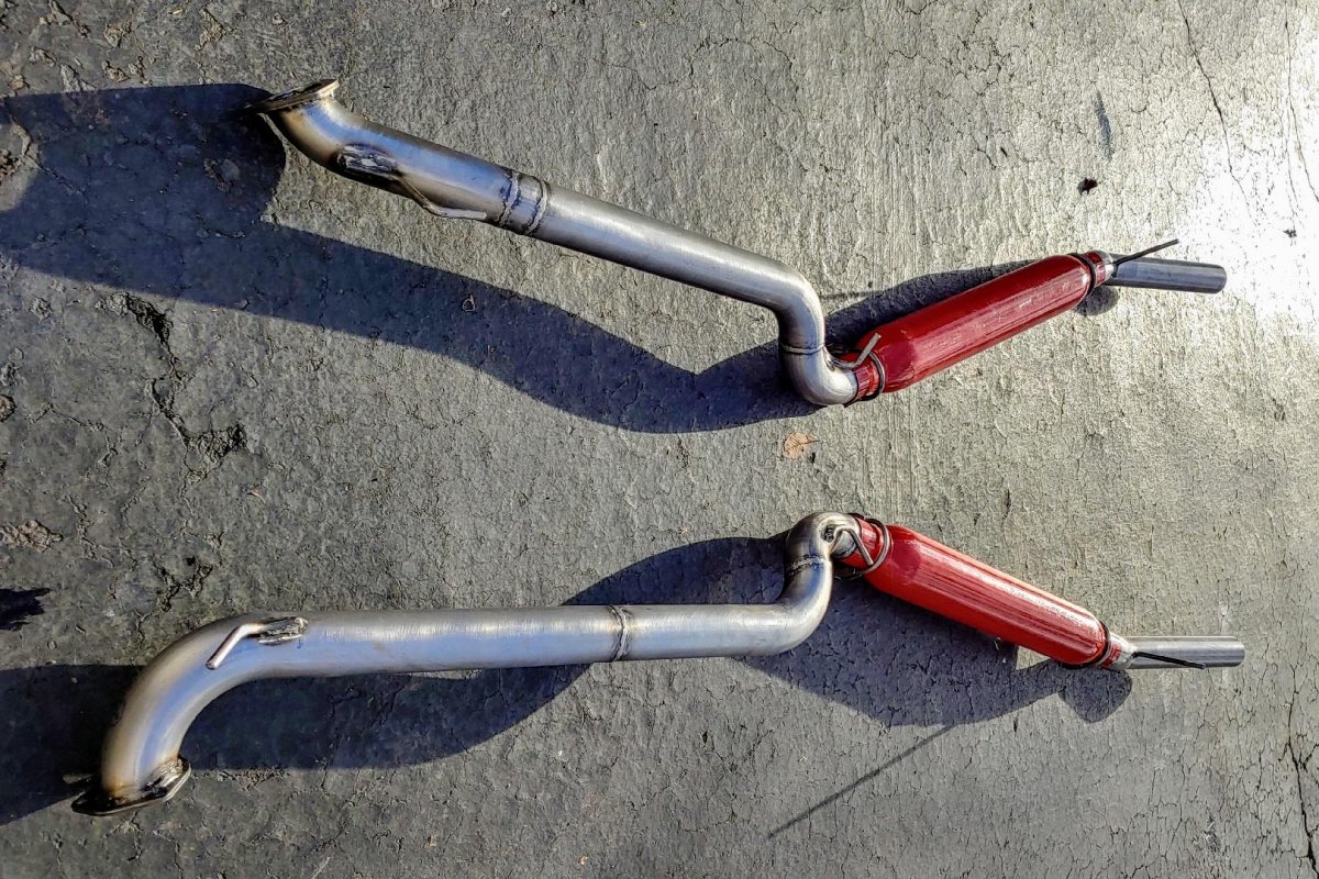

    Great job I like that style going back into the exhaust system. That USED to be mandatory on NHRA Drag Cars back in the early 60's

    Really nice job on those headers man

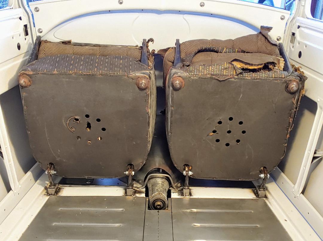

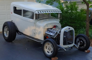

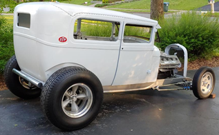

    Stock front seats are lowered in back using thinner Model A "feet cups":
    Then moved outboard and raised just a bit in front.
    This reclined position mimics my daily driver's ergonomics, clears the huge trans tunnel, and leaves room for a driveshaft loop and short tunnel.:cool:
    I'm 6'2" and even with the top chop, have just enough headroom.:)
    Rear seats pivot around a 1" square tube frame, which is bolted to tabs welded to the subrails.
    Their rear inboard corners rest on the rearend hump.
    I ran out of MIG gas shortly after tacking everything. :oops:
    "Simplify, then add lightness." ~ Colin Chapman; Founder, Lotus racing team & car company

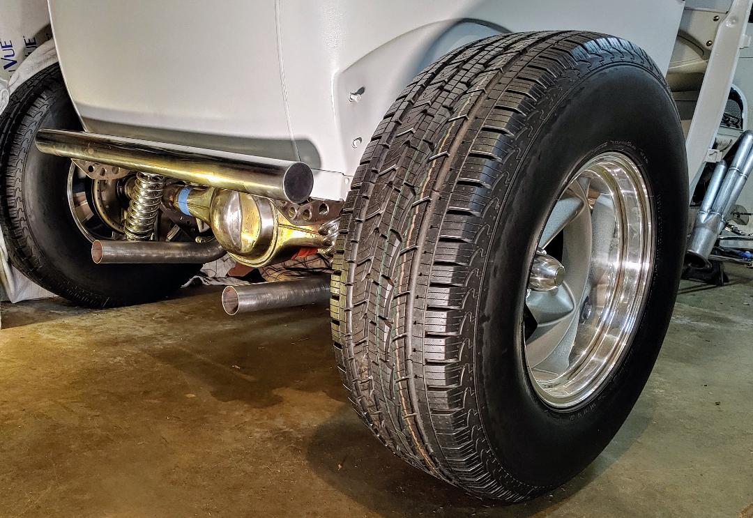

    Just finished the entire thread!! Super build I like it a lot, But.......(you knew that was coming!) I would like to see the tailpipes out the rear much larger in diameter. Really make a statement! Maybe even flared trumpet-style. Although 2 1/2" is large for most street rods yours is more Altered looking soooo it needs to be more radical almost to the ridiculous.
    Jus say'in not nit-pick'in.

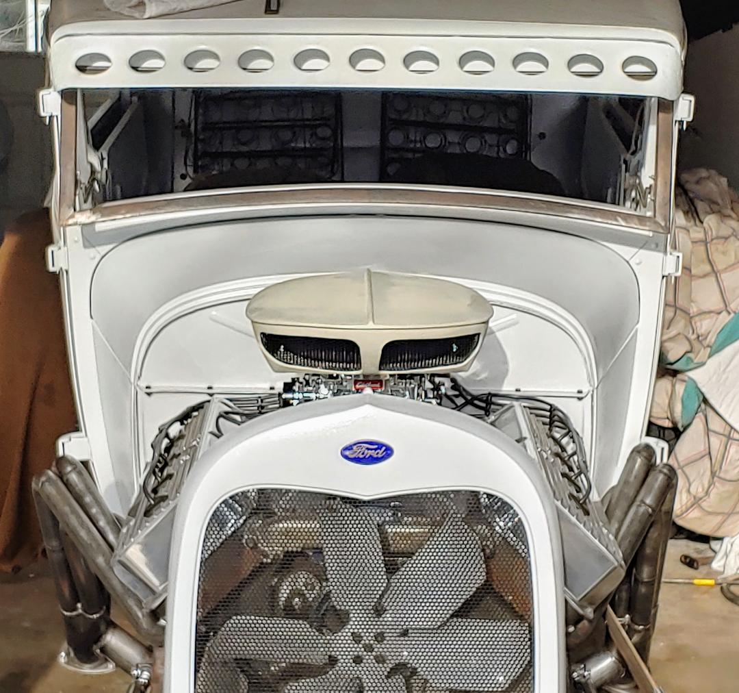

    The Wayne Ewing-fabricated Greer/Black/Prudhomme dragster scoop "makes me feel kinda funny, like when we used to climb the rope in gym cl***.":D
    I copied it but with an air filter inside; starting with a 9"x5" tall cardboard buck.
    Next was a male scoop buck around that, using school locker sheetmetal and cardboard...
    ...reinforced by plywood.
    The top rib is a s**** of 1/4" all-thread.
    Cut, bend, tack, critique, repeat... Until the shape is right.
    I covered the buck with three layers of fibergl*** cloth & resin...
    ...then Evercoat Rage Gold filler:
    A wood block with a 1/2" slot made a perfect sanding block to keep both the top rib and the perimeter rim straight.
    Several cycles of filler/guide-coat/block sanding fine-tuned the shape.
    Next, some dark gloss rattlecan paint confirmed it was straight.
  17. Just Gary
    Joined: Oct 9, 2002
    Posts: 5,817
    Just Gary
    I covered the buck with release agent, then made the top and bottom female molds.
    Finally, the top and bottom halves of the scoop itself. Each was two layers of gl*** cloth with embedded metal stiffening rods.
    I shredded their edges really badly when removing them from from the molds:eek: (Insufficient release agent? :confused:) and had to fix them before continuing. :mad:
    The inlet screen came from the same office ventilation duct screen as my grille insert.
    It's held in place with gl***ed-in studs and lock nuts.
    Three 18 ga. triangles are plug-welded to the K&N filter base. 1/4"x20 machine screws & gl***ed-in nuts connect them to the fibergl*** scoop.
    Then, a couple layers of cloth & resin join the top & bottom halves.
    Finally, a light primer coat and mounted:
    20200310_171010_2.jpg 20200310_171619_HDR_2.jpg gbp 32.jpg 20200310_171514_HDR_2.jpg
    This was my first fibergl*** project and it needs some clean-up work, but I'm pretty happy with the results. :)
    BTW, these pics were taken four years ago but I didn't have a carb to mount it on until this past Christmas, compliments of my beloved but long-suffering bride.:rolleyes:
