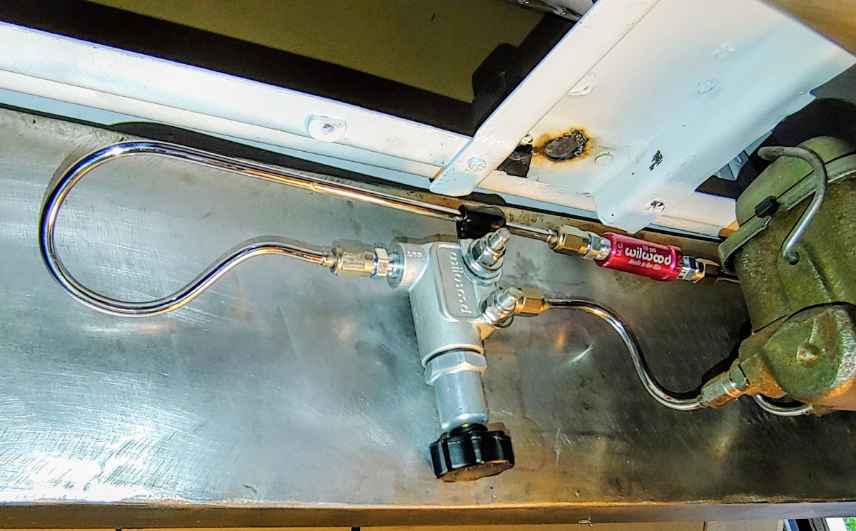

  10. The big ol' fuel tank filler & adapter combo got replaced with a better-fitting one from RCI.
    Carter P4070 pump & custom hoses from @D-Russ & @oj, respectively. Really appreciate your help, guys! :)
    Inline Tube sells 6' straight (not coiled) stainless steel tubing.
    The 3/8" fuel line has an 85-micron filter back between the tank & pump and a 40-micron filter just before the carb.
    May add a regulator later if needed.
    Yeah- I'm kinda nerdy about neatly routed hard lines.
    Must be the residual US Navy in me :rolleyes: or maybe Scott Sullivan's @cheezwiz '55 influence.:cool:
    Tight bends are way easier with 3/16" brake lines.
    Rubber-coated clamps try to preserve the '60's race car theme.
    No one will see these details when the floors are in place. Oh well- I'm having fun.:D

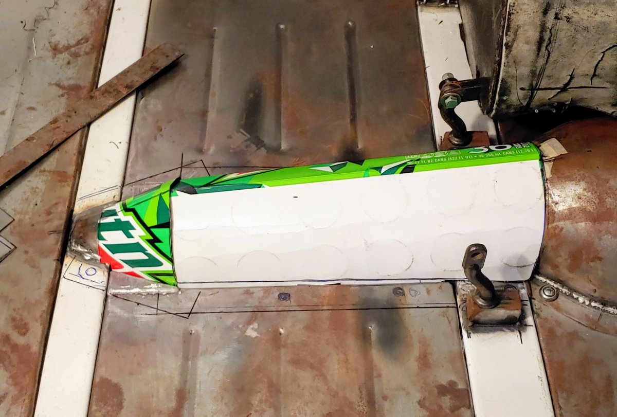

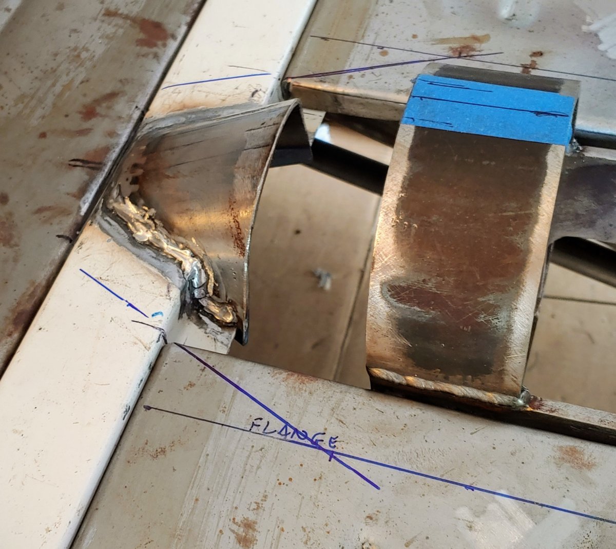

    Next, I fabbed an NHRA-spec driveshaft loop from @Dino 64 's 1/4" thick schedule 40 pipe & 12" x 12" box.
    Had to bevel the edges a bit and crank the welder "up to 11" for good penetration.
    It's integrated into the frame's center x-member, uses grade-8 fasteners, and surrounds a 3" steel driveshaft.
    Mounting the engine/trans high in the chassis reinforces the Fuel Coupe theme...
    but REALLY complicated real-world street car packaging.
    (Never mind having to re-measure driveline angles a million times) :oops:
    I cycled the rear suspension to check clearance, then cut and reinforced the body cross-braces.
    20200906_160704_2.jpg 20200907_102219_3.jpg 20200909_145934_2.jpg 20200909_145112_2.jpg
    The driveshaft tunnel has 16 ga flanges & 18 ga arches, same as the trans tunnel.
    It's a REALLY tight fit between the seats.
    Reinforced lap belt mounts will follow later.
