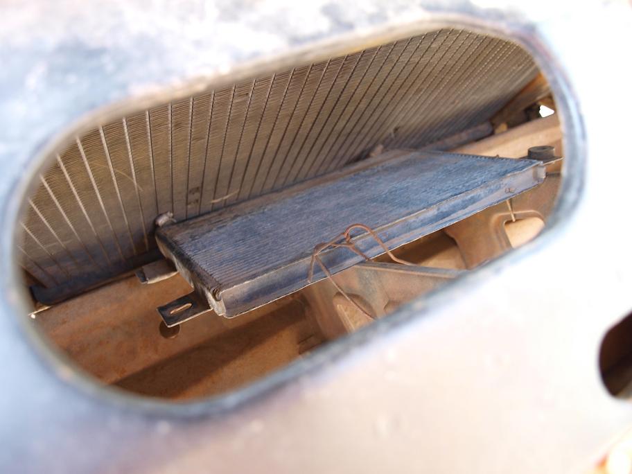

    1.) Radiator pic. I've attached a pic of the radiator. I can't tell if this radiator is for this car or not. Cap is in the center of the radiator - the fins look to be "modern core" style "high efficiency." But the tanks don't look right - the overflow - I can't remember seeing that on an edsel before like this - and also the transmission cooler is not hooked up on the car.

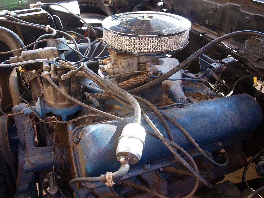

    3.) Engine. It's the 332 (I'm pretty sure) - and a 2bbl carb. Non-stock air cleaner and new fuel pump. It "Ran." When I had disconnected the vacuum hose for the wipers the idle went WAY WAY down. So - there's ONE vacuum leak I need to fix. Also in going over starting the engine - I realized I think the "Stuck valve" is NOT stuck. As it was flooded and I would turn it over it would "stumble and hesitate on the same cylinder each time and pop through the tail pipe consistently on another. I think two plug wires are swapped. That would be good if that is the case.

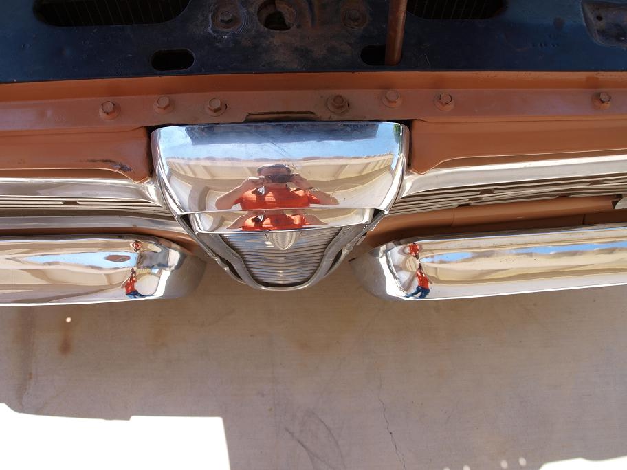

    5.) Bent grill. It'll look good on the wall - eventually. The fender is pushed in. Will have to straighten the mounts (thats all that was bent there - can't find the pics I took of the mounts.

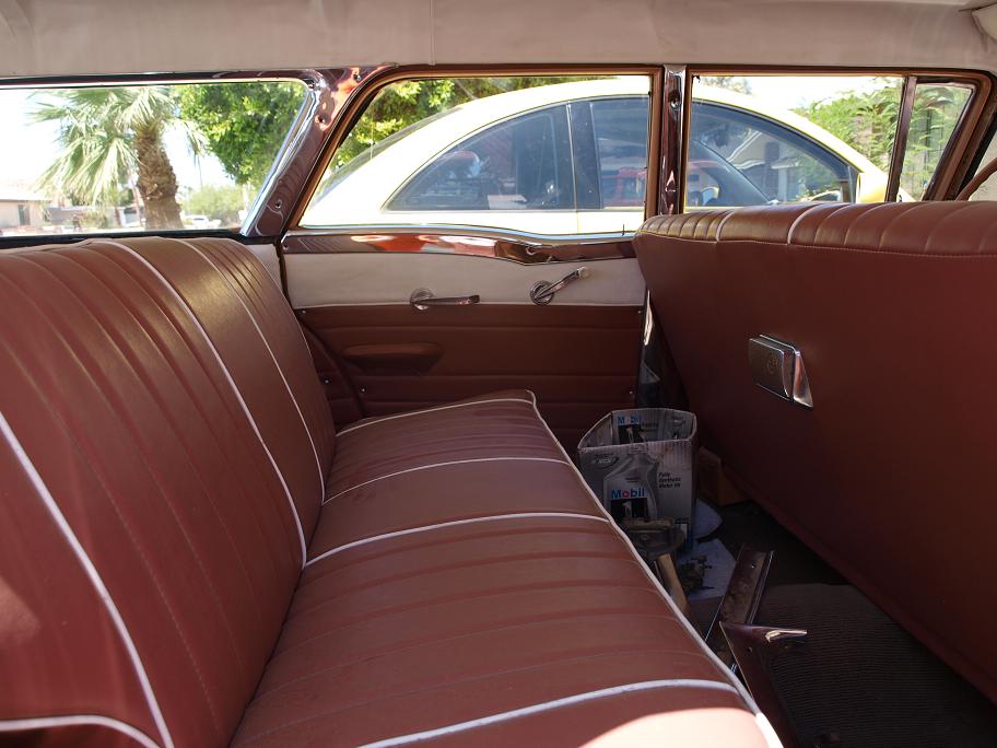

    6.) Rear interior shot. Notice the chrome window trim. I can't find an instance of this in my research. Was this something Ford did - and someone put those pieces on an Edsel or what?

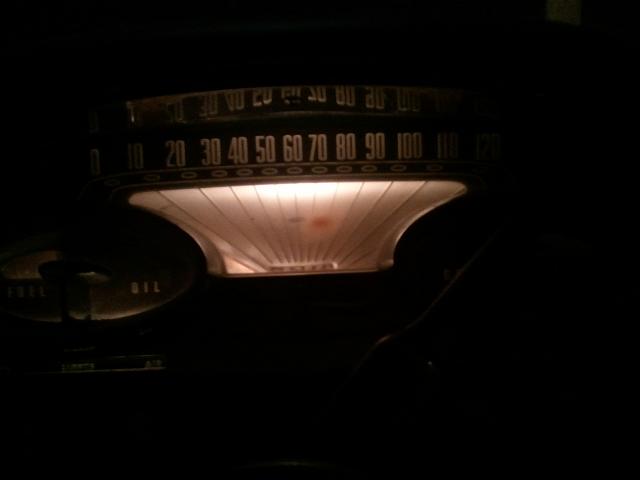

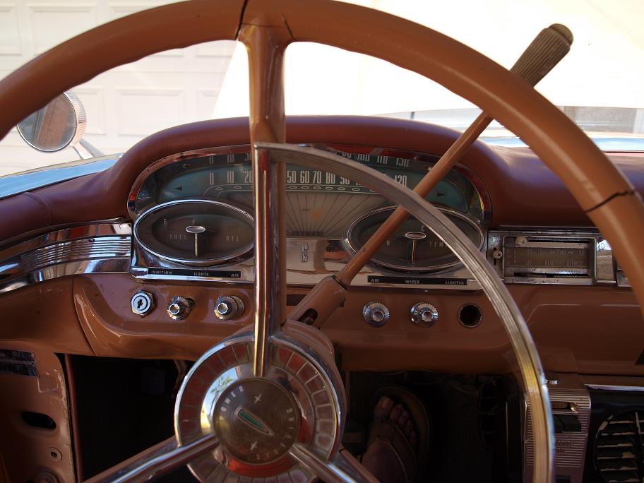

    7.) Dash. Light overspray on the speedo - also that does not work. Will have to see if its a cable issue. Lights work - but here's the BIGGEST problem. No turn signal quadrant - and no lenses or housings in the front bumpers. I think the bumpers were pulled for the repaint and were never replaced. They're now lost. Will a ford signal quadrant work? Anyone have a good pic of one?

    The radiator looks pretty modern, I don't recognize it but it could be for a later ford or mopar or rambler, might have had the original bracket swapped onto it? Any numbers on the tank?

    Radiator is definitely not stock. Wheels probably are. The chrome interior trim is interesting and not original. I don't recall if the higher priced Fords had that, or else someone had it plated.

    Im guessing the chrome garnish moldings were done by someone who wanted to spiffy up the inside. From what I've seen, in that era car interiors were made to look uniform inside, so they painted the garnish to match the rest of the trim. Convertibles usually had chrome moldings inside around the windshield, but all the other body styles would be painted. But that's just a general observation, it's possible that FoMoCo did some weird stuff.

    So - on to today's findings - Day 1 with the Edsel.
    After the last post - I got the idle down to a reasonable level (found one last vacuum leak - pencap in vacuum hose fixed that) and took it for a drive.
    :DHoly **** I'm driving my Edsel!:D
    I also noticed MAN - this thing is SLOPPY. Like BAD sloppy. So thats going to be project 2.
    Why 2?
    Because I need it to run under its own power first - and not kill every mosquito within miles.
    You KNOW it's running rich when you stand behind it and your eyes burn.
    So - Into the carport - up went the hood - and off came the carb.

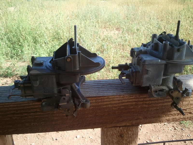

    I checked the carb that was on it with the one I rebuilt. Different carbs for sure. WAY different. So it's off to the parts store for a rebuild kit (again). I also noticed the old mechanical choke was "STUCK" - so I think that's going away - and I'll replace it with the electrical one from the later carb - looks like it will work.
    Once thats done - I'll pull the valve covers to see what needs to be done with the valves. I'll pick up some cleaner and get the carbon off the valves.
    I'm just stumped about the steering. I'm no Edsel expert (coming from the world of VW's and Model T's). I'm attaching a pic of the linkage that I can see without jacking it up. What do you think - PS or Non PS car? I'm thinking PS.

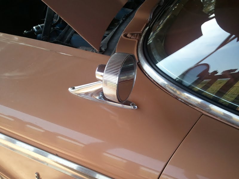

    I'm also missing a side mirror (p***enger is missing). I remember seeing the hooded "Edsel" mirrors - but don't remember these - are these normal for 59?

    Aaaannnddd.....I just noticed the brake pedal
    "Power Brakes"
    And found the crimped off vacuum line....
    So someone removed the power brakes - and power steering systems.
    grrrrr
    At least the Power Brakes are easier to retrofit.

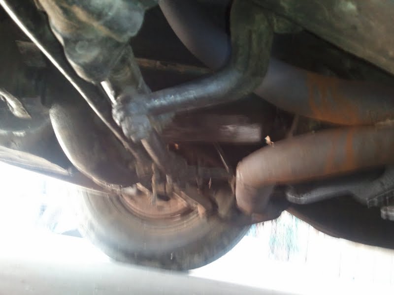

    The big thing I noticed is a threaded bolt like appendage coming off of the tie rod / drag link. I think this is for the Ram.
    What are the big differences between a non power steering system and a power steering system?
  23. Jeff Walker
    Joined: Feb 6, 2007
    Posts: 498
    Jeff Walker
    Yeah, it's a power steering car. I can see the control valve on the one photo, it's the part just to the left of the pitman arm off the sector. The original power steering setups on these were OK but over time had lot of places for leaks.
    The power steering on these have a slave cylinder under the car that provide the ***ist via the control valve (the part just to the left of the pitman arm on the drag link. That means you have four hoses, a pump and a slave cylinder that can leak.
    To convert it to manual steering is not very difficult. All you should need to do is swap out the drag link, idler arm, and possibly the pitman arm.
    The biggest reason you have all the play in the steering right now is probably because you are running a disabled power steering setup.

    BTW the mirror on your car looks to be from an early 60's style Ford mirror. The hooded mirror that you were talking about was available in 59 too. Also exterior mirrors were NOT standard equipment, but an option, thus the reason you see several different styles of mirrors on cars from this era.

    Hey Jeff! Thanks for the info. I actually did a search on Ebay and found a matching mirror - yikes - ad says they're rare. Hrm...we'll see. If they are, I'll try to find something a little more useable.
    So...on to Day 2 of the Edsel Chronicles. LOL :D
    Today, after being productive (mowing the lawn and such), I got into rebuilding the carb. WOW - this one is a LOT more simple to rebuild than the other Ford 2100. I did use the electric choke off the newer carb instead of the old mechanical version and also used the mixture screws as one of the stock ones was bent.
    I checked the float height before the rebuild and after. They were identical (never had THAT happen before) - installed and fired her up - fired right off without a hitch.
    I did adjust the mixture screws a little. Still running rich - I'm wondering if the jets are far too big for this engine. The carb does look like it was rebuilt sometime in the past.
    Next I'll be pulling the valve covers to see which rods are the culprits. BTW - is it possible to just "unbend" the pushrods in order to "just get by" to see if this causes the car to run better? Or am I asking for trouble?
    I also posted a vid - post carb rebuild so ya'll can hear how she's running.
    It has a single exhaust with a cherry bomb on it (for now).
    http://www.youtube.com/watch?v=0ez5AvgehSM
    Will report back later with Lifter Info.
    Enjoy!
  28. rprice76
    Joined: Jun 4, 2011
    Posts: 441
    rprice76
    from Palominas
    Conclusion day 2.

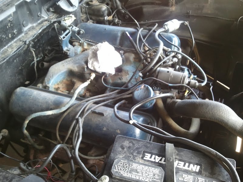

    Well after about two hours of work - I managed to get the valve covers off and fix the pushrods.
    :eek:
    Um....the inside of those valvecovers was GRODY. I mean seriously funky. I had to get a shop vac out and clean out all the gunk and flakes of "God-Knows-What."
    I soaked everything down with brake cleaner - and then soaked with marvel mysery oil.
    I found two bent push rods. Number 6 exhaust, and number 2 intake. Neither valve was stuck. I unbent the pushrods as best I could for now.
    The one issue I noticed is when I put the pushrod back in number 2 intake, it dropped in a little further than I thought it should. I got it lined up pretty well - and fired the engine back up - and the tic noise was there for a second and then disappeared.
    *shrug*
    Dunno if that was from the lifter pumping up - or what.
    It still seems like I have a miss somewhere. I did put MM down the carb as I was running it - BOY did it smoke like hell - then cleared up. I also put a little in the crank case and in the tank.
    I was going to go out for a second voyage when I ran out of gas at the end of the driveway.
    Let me tell you - I was NOT prepared for that. I only had a gallon gas can with a half gallon in it. I then went to the local store for more (5 miles away) and came back and put the other gallon in. That allowed me to ALMOST get back to the carport. :rolleyes:
    Guess I need a bigger gas can.
    Anyway - I uploaded another vid of the engine running post push rod fix.
    http://www.youtube.com/watch?v=-_Ndh5x0He8
