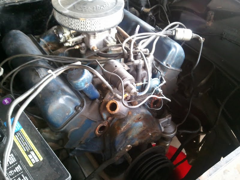

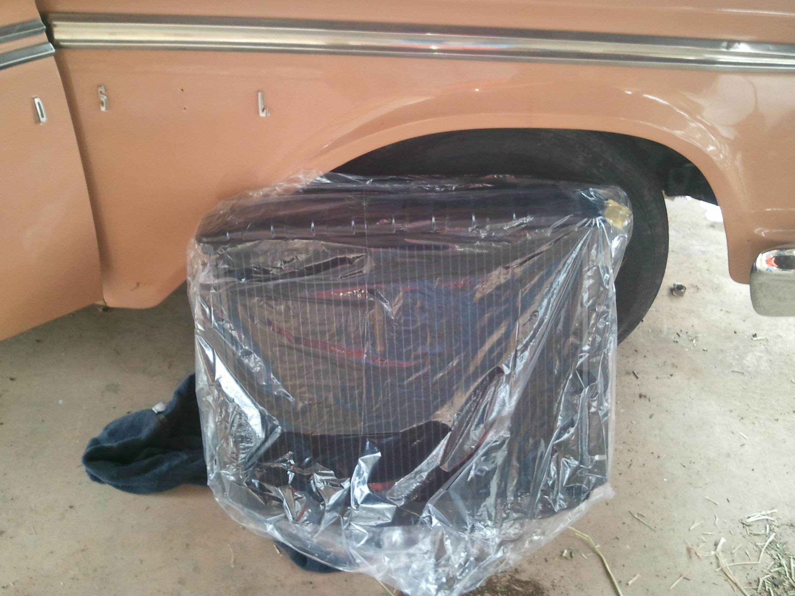

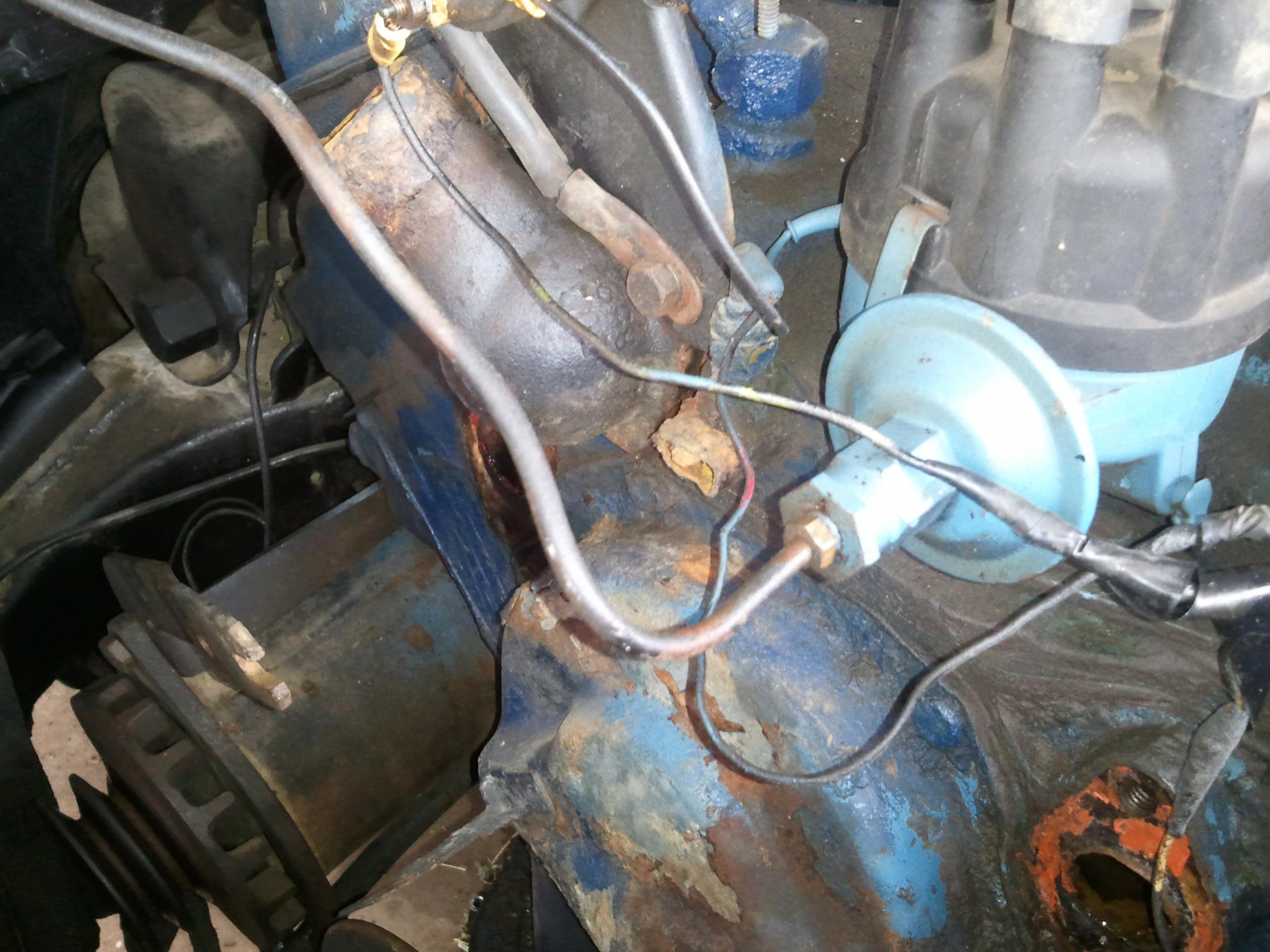

    Update 9/10/11
    Hey Folks - time for an update.
    After a LONG week at work, and a quick trip to Tucson yesterday, I did some work to the Edsel.
    The old Water pump was making noise and leaking, so a new one is in order. Out went the old - but....not quite in with the new. Looks like the shaft is too short on the new one. D*amn. Well...will check this out at the auto parts store. The guy DID say "The Ford water pumps are all the same."
    Also got the BRAND NEW radiator in. Will have to check the mounts.
    Tomorrow will be cleaning time - painting time - and hopefully - re***embly.
    Someone painted this engine Ford Blue....EVERYTHING Ford Blue.

  17. Jeff Walker
    Joined: Feb 6, 2007
    Posts: 498
    Jeff Walker
    Find your closest NAPA store and order part number 58201 for a water pump and you will get one that is the proper length. Then all you will be left dealing with is the difference between the ****** size difference on the byp*** hose to the intake manifold.

    Thanks Jeff!
    I think I've learned the "all FE parts are the same" lesson. Actually I learned that on the carburetor, but thought that might just be an emissions thing. It probably was - but MEH....lesson learned.
    I'll be returning the late-model FE water pump today. I also will be cleaning up the engine compartment today - maybe a little paint.
