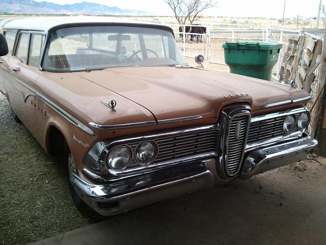

    Sorry for the delay - but a new Niece, work, and the holidays got in the way. However, recently I got the "new" grill put back on, and thought I'd post a few pics I took of it today. The grill is far from perfect - but is perfect for a driver - which this will be.
    Just a few gremlins I need to fix - the tank is cruddy and the gas line gets clogged easy - so I get to pull the tank and get it cleaned - then it's on to brakes - and front end / suspension work.
    Enjoy the pics it's a little dusty from sittin!

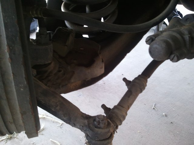

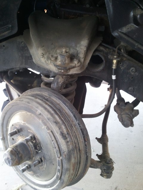

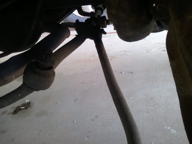

    Quick update:
    So I took the front wheels off, so I can try to find the correct rims for this car. While they were off this morning, I decided to take a few pics. The steering linkage is in sad shape.
    So if I get this right - I need a new drag link, tie rods, and steering box to convert from power to manual?
    Also I may need to do a full rebuild on the suspension. It's worn out pretty good. That MAY be pricey - I've never done one before and may enlist the help of someone more talented.
    The odometer on this car reads 89,**x - that may be 289,**x. Who knows how long the odometer / spedo have not worked!
    Also - the master cylinder is leaking, so it looks like my power brake upgrade may happen soon. I did note the driver's side rubber line was replaced, but not the p***enger side. A full brake rebuild will definitely be in order - to include wheel cylinders, pads, etc.

    Are you planning on going back to factory power steering or a newer set up?
    If you are staying with the factory style I can see that your car was a power steering car as I can see the control valve ***embly on the end of the drag link in the third photo. You will need to put the slave cylinder back on that's missing, probably have the control valve rebuilt or replaced, install the hoses and pump and you will be good to go.
    HTH

    Hey Jeff -
    Thats where I get to the "which way should I go" route. My finances are limited since my daily driver ****ped the bed, and I'm still paying on the replacement for a few months. Maybe I shoulda sunk the money into the Edsel and had that for a daily for a while - but - cest la vie.
    How good is the stock power steering setup? I'm missing some parts - slave cylinder, pump, pump mount - etc. Are they hard to find? Are they available rebuilt somewhere? Conversely how hard is it to go to a manual setup? I have MOST of the original system in place I think.
    Thoughts?

    The stock setup works OK, the only real drawback is the tendency for them to leak over time. Finding the power steering stuff shouldn't be real hard to find as the components are the same as a Ford.
    I am not positive but I believe all you need to change it back to manual is a different drag link, idler arm and possibly the pitman arm. I am fairly certain the tie rods and steering sector are the same.

    I'm not positive, but I would think power would cost a lot more that manual, and just plain more complicated. I would think unless you went with new power components you might end up with having to rebuild the parts.

    I did see somewhere (cannot remember where) that the steering ratio is different in the manual steering box. But I doubt that would make THAT big of a difference. Will definitely have to start looking for the manual parts - I'm not a fan of adding something that could leak.

    Manual steering box & pitman arm fits, only ratio is diffrent, manual about 5.5 turns, power steering about 4.7 turns. I made this conversion 1 year ago, parts came form 1959 edsel, and now they are in my 58 pacer.
    Tie rods are same, you need link with control valve, 4 hoses, pump with bracket maybe pulley too.. You should do this, much nicer to cruise !!!
