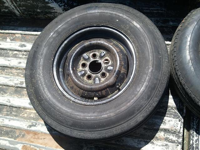

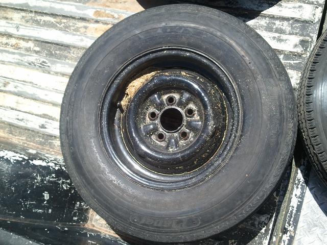

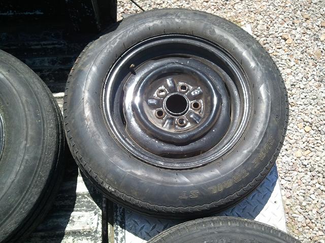

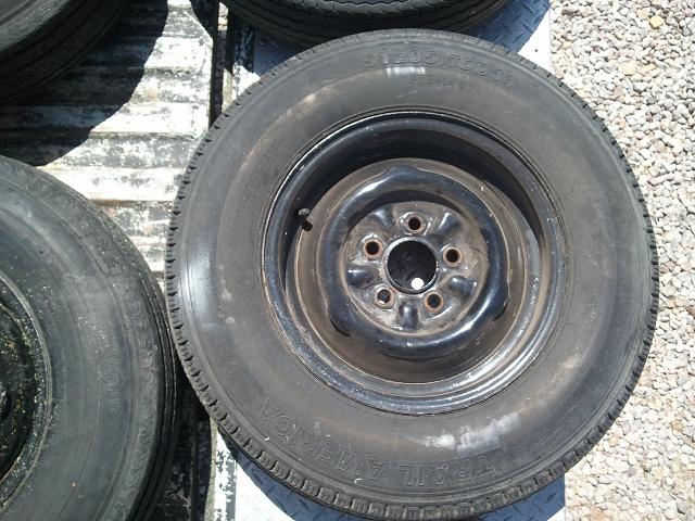

    So I finally got the rest of the wheels of - and put them side to side.
    Well surprise surprise! Only two are the same - and they are stock style 14" rims. The other two? One 14" later ford rim - and one 15" later ford rim.
    Tires on the car:
    75/14
    75/14
    205/75/14
    204/75/15
    I think I'm getting back to needing two stock rims.

    Here are the pics --- wheels 1 and 2 I think are stock --- 3 is more modern 14" and wheel 4 is the modern 15". The last pic shows a stock wheel with the "Dog dish" ford hubcaps.

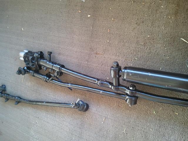

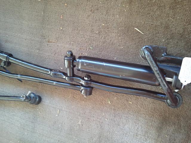

    The steering linkage, ***ist ram, and check valve came in yesterday - awaiting box 2 - pump and misc. Looks good so far. Nice and clean.

    just noticed your photos of the power steering components.all very generic late 50's ford stuff for the most part.the cylinder ram mounts differently to the drag link compared to mustang (if memory serves correctly) but the rebuild parts are the same.
    if the control valve needs rebuilding,pay close attention to the br*** socket inside it where the ball stud slides.it could possibly be badly pitted.

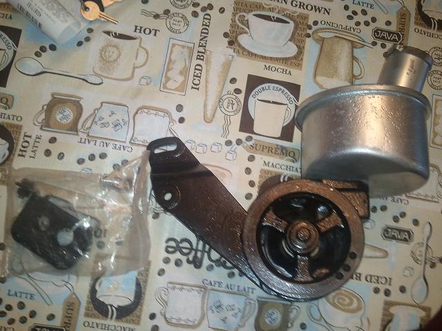

    Good news folks - got a few deliveries...
    Tank is here - as is the PS pump!
    Pump seems a bit stiff - but that's probably better than really loose!
