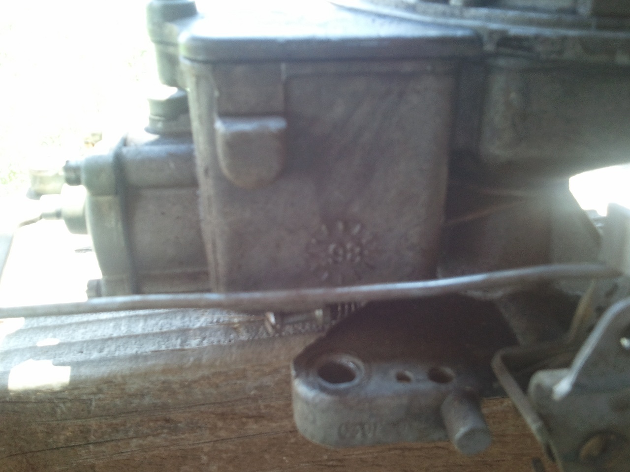

    Well - last weekend I decided to see if I could figure out WHY this thing keeps killing mosquitoes! So I pulled the carb - tore it down - and took a good long look.
    This was a 0.98 model 2100 carb (too small for a 332 - stock is a 1.02)- and when I looked with a magnifying gl*** (eyesight not too good) I could tell that the jets were drilled out and ******ed up. So - since the idle mixture screws on this one were sloppy (closer inspection showed wallered out threads in the carb base....I got on flea-bay and ordered a rebuilt carb. The guy has TONS of positive feedback - and he even included the dashpot and bench set it for a 332. So - today I swapped out the carbs.
    While pulling my old carb the heat riser tube broke at the exhaust. :mad: So I'll have to figure that one out soon. Put the new carb on - set the idle mixture screws blocked off the heat inlet and fired her up.
    NO MORE RICHNESS!!!! :D

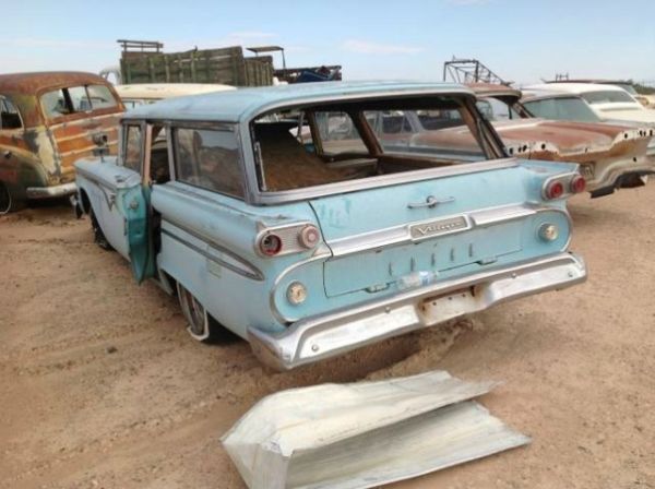

    Forgot to post this part --- was perusing Phoenix Craigslist and found the attached car for sale - NOT MINE. It's for sale at a local business in Phoenix.
    Wish I could get the curved chrome and Villager only "EDSEL" lettering off the gate!

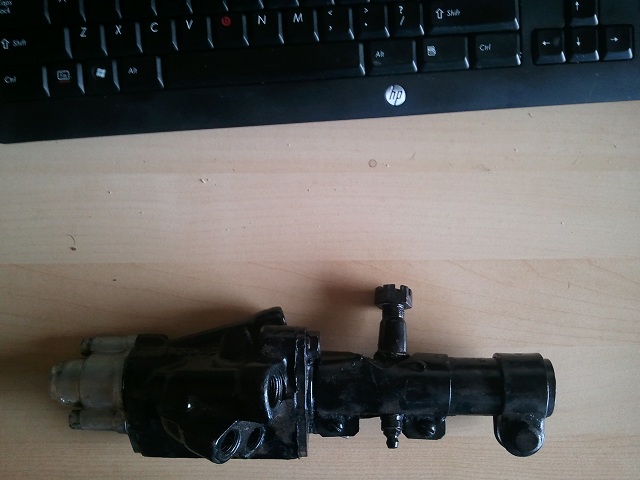

    The old control valve
