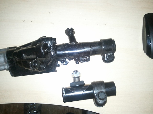

    Edsel.fi - I understand your concerns. And after driving it a bit after getting the adapter put on - I agree with you. Its safer than it was for sure - however - I think this solution would be ideal on something other than a wagon. However - I did get more familiar with the steering system on this car.

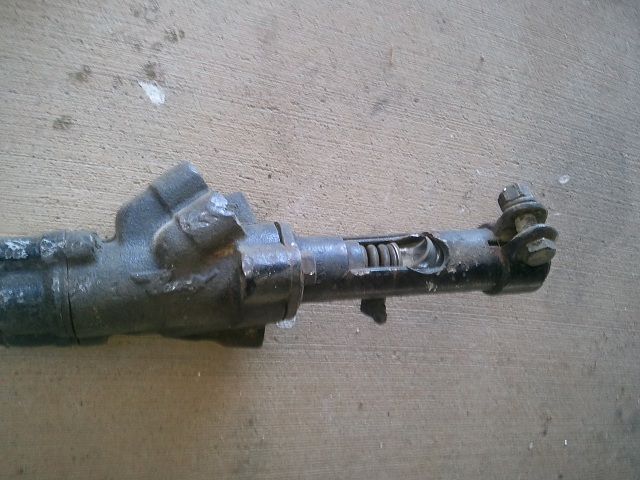

    While trying to get the control valve off - (by pounding on the stud through the Pittman arm - ) my hammer slipped - hit the control valve - and that, as they say, is that (see pic).
    You can see where the old ball stud was destroying the casing of the control arm just from driving. The fact that the whole thing came apart with one miss aimed whack of a hammer really points out how close this thing was to coming apart while driving. Lesson learned!
    I went to take off the control valve - and well - lets say that was an adventure. We may not have a lot of rust in this part of the country - but those control valves are THREADED on to the drag link. The water gets in there and it becomes a bit of a challenge!
    I then had to use some pretty powerful pliers to get the control valve off the drag link which s****ed the casing. I'm not too worried about the aesthetics of this unit as I have another. Between the two I should be able to make one.
    Also I snapped a pic of the ball stud still stuck to the Pittman arm. It came out after about 10 more sideways whacks.
    I was running late for a family dinner so did not manage to get a pic of the new adapter in place. But I did get to drive it down the street and back.

    The pics

    That looks to be Bendix unit, I found that Rare Parts in Stockton Ca has those, I worked on a 47 Caddy that someone put that into, and its a little tight, I got hose ends from NAPA had them install on one end of hose and then used a reusable fitting to finish the other end after in stalling.

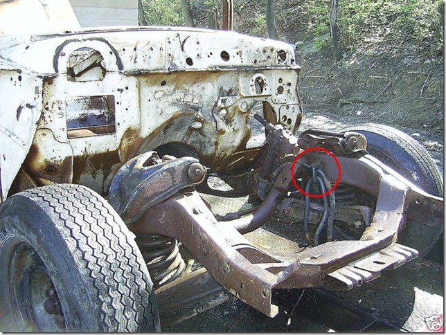

    here is picture of that used control valve, about 90 degree bent was in pressure side hose.
    Notice one control valve <> cylinder hose was replaced with solid steel hose !
    & weird coupling on return hose.

    & here is shown frame bracket for hoses:[​IMG]
