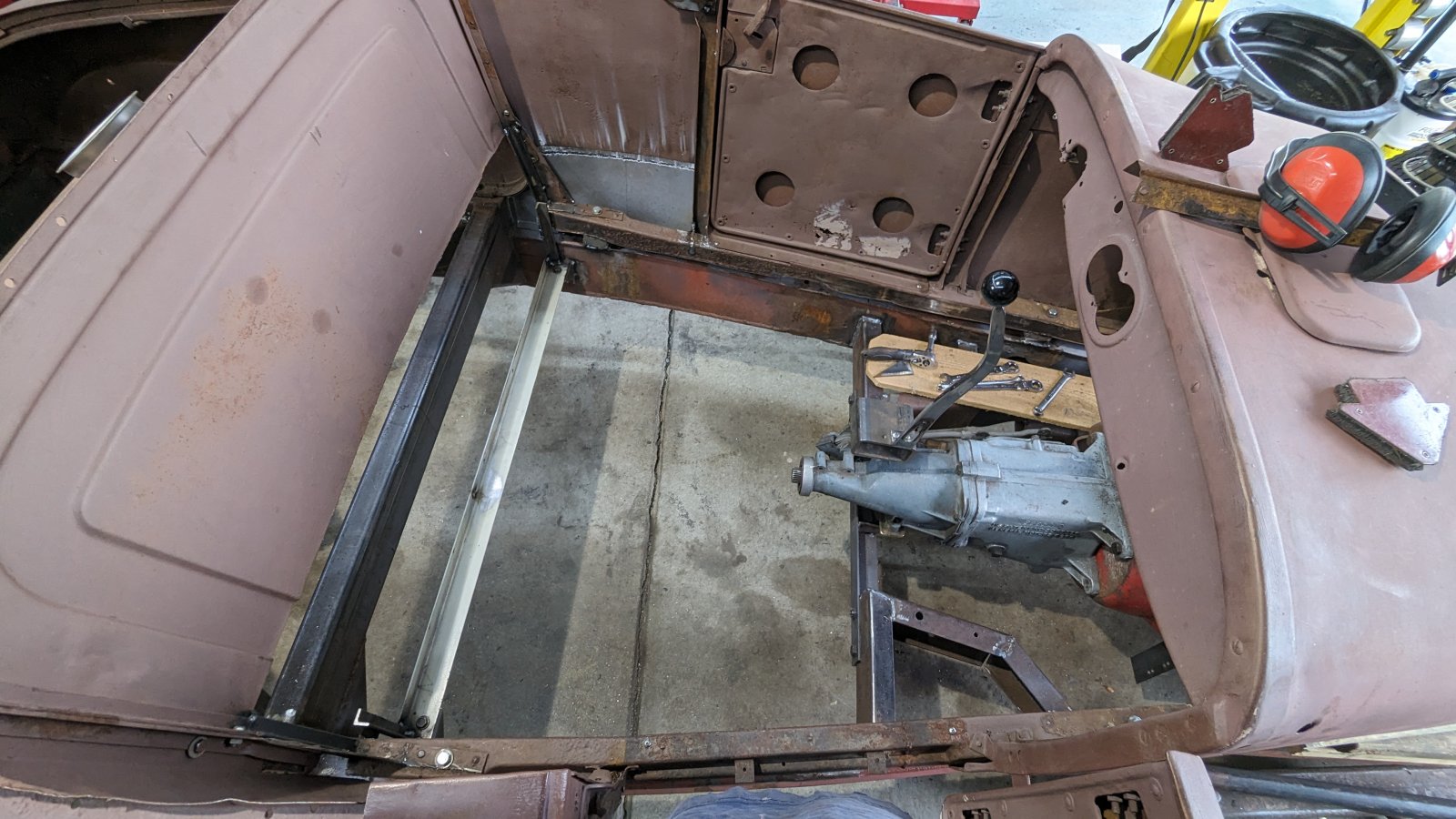

    I'd like to get your input on the frame I'm building. I'll outline my plan so far.
    I made the back half so that the turtle deck sits right on top. It's 2"x4" 10 gauge. I may have to c notch it a little and make a swoopy transition below it to the 32 frame ends
    I'm currently cutting up a model A frame for the inner X member I see on a lot of frames.
    I'm sure I'll have to clearance the front kickout for the pedals. I'm planning to put a mirror of it on the p***enger side.
    What are your thoughts? Am I going too far or not? Any alternatives you may have are always welcome. Thanks for your time.

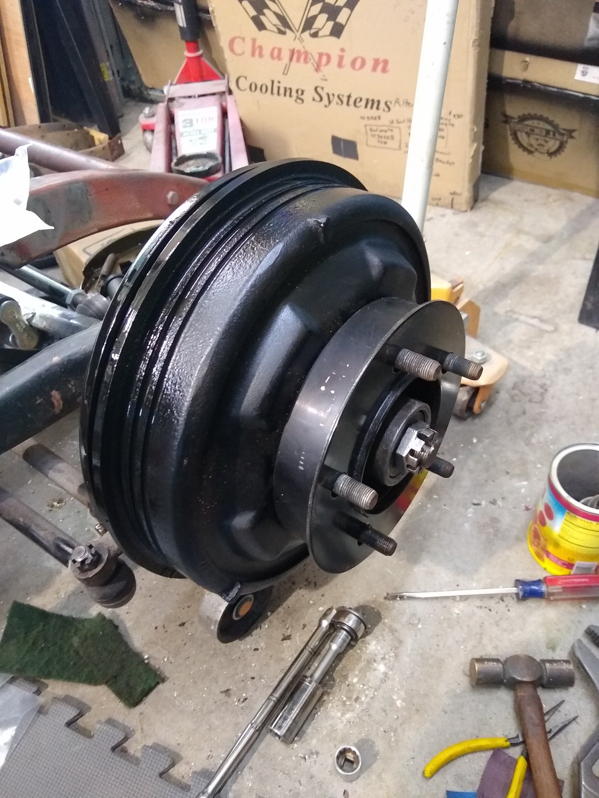

    F-1 brakes on the 48 axle fit like a glove. I did have to grind the inner bearing for the larger shoulder radii. IMG_20220911_160207456.jpg

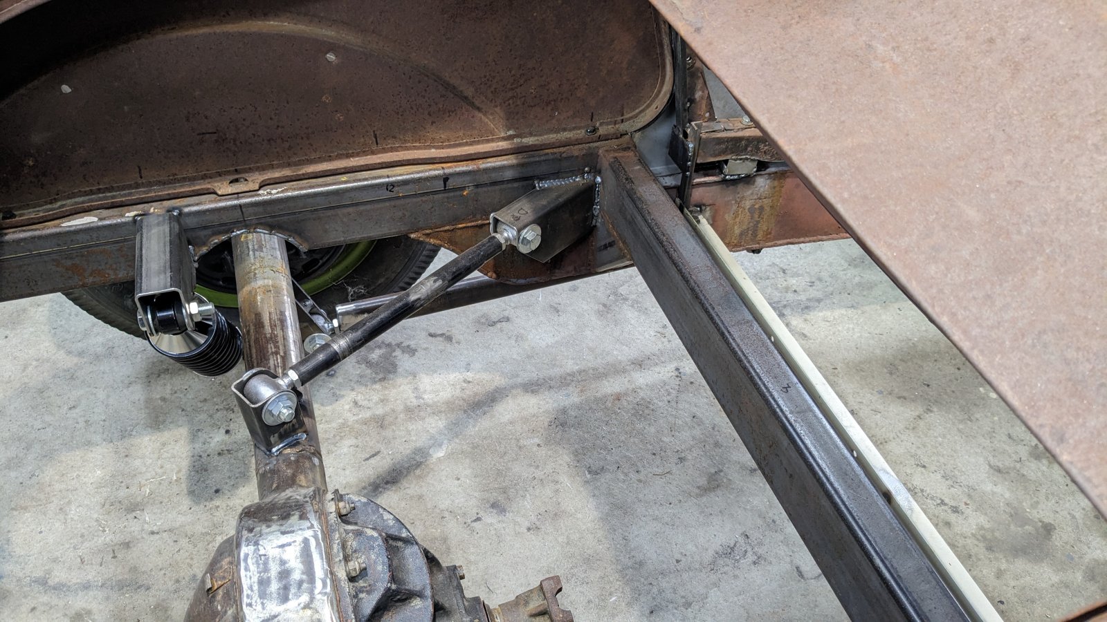

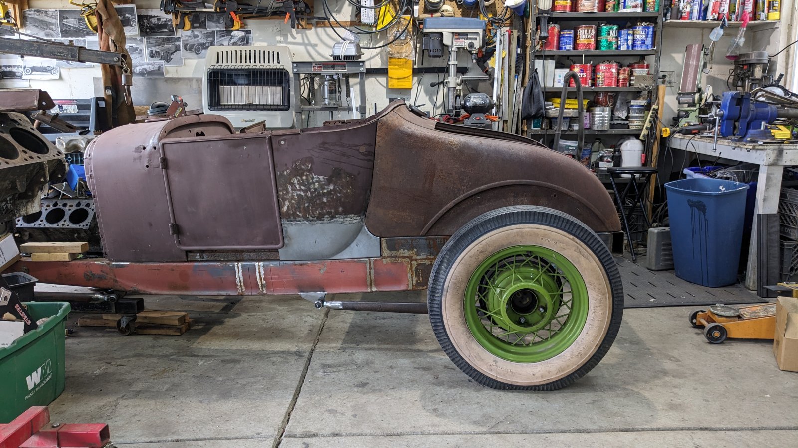

    But I'm back at it. Finished the rear suspension and got the body mounted, also patched the worst of the holes
