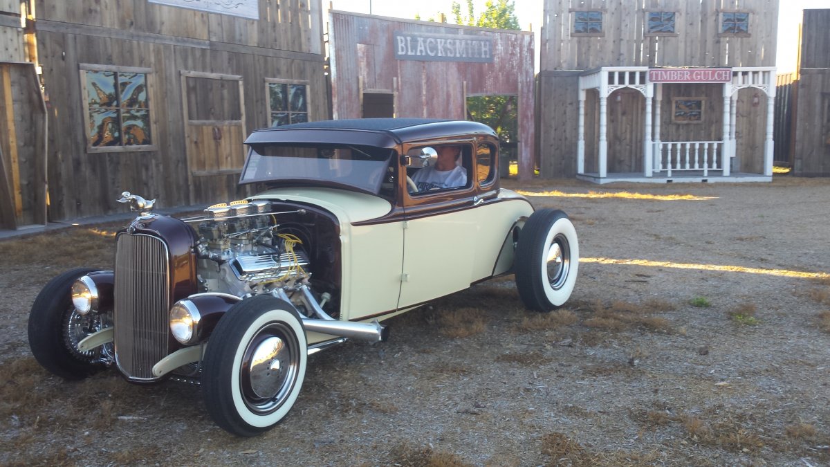

  11. 4" chop.
    6'5" and not skinny. Fit in it really well, but I did build it for me.....

    Trying to figure out your channel job. Is that channeled more in the back than it is in the front? Or is it just the angle of the photo/optical illusion?
    Looks a little tight headroom wise. How high up is your seat? Looks like its a bit forward as well. I had everybody telling me to put my seat all the way back to maximize leg room. I didn't like it. I didn't like my head being all the way back and looking out the side window and having to reach so far forward towards steering wheel. Its almost where stock position is. Removed original seat riser and made my own. Made it so that the back of the seat is more or less all the way down on floor and front riser is about 3 inches tall. I have plenty of room as it stands now with my feet although knee hits wheel a little when operating clutch. But I also have a gigantic 18" steering wheel that I'm going to have to replace. I'm in love with my wheel, I think its beautiful but its just too big. Knee hits it a little bit, and its too close to door and I tend to bust my knuckles on door sill. Need to find a cool 16" wheel somewhere.
  13. Yikes. 18" wheel is big for the little A. Only a subtle 1/2" channel 20160802_162940.jpg all round. Seats are 51'? Morris. All the way to the back and right on the floor. No sliders. Mounted the steering column accordingly.
    Yes. I do look out the side window. ...... it's a great view.
