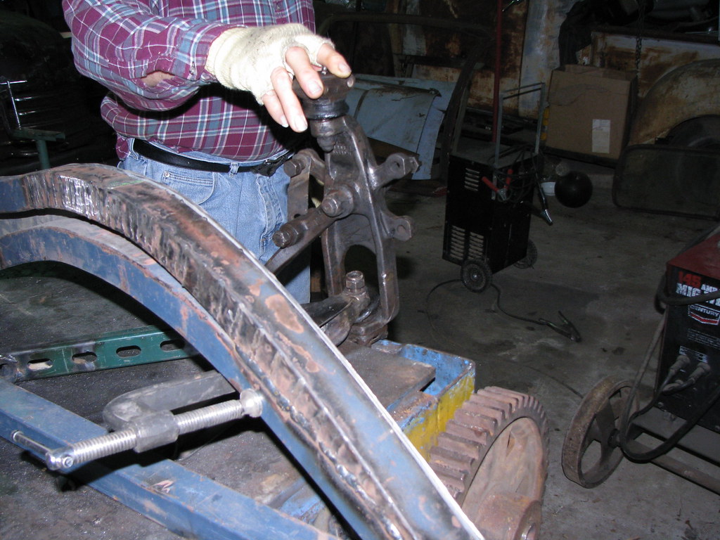

    Posts: 3,604
    Flipper

    from Peru, IL

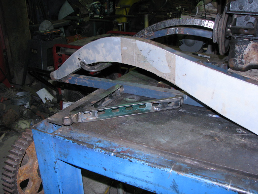

    I went and played some this weekend. Didn't get a whole lot done on Roofus ...just made another A-arm.

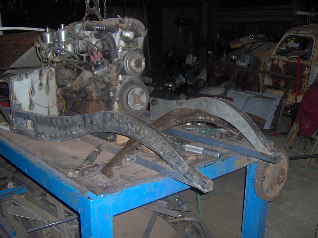

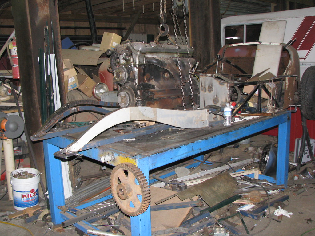

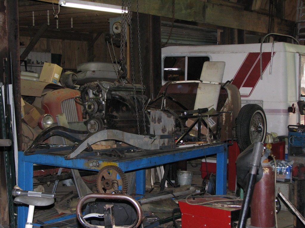

    Oh yeah, looks like I'm gonna have to deal with a cramped footwell.....moving the engine far enough forward to free up foot space puts the radiator too far forward for me visually.
    It's better to look good than to feel good...or whatever the Billy Crystal line was.

    The biggest issue is the way I plan on laying out my front end. I will have a 1934 ford leaf spring transversely above the front I-beam of my A-arm. The radiator will sit behind the spring.
    If I put the radiator above the spring. it would free up several inches.
    I guess I need to look at that next time I get a chance to play.

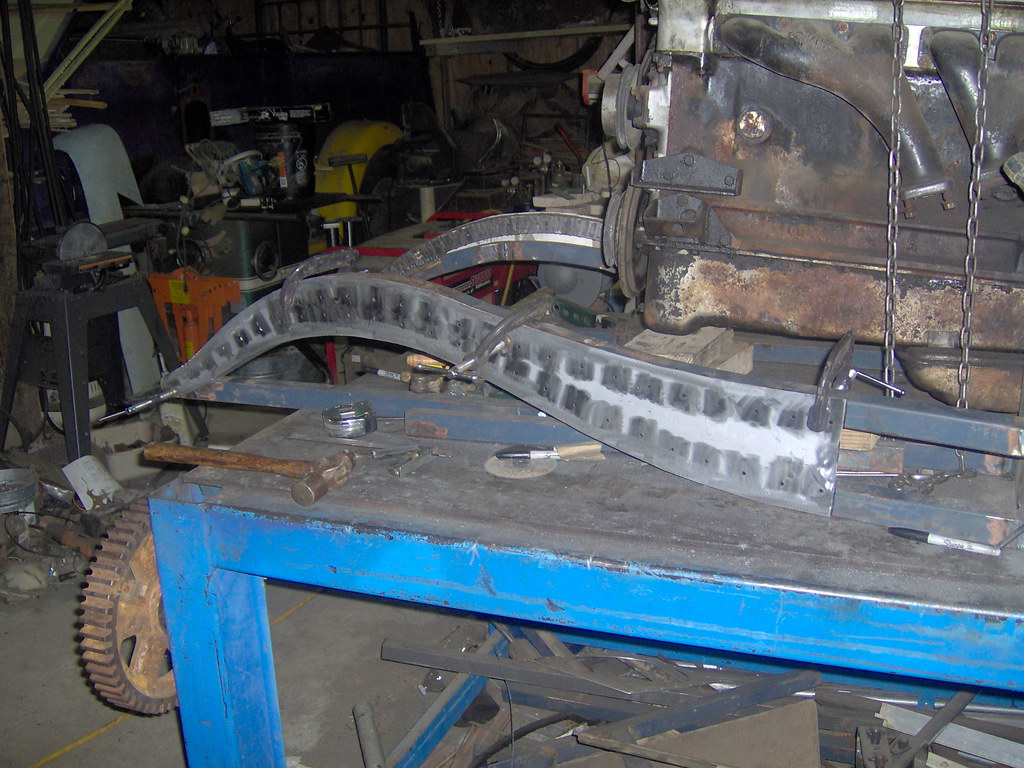

    Got another outer piece made for the p***enger side. Not 100% sure about just having the flat sides between the arch and the firewall. The 6.5" framerail height looks very truck-like. I'm thinking about bead-rolling something in the side or something.

    Actually started installing the boxing plates. I really want these things tied to the inner tubes. I am making plug welds to secure the plates near the inner horizontal edges of the tubes.

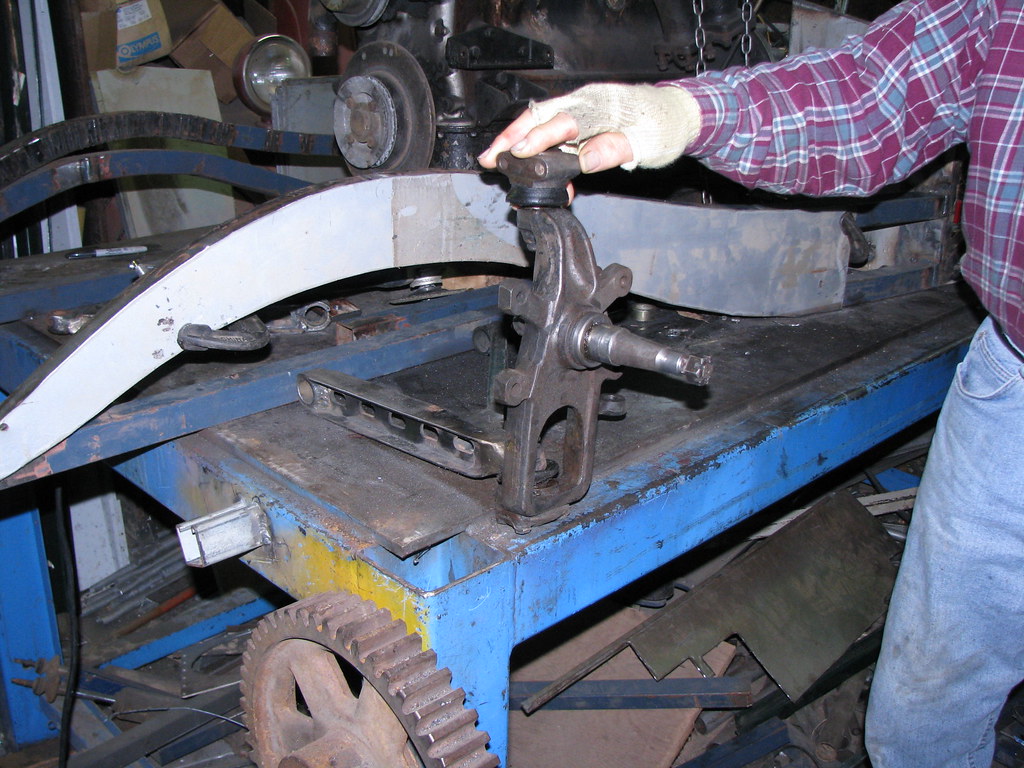

    I think the spring will be better for this application anyways. The wider spring will put the load out farther on the a-arms.
    Now I need to figure out what the crossmember needs to look like. Anybody have any guesses as to how much this spring will compress in this car? ...jag engine with a bunch of set-back vs. stock 40 ford ....I don't have a clue.
    Spring will be on top of the lower arms ...I couldn't mock that up.
