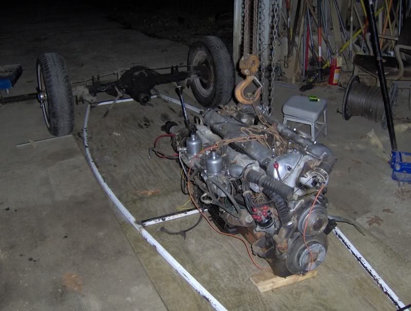

    More progress this weekend and more pics of stuff that I should have taken pics of anyways.

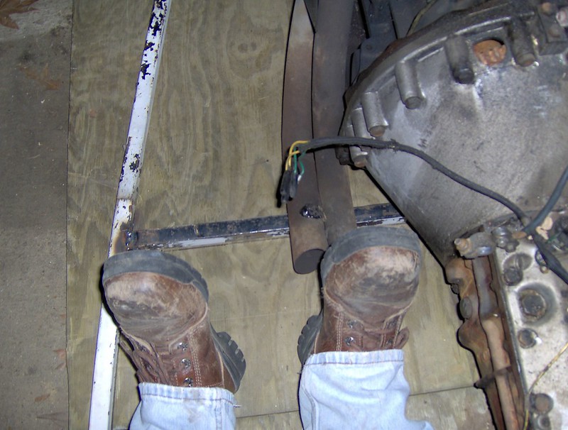

    I ditched the cut/bend/weld subrails that I made last time and cold bent new rails over a gear that was about a foot in diameter. Much nicer. I also mocked up some of the major pieces to see how seating room would work.
    The crossmember that runs under the belhousing is where the firewall will be.
    43 inches wide at the "firewall" is gonna be nice and roomy. No, that's not where the exhaust will run on the finished car.

    I wasn't real happy with the short driveshaft...and the shifter position,
    so I raided dad's parts stash and pulled out a 1959 XK 150 gear box :) Shifter moves back about a foot and driveshaft grows by about a foot too. Win/Win
    Here are pics of the current wheels :) They will probably get turned into larger diameter wheels.

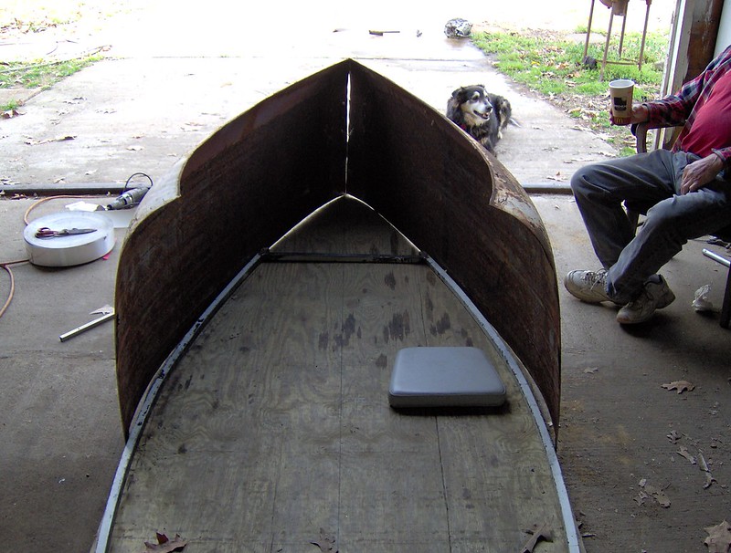

    Now for more of the Roofus part.
    Two sides, a little t*******, and some duct tape.
    hfh and kidcampbell71 like this.

    Since I first started playing with the the idea of building this car it has evolved into a slightly wider car than a real Miller Ford,but it is still going to very swoopy looking in my opinion. The current layout should allow for a decent seating position. Cutting the body where I did allows for more swoop in the door cutout area.
    The forward cut on the rear section gives a hint at the reclined seating position. With a little luck, it will work out so just my head is sticking up over the cowl.
    Also, the cowl section will be fabricated out of other pieces of metal so that they blend in with the hood better (kinda like the first cars pictured.

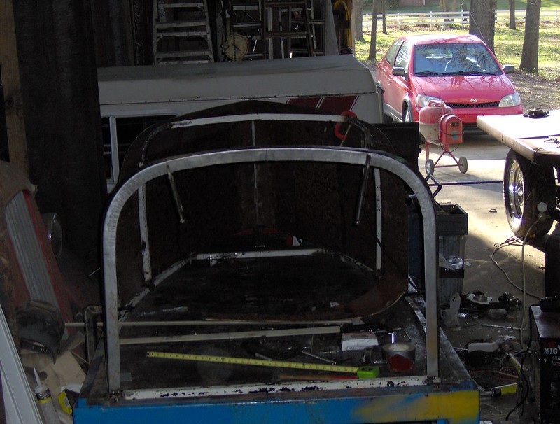

    I didn't get nearly as much done as I had hoped.
    The plywood sheet worked OK for mock-up, but it wasn't working well enough to build a real car.
    I have a work bench that is almost big enough to build on, but it is buried under 4 years of grinder dust and misc ac***ulations. Half a day was spent cleaning off the table.
    Finally got the table cleared an my subrails on the table. Table is about two feet too short for the body to fit. No problem. I built an outrigger to support the point of the boat tail.
    Time to start building body structure out of 1x1. Square tubing may be great for building boxes, but it ****s for the complex shapes in this car. Got one hoop done in the rear body and tried to make a hoop for the cowl. Succeded in making lots of s**** out of 1x1 :). On to plan B.
    Make the cowl from 16 gauge flat sheet. This was my first real project with the horrible freight shrinker/stretcher. I think it went well. I think it would have been easier if I made my angle 1x1 instead of 1.5x1.5 (oh well).
    Here are the pics.

    I forgot to mention why the rear hoop is so far back. .....I think I cut the door opening too far forward. :confused:
    I will wait until I get a little farther along before I finish out the door opening and seat area.
    As it is now, it is a tight fit when you imagine pedals and a steering wheel. The current hoop allows the seat to come back 6 inches.
