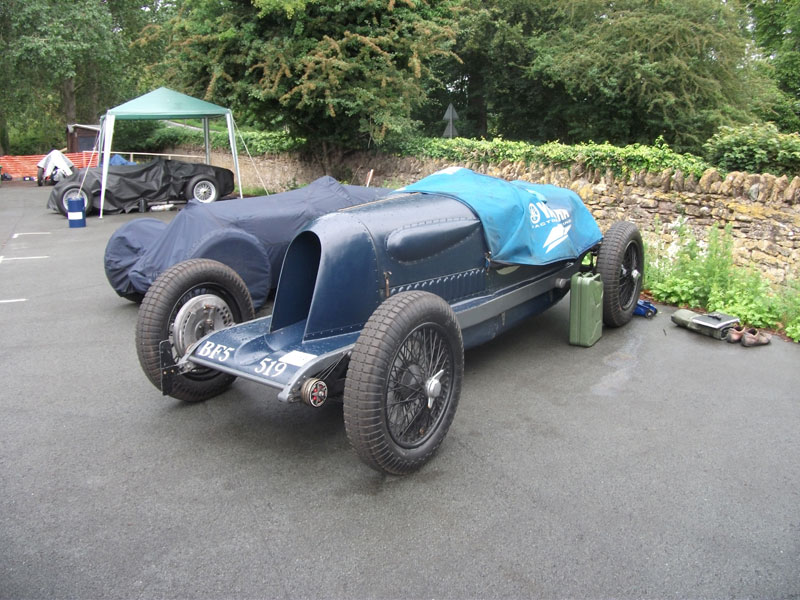

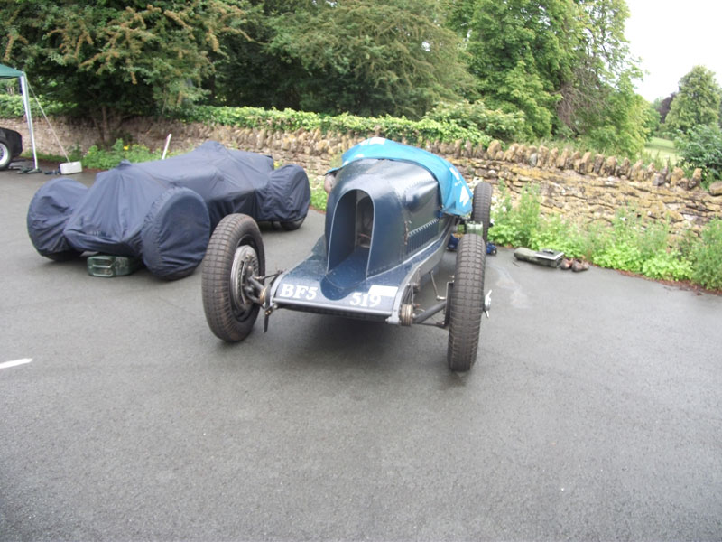

    Looking good Flipper! Nose reminded me on a car i saw at a Hillclimb race in England last summer.
    Here it is:
    Mario
    kidcampbell71 likes this.
